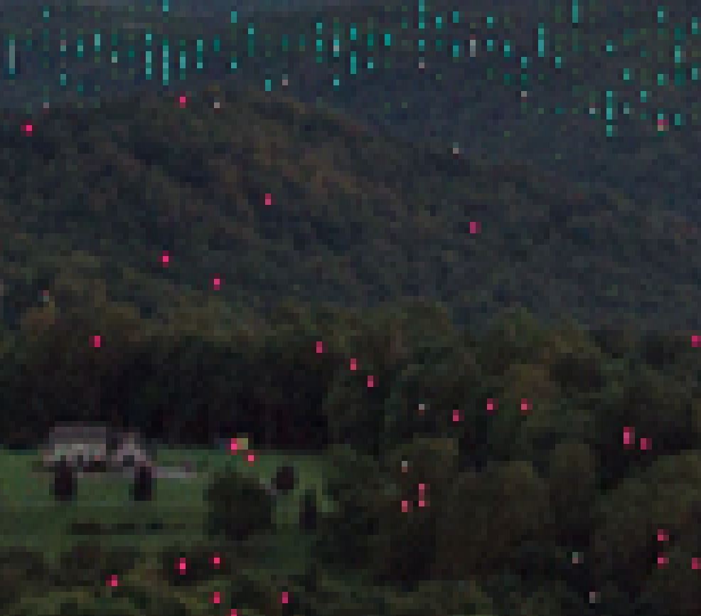

This is coming off the SD card, and my point is to get people to get off the overexposure warning, so I'm pointing at the weird dots usually red and white.
The lines the show from the SD card footage should not be there it should be simply over exposed.

This is what Mr. WVR's looks like magnified.
I agree, that is not a overexposure warning.
My links, I'm stating that it is a camera or cabling issue.
Its not the, turn of the overexposure warning, if you don't like it.
It needs to noticed as a problem and how to fix it.
I guess I'm trying to clarify this deference.
To make us all better! ;) ;)

Honestly the drones dead pixel problem kind of looks like focus peaking overlays, but they aren't. Just think it's funny how similar the problem looks to focus peaking
Are you saying that the dots (red and white) speckles are dead pixels?
They do seem to always be in the same area, maybe not.
