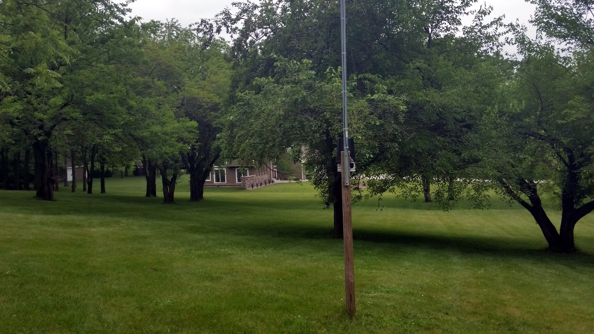

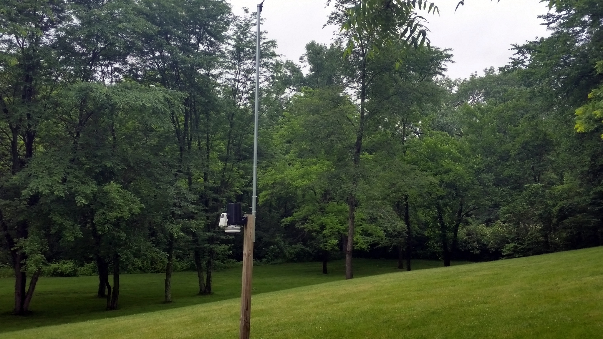

I have mine on a 8' 4x4 treated post. I have a 1 1/4" piece of conduit strapped to that for the anemometer. The post is 2' in the ground in concrete and the conduit is 9' above post. So total height of structure is 15'. For my location that is about the minimum. I really don't get the most accurate wind reading even with that.

I guess this applies in a "Perfect World", but we do what we can.
Just went out and snapped a couple shots.
You can also see distance from house/console on one shot.
This works well for me except anemometer could have been higher.

An anemometer should be 10 metres high to get accurate wind readings, met office recommendations;)
Must be positioned away from tress, buildings to stop wind turbulence.
Yeah that's in an ideal world... But you've gotta make do with what & where you can;)
Must remember the Davis Vue is one unit, anemometer/rain bucket/temp sensor soooooo you would need to get a happy medium.
With my setup I do have the option to adjust the height of the windy thing (anemometer) but you can't with the Vue.
Just place it in your field, get the best spot away from trees & put it at what height you thinks best;)
