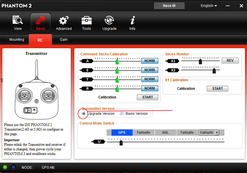

After an upgrade of the controller, the red light has gone to green and it starts with 3 quick bleeps.
Reading about it seems the wrong firmware has been loaded.

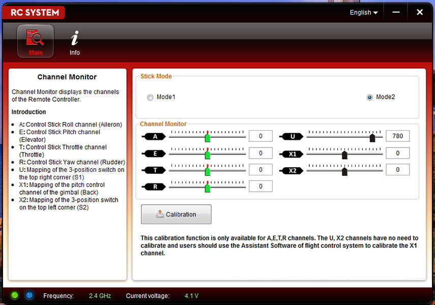

Everything works expect the X1 channel for the gimbal. The X1 works in the RC and the P2 software only not on the bird.
I think a refresh of the old firmware might do the trick, I read one post where someone with same problem was asked by Dji to send theirs back. Thats going be a long wait.
Does anyone know a way to refresh the controller. It's a DJ6, the one with the gimbal lever on the back.....
Thanks....

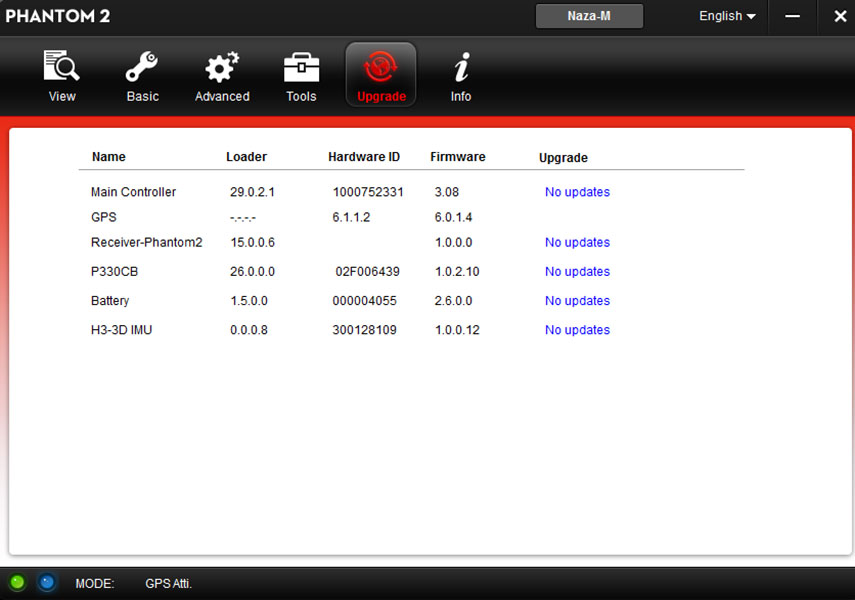

There is only one RC firmware v1.2 available for either PC or Mac. What OS are you using?? Also what gimbal are you using??

Hi Jason,
I am using OSX 10.11.5 (the latest)
It's a zenmuse Hd-3D gimbal.
I my firmware is 1.02.26, there was a lower version, 1.xx..14 I believe.
I think the version 1.2 you are referring to is the software version of the RC System software, not the firmware version which the software loads into the controller.

Thanks man, I've been flying this thing for about 2 years, and solved many small hardware and firmware bugs already...Still no closer to getting the gimbal responding to the X1 channel...All other channels are working fine. The X1 also calibrates fine in both the RC and P2 software as well as the non software method of calibration....
I have this problem myself I have the old style remote not the upgraded version I flashed it to the latest firmware a month ago. Then I mounted a lever for the potentiometer and it did calibrate and work in the RC Assistant but it didn't work in Phantom Asistant only if I switched to upgraded model in the Remote section. Why is this happening ?
I have no idea man....I have another thread on this here with more reasons to keep scratching your head. Dji team,do you offer technical help or only repeat from the manuals
Update your gimbal firmware....mine has just started to work after doing this.
