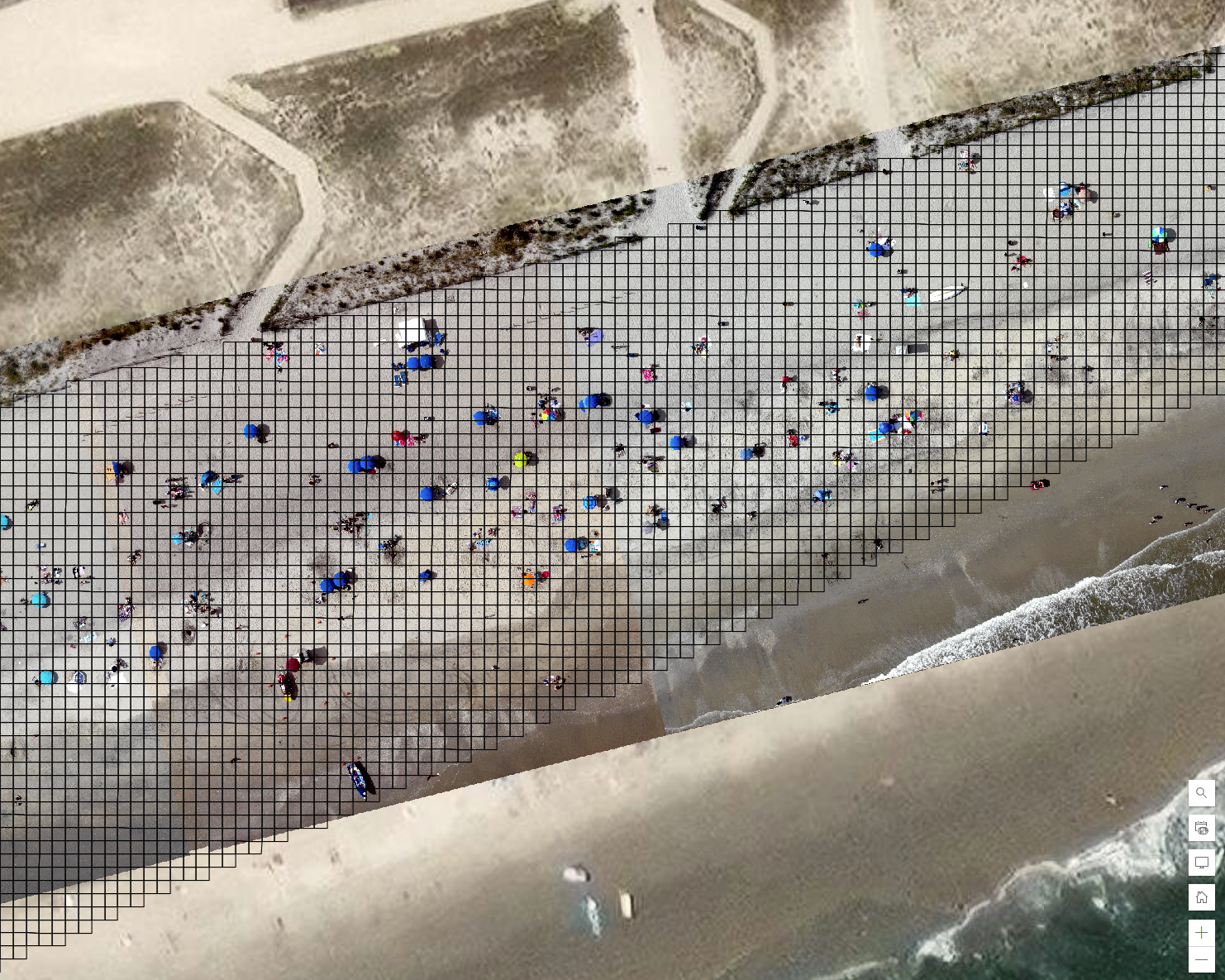

You can take a single image and then rectify it in Arc Pro. You would use control points that you can find in both the image and in the accurate survey you already have.
I did this to look at social distancing during Covid on our beaches. It will meet your goal of not accurate or precise, but after rectification will be georeferenced.
Below are simply images taken with a Mavic 2 Dual that were rectified and georeferenced so that they can now work with Arc GIS. A 6ft x 6ft grid was then overlaid to show how far apart people were staying on beach during the height of Covid.
There are also raster tools available that could let you merge the two rasters, but I have never done it with orthophoto rasters.
