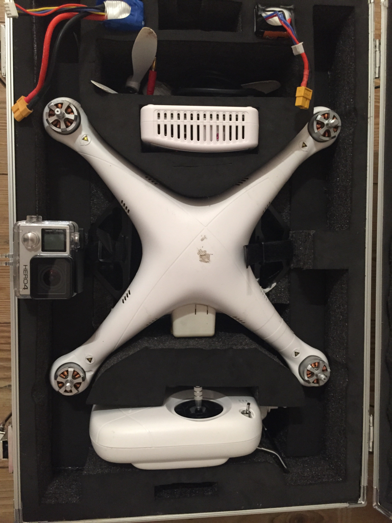

Haha I feel your worries Wayne! So I'm guessing in my situation that I have purchased a Phantom FC40 and received a Phantom 1 with an FC40 camera! Surely I should receive some compensation from the seller! What do you think? after all if I had decided to use the FC40 camera I would have almost definitely lost signal at some point.. which would have sucked!

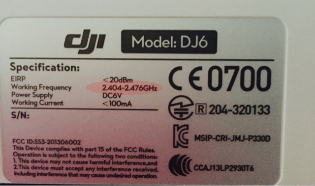

Look on the back of your controller there is a sticker on the back it will tell you your frequency range, let me know what that is.
You have a 2.4 ghz radio. A 5.8 ghz fpv will work great. You just can't use the same frequency.

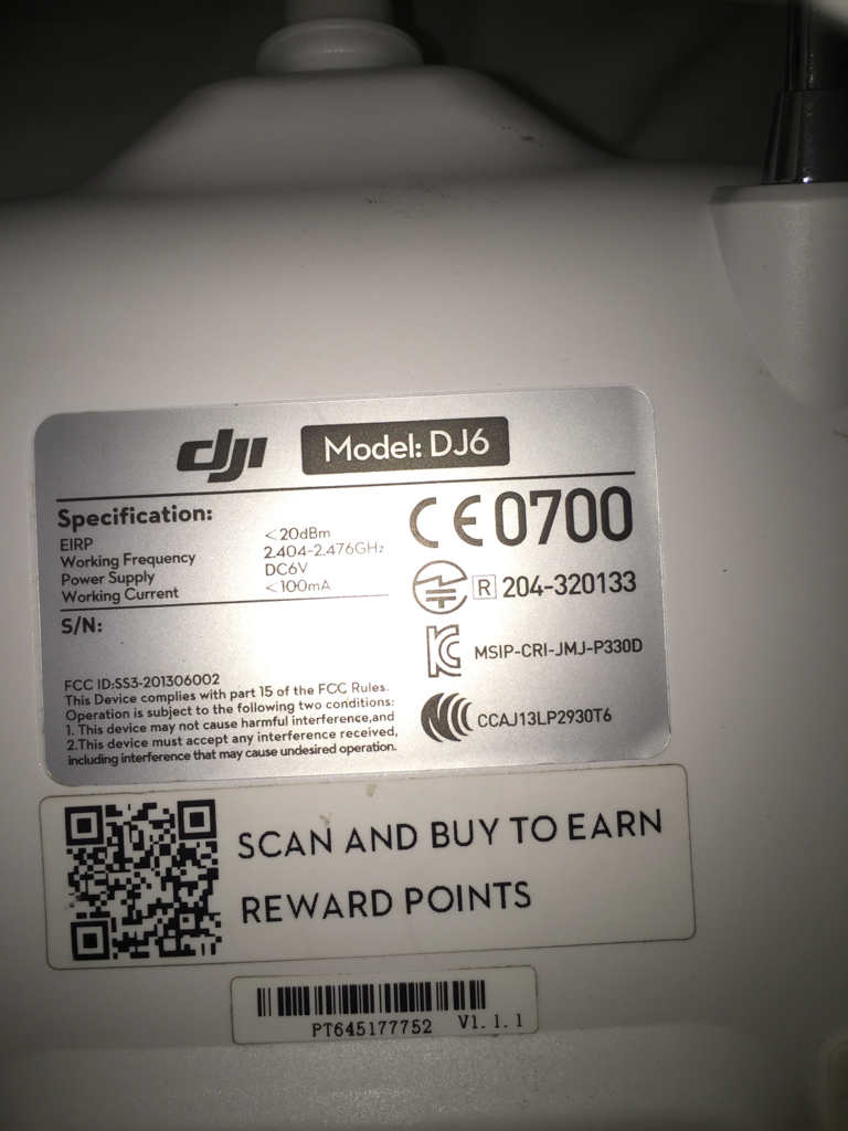

What frequency is your controller? Check the back of it theres a silver sticker with the frequency on it.
I did, it says 2.4.
