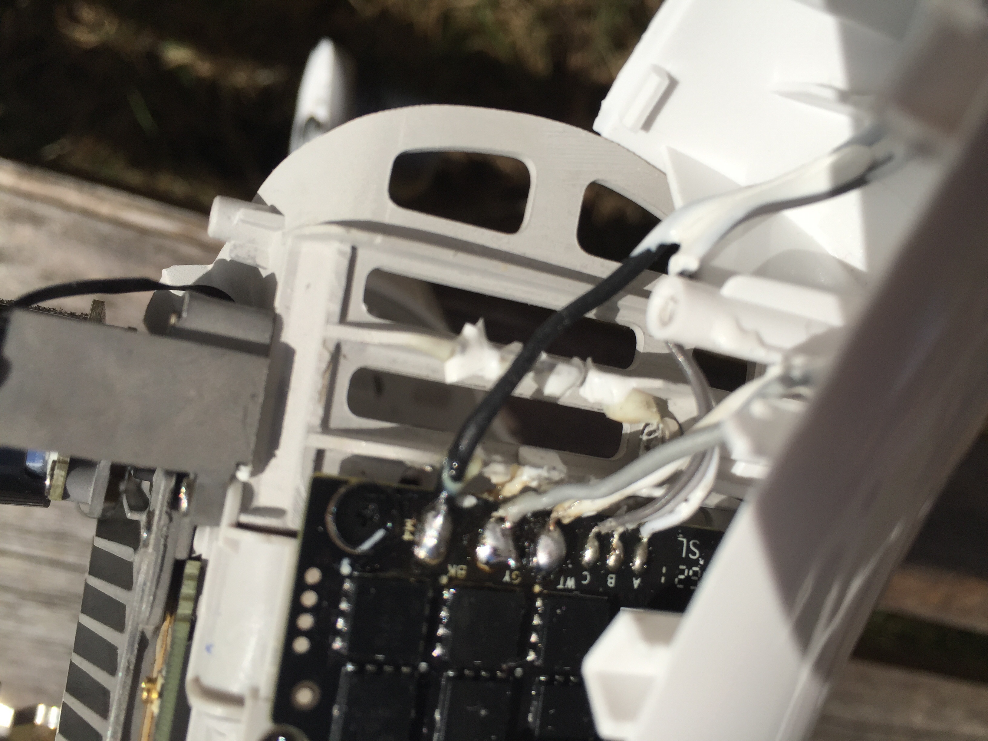

Hi texs no err on GPS.
ESC errs on 1 2 3 & 4 from hand held.
Bird has 3 red lights on with no 4 bleeping as b4.
Don’t understand it, no4 has new motor and resoldered?
What ya fink ESC borad?
Going to fit another new motor on no4 see what happens?
