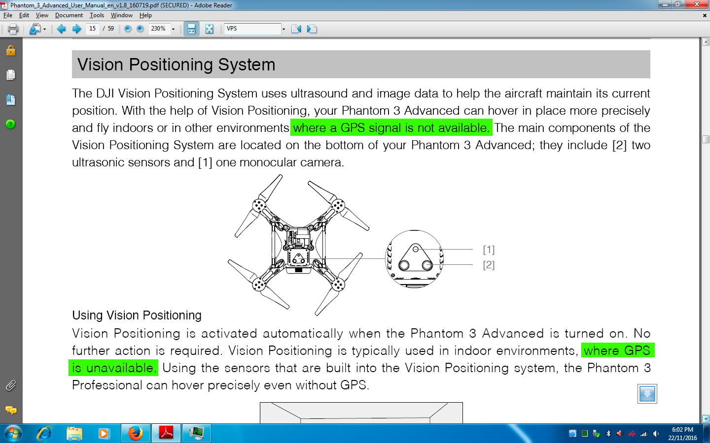

Let me answer you:
First of all DJI has not specified any where that GPS takes over control if GPS lock is achieved for maintaining position.
GPS help maintain horizontal position like that's done by the camera of VPS.
On low flying, VPS ultra sound system can very accurately determine the height above ground for even and non reflecting surfaces this is the best way to stabilize heights above ground. You may notice AC following the contours of the ground for low heights. Check what happens if it sees a table for example beneath in a room.
Camera of VPS system takes ground images and uses it to control movements by comparing images. Accuracy of control definitely depends on the pattern on the ground as seen by the camera. A ground with a smooth painted surface will make images similar and it will be difficult for VPS to stabile its horizontal position. A check design on ground could be better than a well cut lawn for the obvious reasons. Similarly as you move the aircraft up, pattern seen by the camera becomes smaller and thus loses accuracy and thus has limitations.
Hope this will give you clarifications to what you observed in your videos.

i read it on the manual book sir... that's what i understand.
