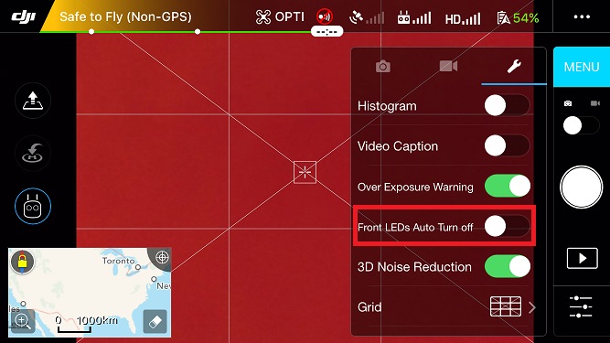

    Hello,
    I have searched through the menus, but can't seem to find. Where is the new setting to turn the lights off when recording?
    I have found a setting to turn the lights off 100%, but I thought the new firmware has the function to automatically turn them off when your recording or taking a photo?
    Would any one be kind to direct me to where this is?

    It's in the "Menu" in DJI GO. You will only see that setting while DJI GO is connected to your Phantom.

    Thanks man, I was looking in the main aircraft menus.

    You can also set your C1 or C2 button to turn the front LEDS off and on to save going into settings as your flying. Can turn them off to take photo or video then turn them back on at the touch of a button without taking your eyes off the screen.

    Isn't there a setting that will turn the lights off automatically when you take a pic? No need to use the C1 or C2 buttons.

    Hmmm... second post in this thread showed us the setting? I think he was just responding that there is also another function to turn them off manually with out having to go through different menus.

    It's not really a battery saving thing.
    The lights only really need to be turned off when shooting in the dark. That;s why they added "Turn off when shooting".. It is much more convenient than going through menus every time you want to take a shot in the dark.
    The lights are prone to casting reflections on the camera lens. See the attached image.
