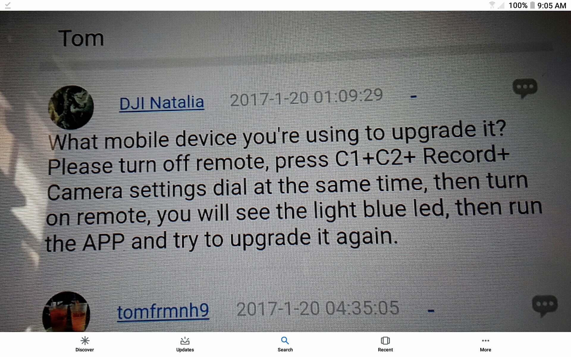

I always did mine with OTG cable adapter from device into drone,,I do this with p3s , p4s and p34k before I give it away,,always worked,,no nothing of other way so this how I've been doing it over the years,,I did p4s 2 days ago like this and works every time,thankfully,,,you could try this from dji susan...this for p34k,,,,
P3 4k haven't this button :(

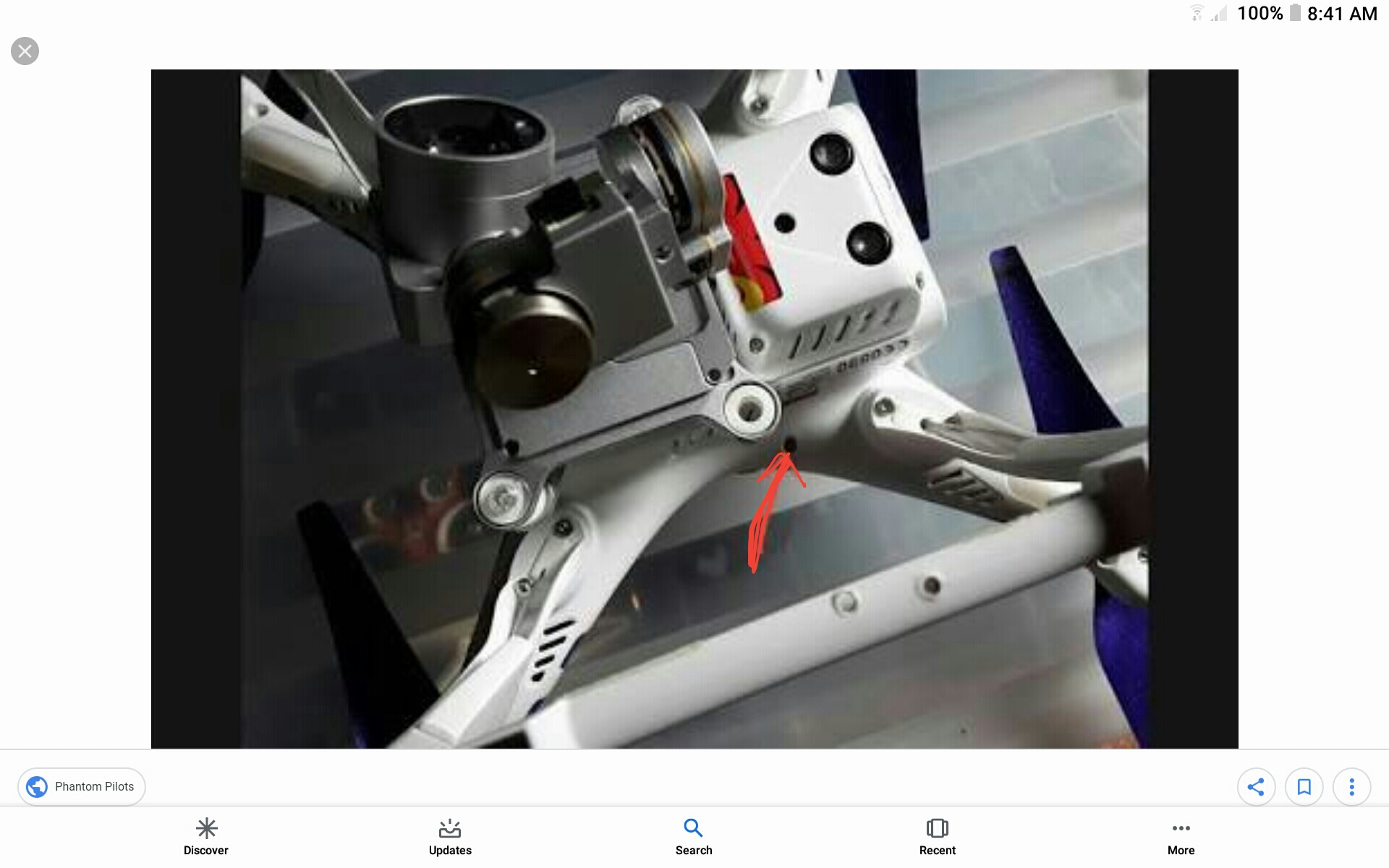

Where's you link button located is it underneath bottom shell,,post a picture of vps unit and bottom of drone so we can locate for you,,I don't have my p43k no more so can't look at it
Me find picture of my p34k with link button location,,,,unsure why in vid his link button on vps module
