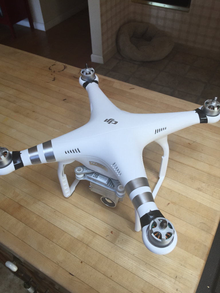

Glued hair line cracks and guerrilla taped arms. Seems secured

A lot less flex in the arms with the tape? I'll probably go this route when my new unit comes. I believe gorilla tape also comes in white.
SEEMS secured, didn't say it was...this is just an added band aid... OR...more likely...Phantom OCD
It's giving me a piece of mind-only time will tell and by then (hopefully) DJI OR a third party will have designed a stronger...lighter...shell.

I added small zip ties to the areas you put tape on in your pics. No more flex at all. The arms are super solid now.
Good fix for those who do t want to glue the shells together.
This completely eliminated the flex in the arms that caused the cracking. Hope this helps some people.
