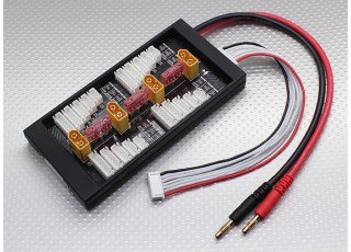

Think about your 2 cell charging setup. Was it only the balance leads connected? I suspect you also had the main battery power leads going to the charger also. I charge up to 6 5Ah 6cell packs on occasion. All balance leads and main power connections from packs are parallel connected to the charger.
This is how multi charing power boards are wired...
The cells (in each pack) are series connected to the charger- FACT....
Two channel, not 2 cell.

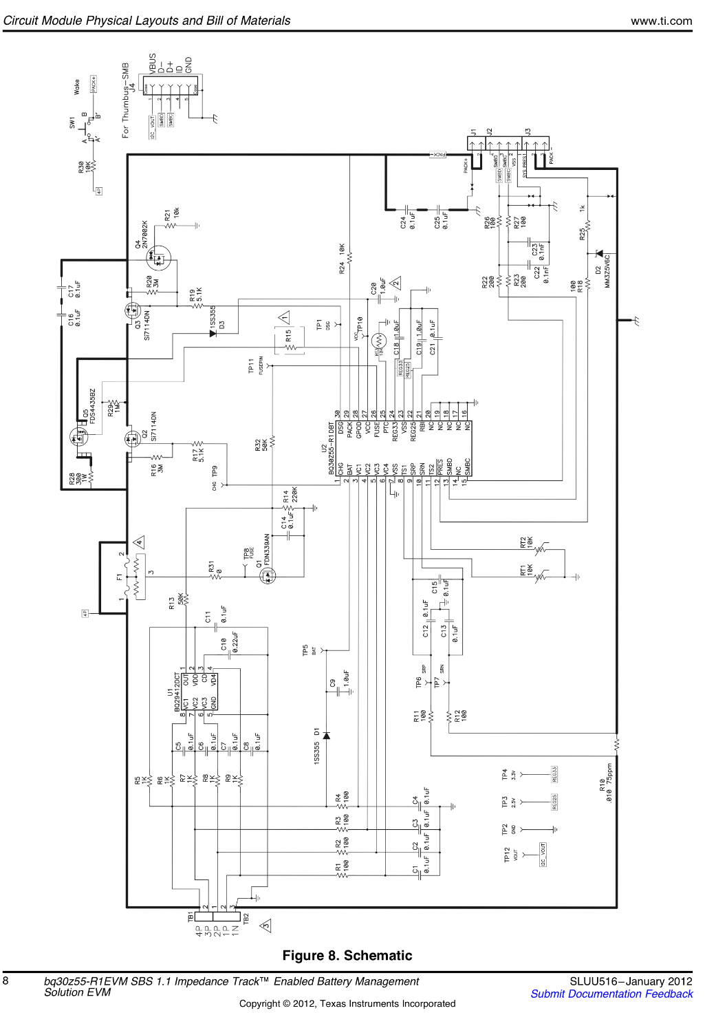

The charge circuit is in the battery, have you wondered why it needs 17.4VDC on the input to charge a 4cell series LiPO pack? Simple because the cells are charged in series. There is no mystery as to how cell balance is achieved. Bleed resistors on the cell taps (R1-R4) are switched in on the highest voltage cells.
I am sorry to disabuse you of your notion however fact is the car charger adapter also supplies 17.4V to the pack, it uses a simple switch mode inverted to increase the voltage.
This circuit is for P4 intelligent battery, correct?
I need a similar schematic diagram for P3 intelligent battery...
