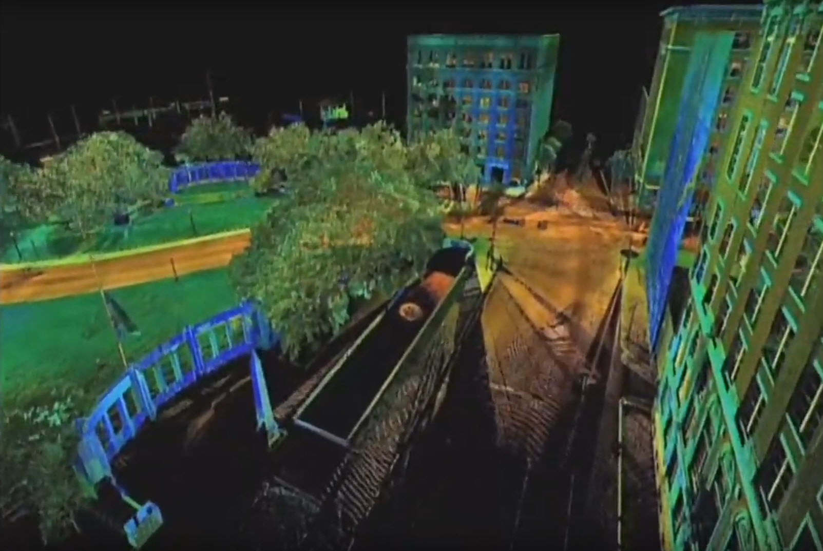

Yes, the project is funded. I have to tell you that this is a one-person Not-for-Profit. What we have been offering to companies is a mix of cash, pro-bono and bragging rights.
The point cloud files obtained in 2013 were donated to my project (only condition: cannot be used for commercial gain). They are here:
Files Donated by the Producers of the PBS Program
This is some of what we have extracted from them.
Rendering of the TSBD Building

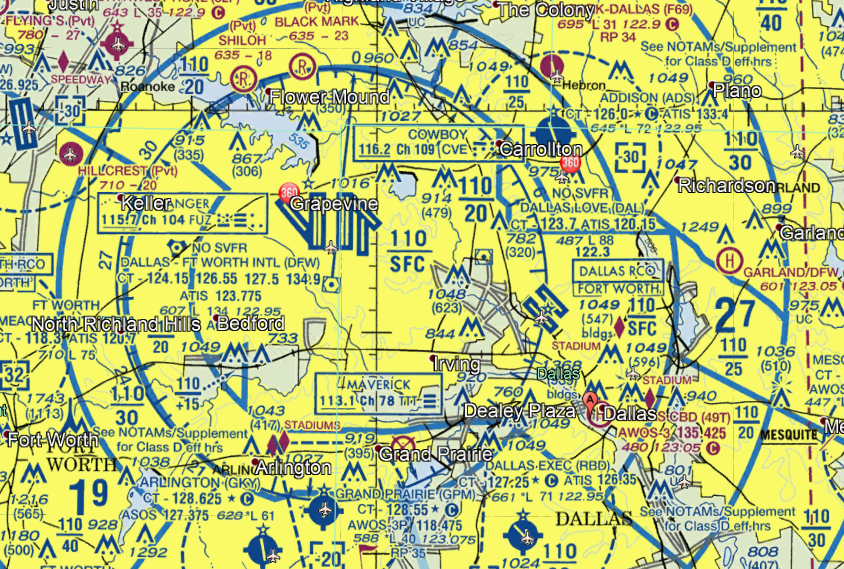

As long as the building isn’t in controlled airspace, you should be fine. Check the location on a sectional chart (I use vfrmap.com but there are many others). If you are within controlled airspace around of airport, you can get permission using an FAA website, but your pilot has to have a 107. Calling the tower may work(not recommended) but if you’re going to go that route, please have an av radio and a visual observer.
As long as the building isn’t in controlled airspace, you should be fine. Check the location on a sectional chart (I use vfrmap.com but there are many others). If you are within controlled airspace around of airport, you can get permission using an FAA website, but your pilot has to have a 107. Calling the tower may work (not recommended) but if you’re going to go that route, please have an av radio and a visual observer.
Thanks so much. More questions: What is a "107"? A vendor just mentioned that.
Even in case that FAA permission is unnecessary (Love Field is not very close to Dealey Plaza), will we need city and/or county permits?
I guess I need a tutorial on how to interpret the charts found at vfrmap.com. I am guessing that the controlled airspace is displayed in yellow?
TIA
-Ramon
JFK Numbers
A 107 is for all intents and purposes a drone pilot license. They’re required to fly in restricted air space. On the sectional chart, you can identify areas around an airport that are restricted by looking for blue or crimson “circles” (sometimes not). Solid blue circle = Class B inside. Solid crimson circle is Class C. Dashed blue = Class D and Dashed Crimson is Class E. I can look it up for you if you want to drop a lat/long on me.
Reactions: Nightwolf

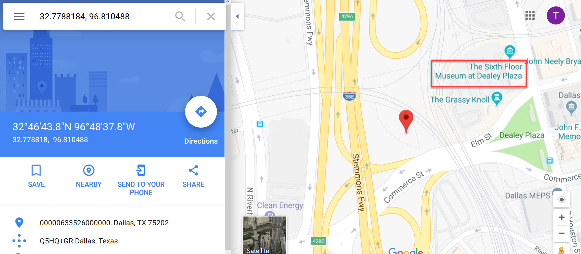

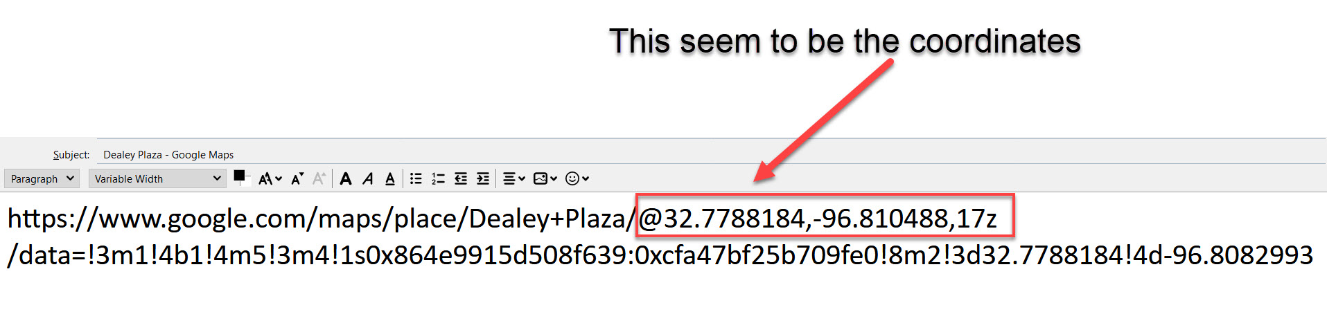

The location is "Dealey Plaza, Dallas, Texas". I typed that in Google Maps and got this URL:
https://www.google.com/maps/place/D...a47bf25b709fe0!8m2!3d32.7788184!4d-96.8082993
Is there a betterr way to determine lat/long? I seem to recall that with Google Earth it is easy to do it.
Thanks again,
-Ramon

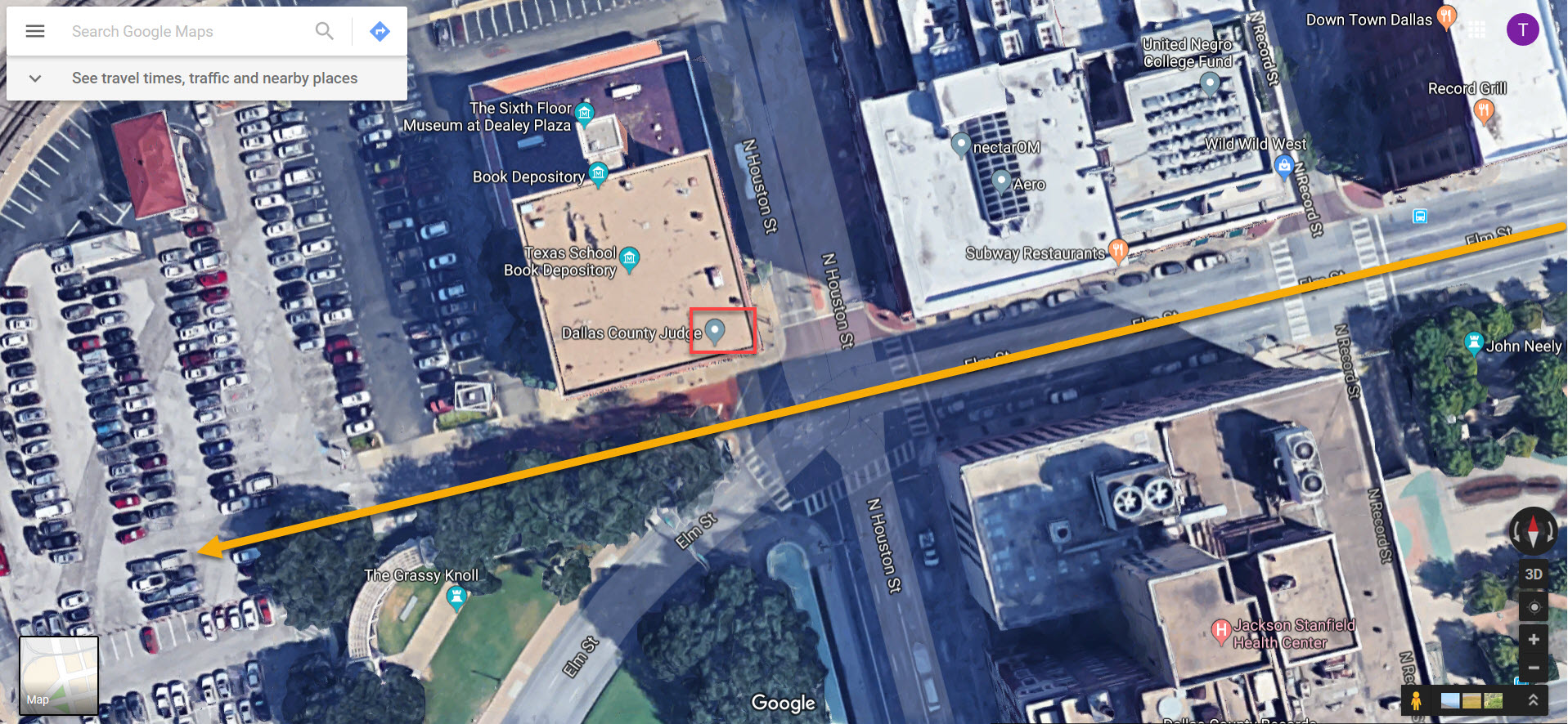

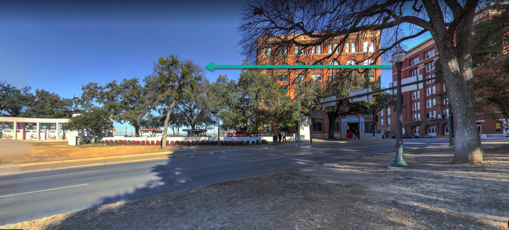

I was told by the Sixth Floor Museum, the location where president Kennedy was murdered in 1963 that they will not allow me to bring a Leica P40 Laser Scanner to the corner where the shooter was located.
See here what they have done in other projects:
Shooter is Outside the Building

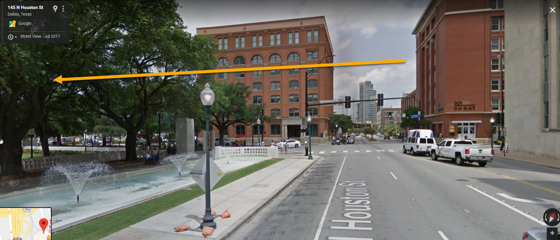

I contacted a drone operator in Dallas (SkyLVL). They have the most advanced, airborne LiDAR. Ideally, I would like the fly path to go above the middle of Elm Street, at the height of the 6th. Floor:
Does that seem like a doable, prudent course?

Altitude is limited to 400ft AGL so height is not the issue when compared to a 6th floor. The operator will likely have to obtain permissions and/or waivers to operate in the area and with persons present.
Reactions: BigAl07
Seems to me that SkyLVL would be the ones to tell you if they have the proper FAA waivers and if they can take on the project. They as the drone operator would be the ones held responsible if they did anything illegal.
Reactions: BigAl07

Dealy Plaza is well into Dallas Ft. Worth (DFW) Class B airspace starting at the surface. You need to find a professional (FAA 107) UAS pilot to explain all this to you. I assumed SkyLvl explained all this?

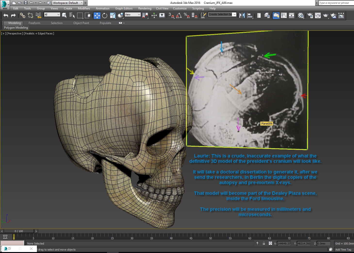

The following is a follow-up project. After the most accurate 3D model of Dealey Plaza in history is done (Architecture Component), the next step will be the Medical Component. Illustrated below.
These two X-Rays:
[Pending]
Will converted to something like this.
Except that the work will take about 2-3 years, being the subject of a doctoral dissertation by these folks in Berlin:
3D Reconstruction of Anatomical Structures from 2D X-ray Images
