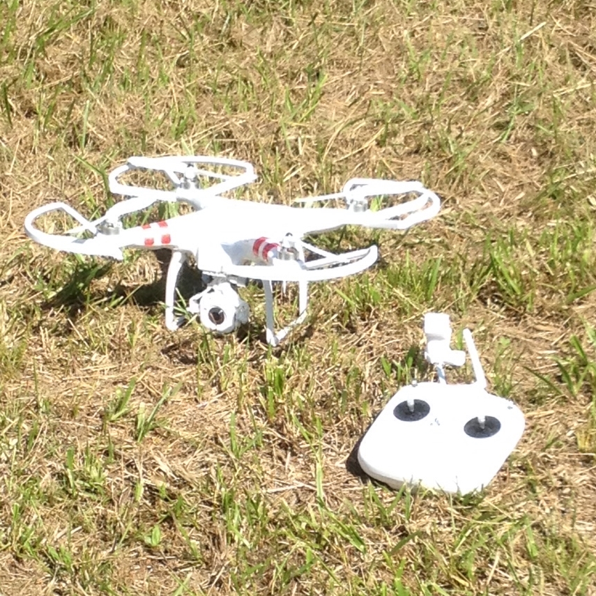

Like on a P2V or P2V+ . Is for the 2.4 to be amplified for lack of the wrong term .oh..ok . What did he mean by extender? Antenna?
That's what I was thinking but not sure if that's what he meant.Like on a P2V or P2V+ . Is for the 2.4 to be amplified for lack of the wrong term .
Why I showed the picture of mine , just had a moment .That's what I was thinking but not sure if that's what he meant.
Sure do. Still have my 3 Phantoms and fly them. Too fun.Why I showed the picture of mine , just had a moment .
You remember your first don't you![]()

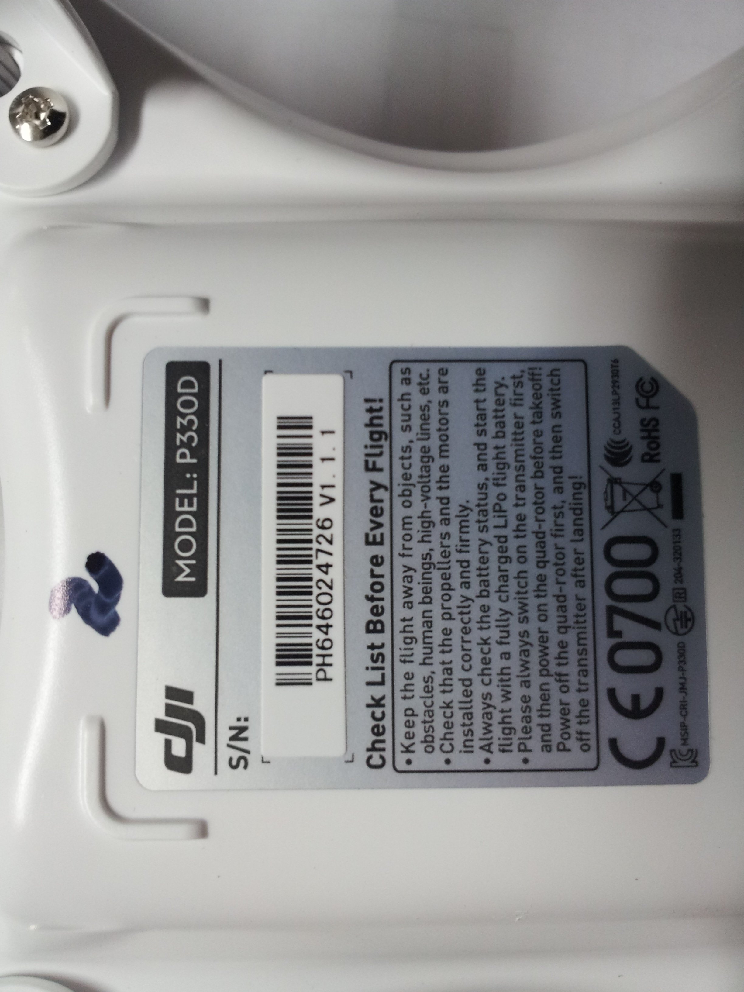

Yes it has the silver sticker but no freq.No silver sticker on bottom of the Phantom?
Can you post a picture of the sticker?Yes it has the silver sticker but no freq.
I tried with my iPad but couldn't figure it out,, lol.Can you post a picture of the sticker?
That's strange. You said you had it apart and saw the Naza controller. I would think the circuit board might be marked with frequency. Do you even know the bird is any good to begin with? Hate to see you buy a transmitter and still not have it work. Doesn't the person that gave it to you know what it is?.I tried with my iPad but couldn't figure it out,, lol.
Basically it has the model: P330D, SN.#, and a check list before flying. It has some other stuff that doesn't represent a frequency unless it is coded. I am a retired communications technician and I don't see any frequency.
Same as mine except my says V2.0.0Here's what is on the bottom of mine. View attachment 66665
No, I traded two old 2 way radios for it from a guy that owns a thrift store. He said that's how he got it, just the drone and the battery. Speaking of battery, when I connect it to the drone the lights come on.That's strange. You said you had it apart and saw the Naza controller. I would think the circuit board might be marked with frequency. Do you even know the bird is any good to begin with? Hate to see you buy a transmitter and still not have it work. Doesn't the person that gave it to you know what it is?.
I believe it's an older model than mine. The V2 doesn't make much sense. The latest model of the P1 is 1.1.1. The first Phantoms didn't have screw on props. They also only had one antenna coming down one leg. One leg has a little box thing..thats the compass. I'm sure the first phantoms were all 2.4 gh. In 2014 some came out using 5.8 gh but I don't think many. It may have been a Fc40 without camera but was still called a P1. You're supposed to turn tx on first and then the bird. The led on the back will start flashing and it should make a startup sound. With no tx you'll never get the proper lights because it doesn't see a tx signal.No, I traded two old 2 way radios for it from a guy that owns a thrift store. He said that's how he got it, just the drone and the battery. Speaking of battery, when I connect it to the drone the lights come on.
Right I understand. I also took the props off just incase they started spinning, especially me not knowing what to expect. The drone does have the self tightening props on it.I believe it's an older model than mine. The V2 doesn't make much sense. The latest model of the P1 is 1.1.1. The first Phantoms didn't have screw on props. They also only had one antenna coming down one leg. One leg has a little box thing..thats the compass. I'm sure the first phantoms were all 2.4 gh. In 2014 some came out using 5.8 gh but I don't think many. It may have been a Fc40 without camera but was still called a P1. You're supposed to turn tx on first and then the bird. The led on the back will start flashing and it should make a startup sound. With no tx you'll never get the proper lights because it doesn't see a tx signal.
