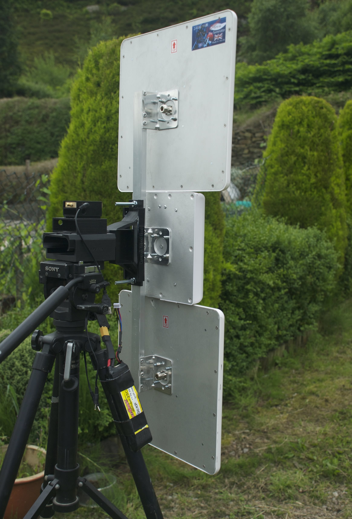

Yeah, my idea is to grab that tripod with the antennas on it and secure the three legs of it around the top section of an aluminum telescopic flagpole. Then close the legs nice and tight around the flagpole section with something like cable ties or hose clamps. Aim the antenna from the ground. Then just extend it up manually without twisting because the pole will lock in with steel pop up buttons as each section is fully extended. Fly. Lower it when done and put everything safely away in the house or shed to protect from wind and rain. It would only take a few minutes.
