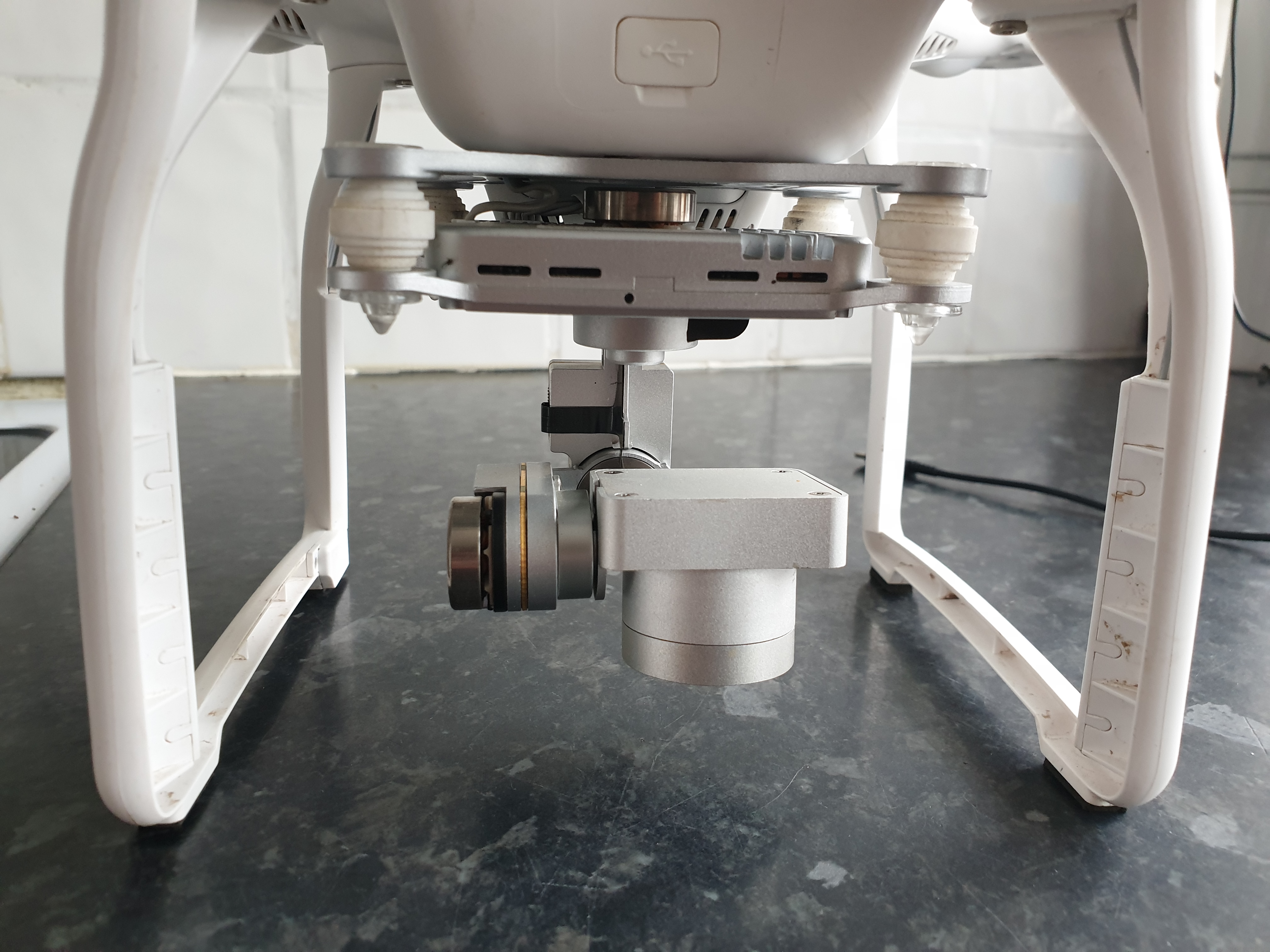

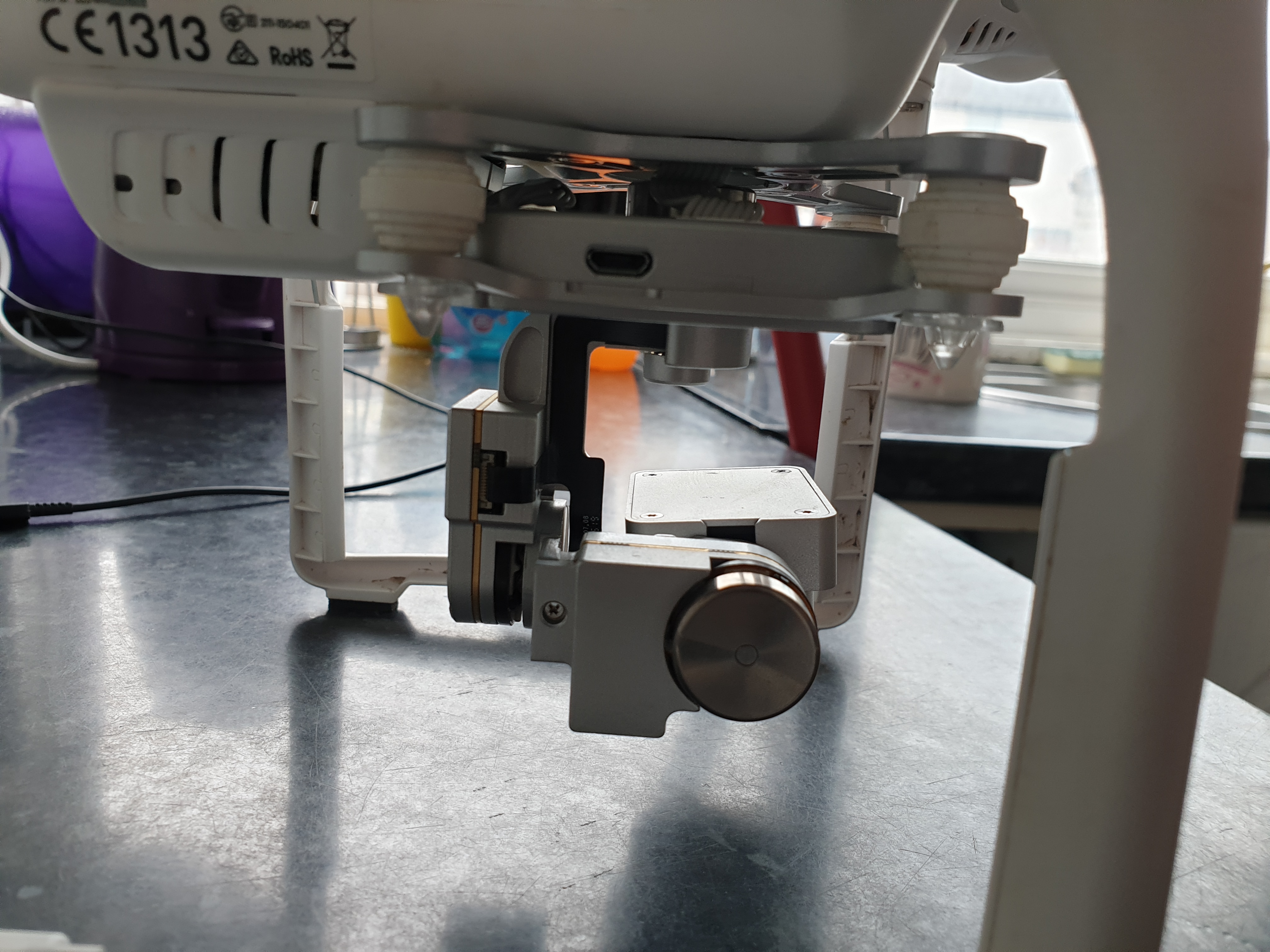

I have tried calibrating it and it doesn't seem to make a difference, there doesn't appear to be any damage to the camera or gimbal.. i'm just wondering if its worth getting a kit of ebay to replace the ribbon and arms???

one thing is your have 4 pins installed when there should only be 2 pins diagonal.

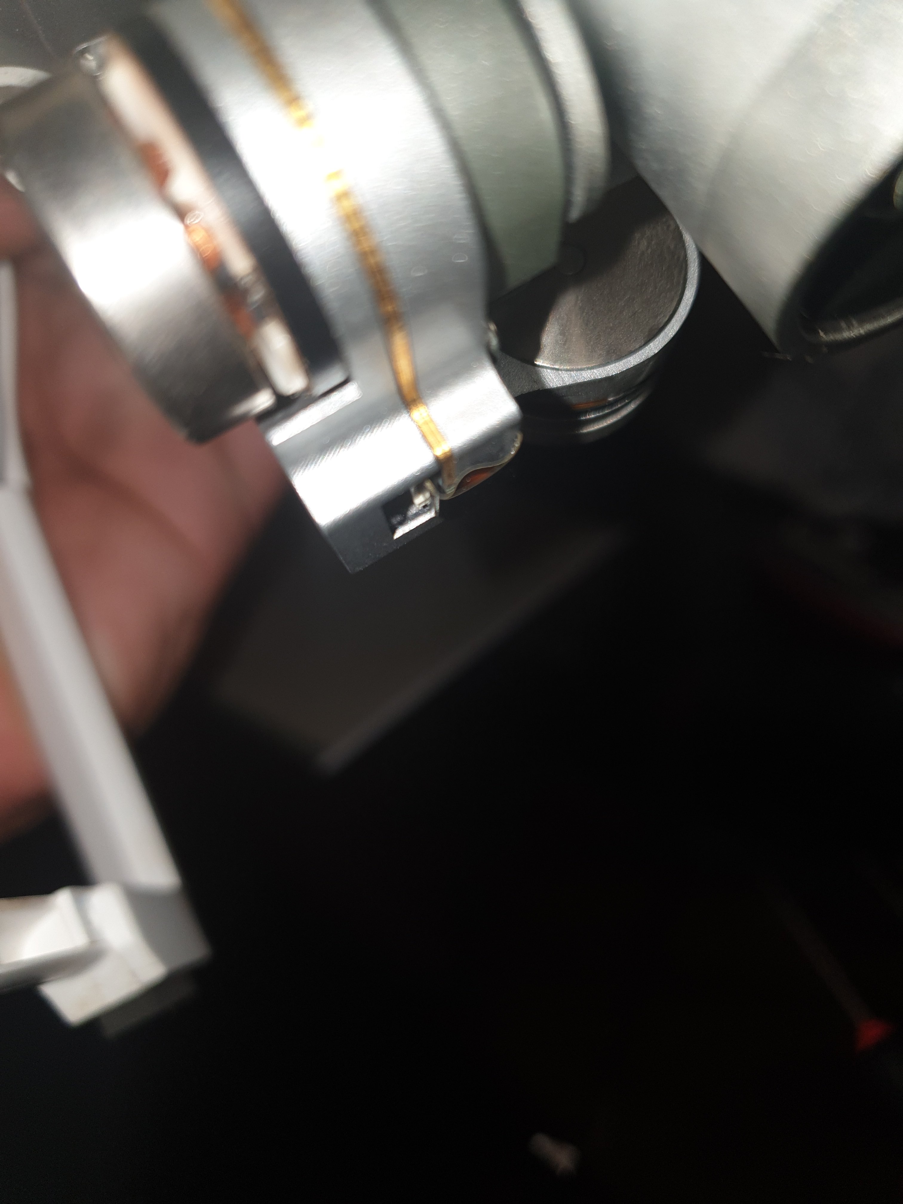

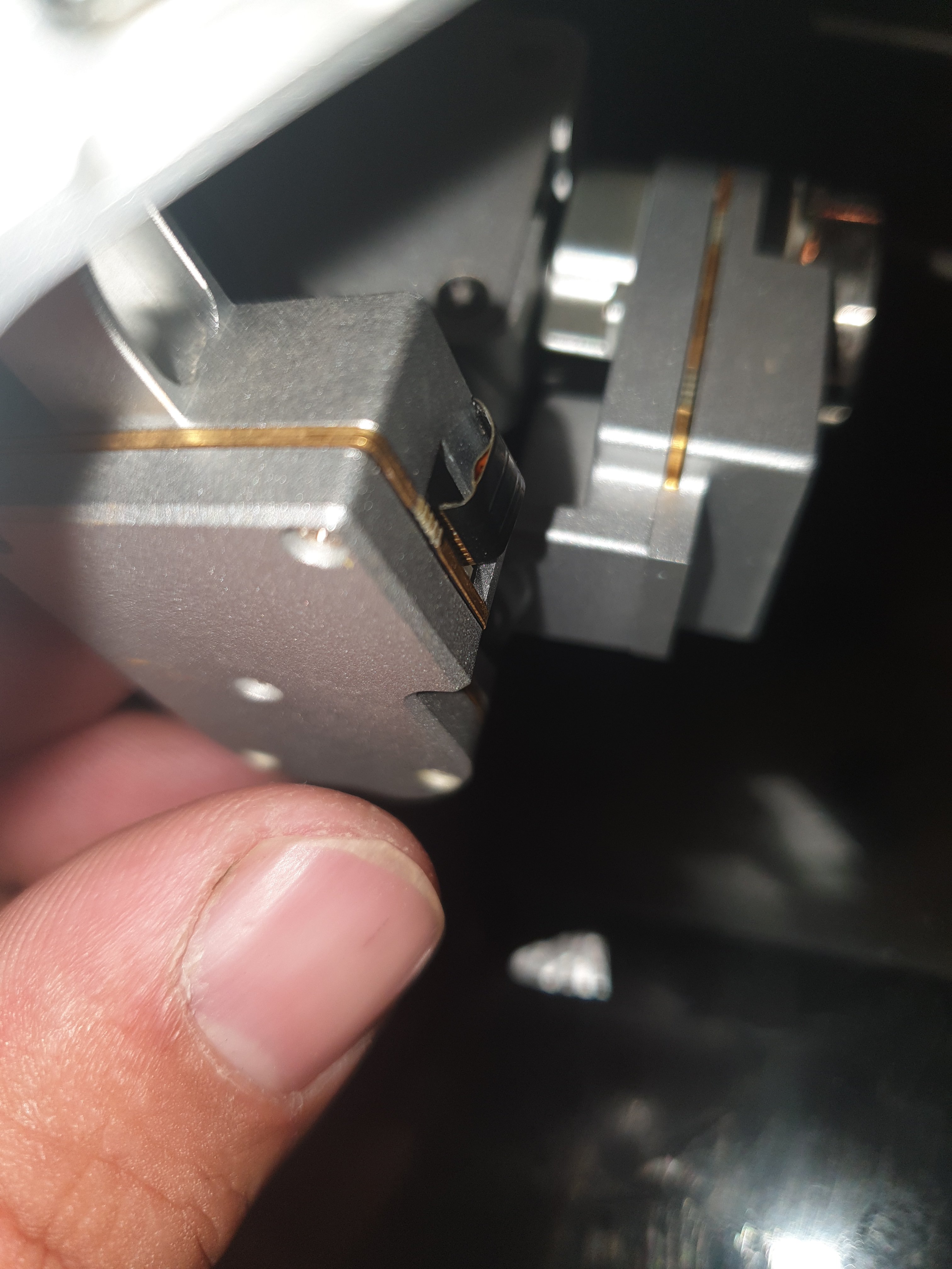

I’d start by checking the ribbon cable for any damage. It doesn’t take much to ruin the cable.
If it appears ok, then check the cable connection points at the pitch and roll motor circuit boards. Make sure the connections are clean and snug.
If you replace the ribbon cable, I highly suggest buying a new OEM cable. The cheaper aftermarket cables rarely, if ever, work.

What do you mean about the 4 pins? i don't understand?

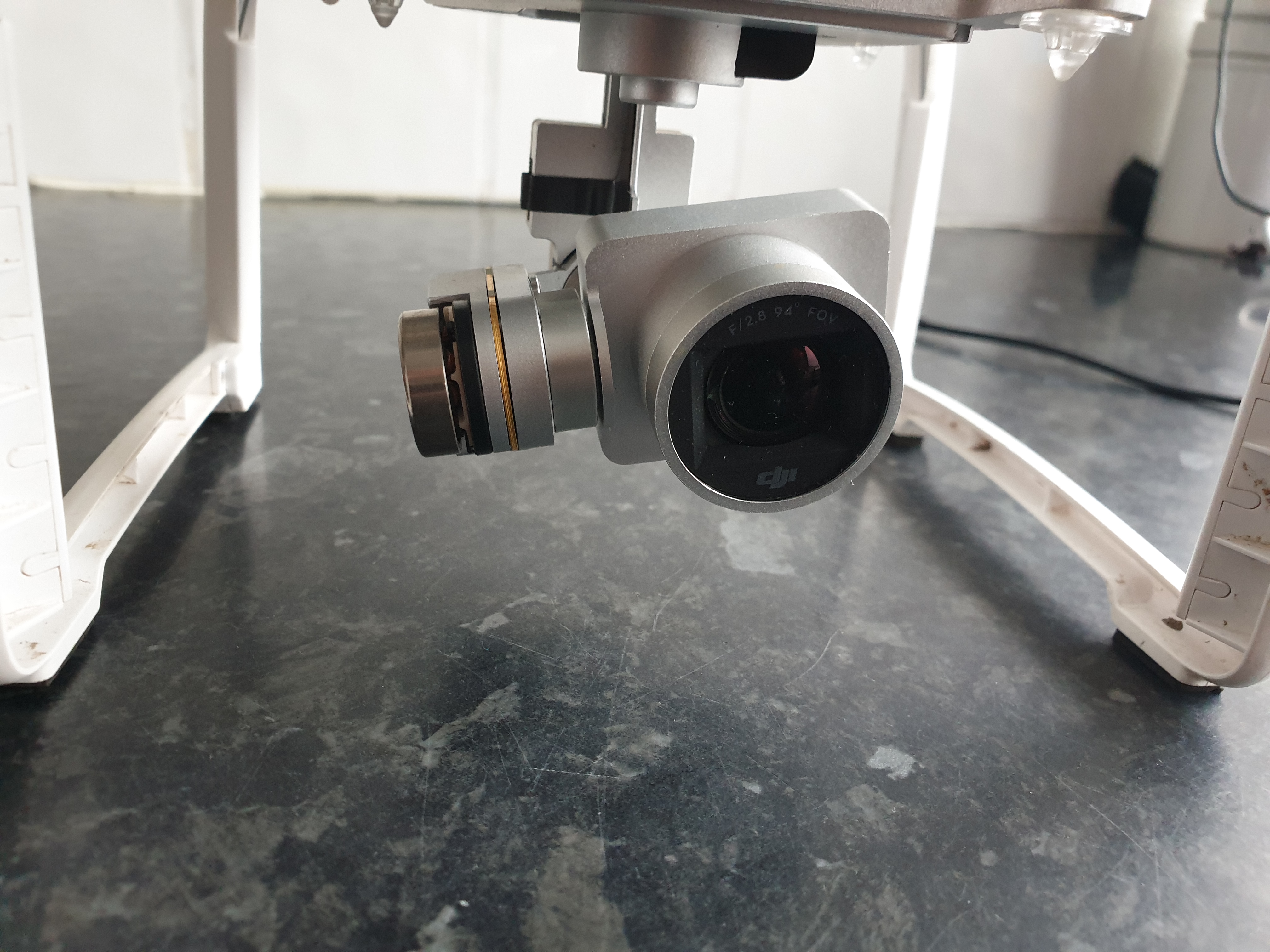

The Tilt horizon problem is happening while it twitches also, it twitches massively from left to right, then sometimes just stays out of horizontal position, is the anyway to be able to post a video to be able to show you
Ok i have checked the ribbon, and it seems like there is a section on each bit the bends that is coming away, im not sure if it is just the adhesive backing though

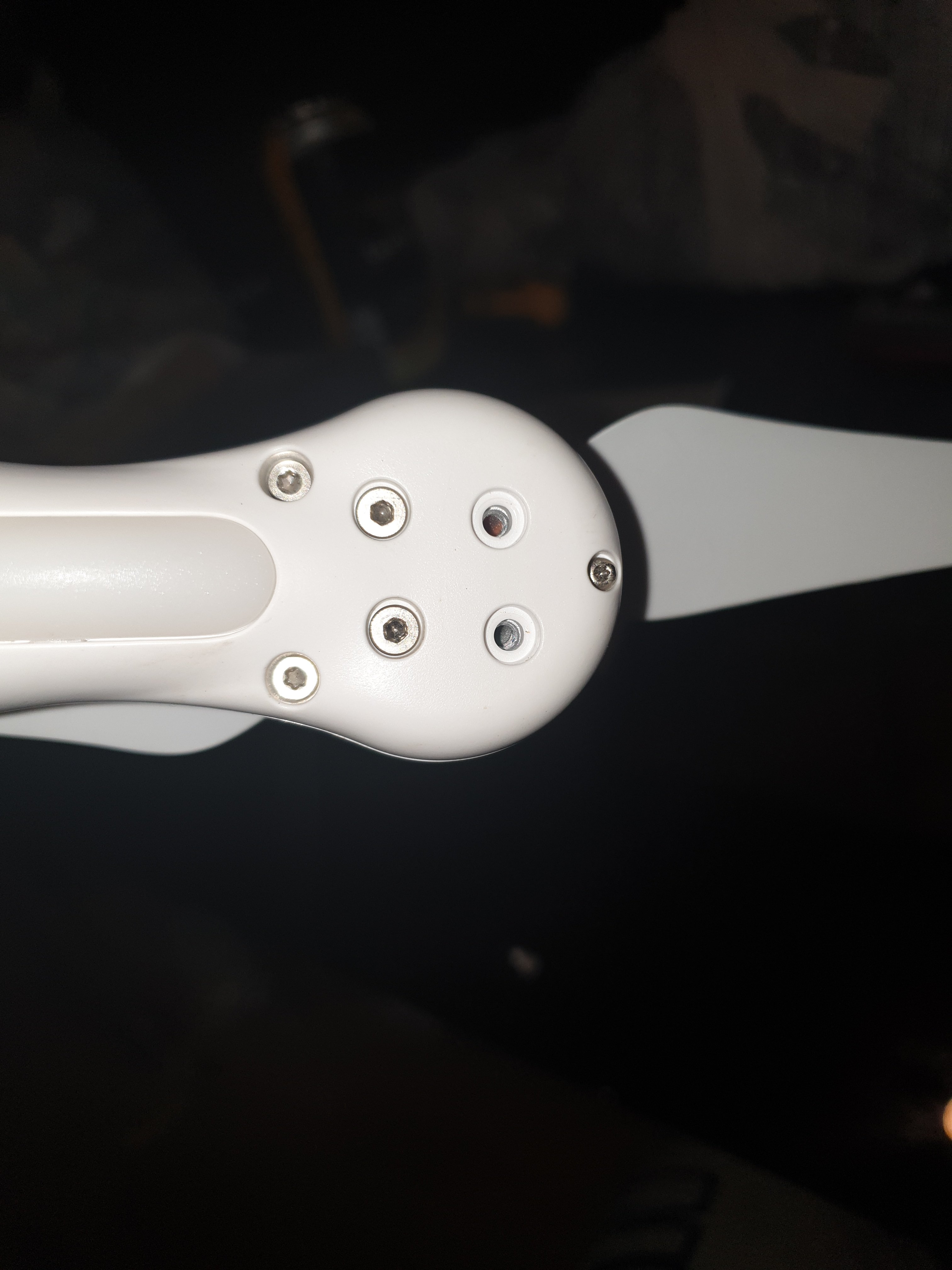

Had the top off and put it back together with out any clips showing this time, seems better now, should there be 4 screws holiding the motors in
Yes, those are the 4 motor screws. What JoBe was meaning in post #7 , is that where the camera/gimbal assembly connects to the drone, there should only have 2 of those clear plastic pins holding the camera to the drone. And they need to be diagonal to each other.
yep thats it @KachemakDiver. seems like every week is someone else with 4 pins!
yikes how is that a question? dont use too long screws and wreck the motors!
