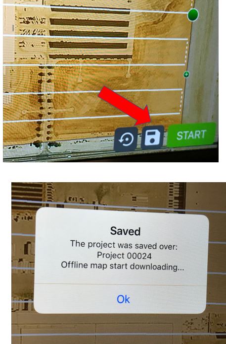

Every time I map a mission and save it, it saves over (rewrites the previous mission(. Can't figure it out(?)

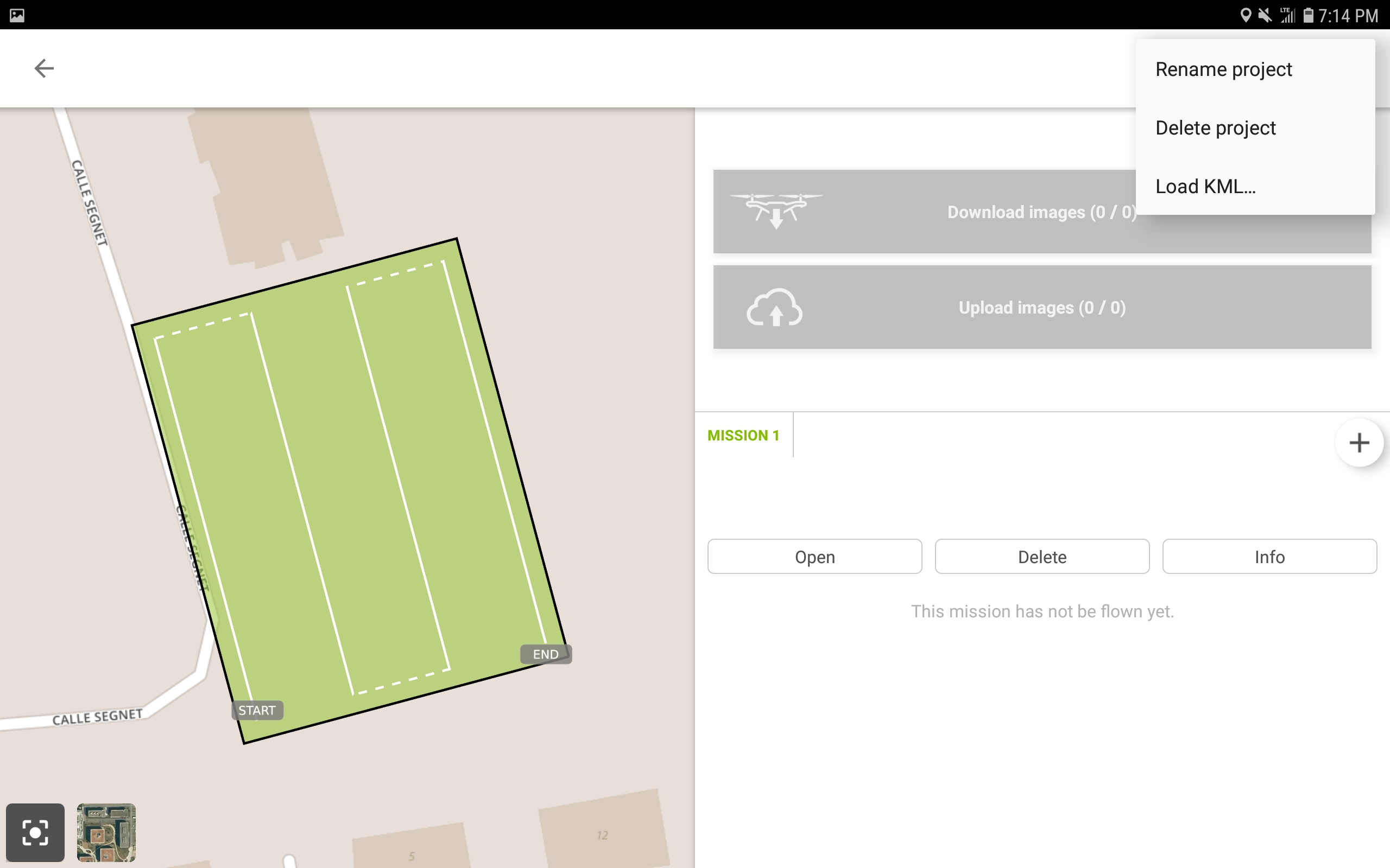

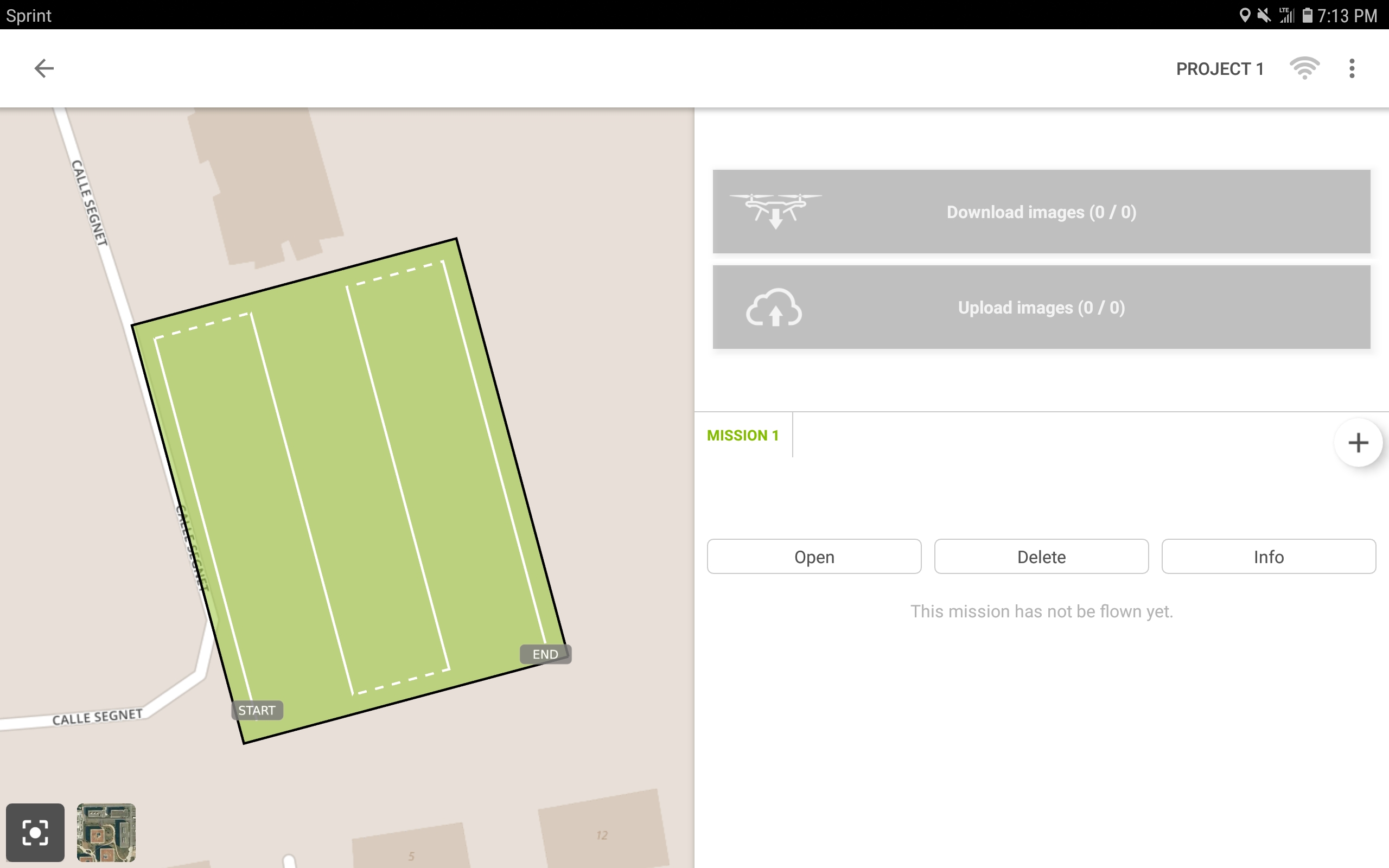

When you hit save, make sure you change from project 1 to your new name. Screenshot_20190402-191358_Pix4Dcapture.jpgScreenshot_20190402-191403_Pix4Dcapture.jpg
As you can see, I created 2 files. One with 3 missions in it and the other a simple mission.
After you are done, just close the app. Next time you open it, just go to project list and they will be there.
