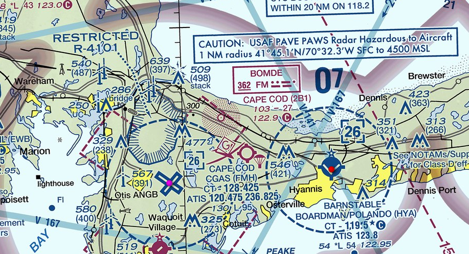

So, here is that portion of a current sectional. R-4101 would be a concern along that portion of the canal. I would not go there, and if that is where you have flown, a complaint was warranted. Yellow areas are congested areas and need to be avoided as well. Both bridges would need to be avoided, although you could probably go beneath them.
As I see it, as long as you were flying from property that was legal to be on and fly from - such as your own property or property that you have permission to use - you are good to go. Other than R-4101 and generally accepted practices regarding avoiding overflights of persons and property, there are no FAA limitations that I can see. Sorry ACE! you do not regulate the airspace well above your projects. The FAA does. And believe me, after at least two reports and investigations related to your flying there, if the FAA thought there was a violation, you would have been fined.

I found this on a website regarding the restricted airspace designated R-4101...
"Operating Concept: The Massachusetts Unmanned Aircraft Systems Test Center (MA UASTC) coordinates all non-military Unmanned Aircraft Systems (UAS) flight operations at Joint Base Cape Cod (JBCC). In an agreement among the Massachusetts Development Finance Agency (MassDevelopment), the Massachusetts Army National Guard (MAARNG), and the Massachusetts Air National Guard (MAANG), the MA UASTC utilizes facilities within Camp Edwards Training Site, Otis ANGB, and the restricted air space (RAS) designated R-4101. MA UASTC invites other UAS organizations to utilize these facilities on a cost reimbursable non-interference basis."

Eigth, there is a high powered radar near the canal. It is for defense of the east coast. I don’t think I’d want my drone near that, nor the other way around.
Exactly where, on the sectional, is this canal?
