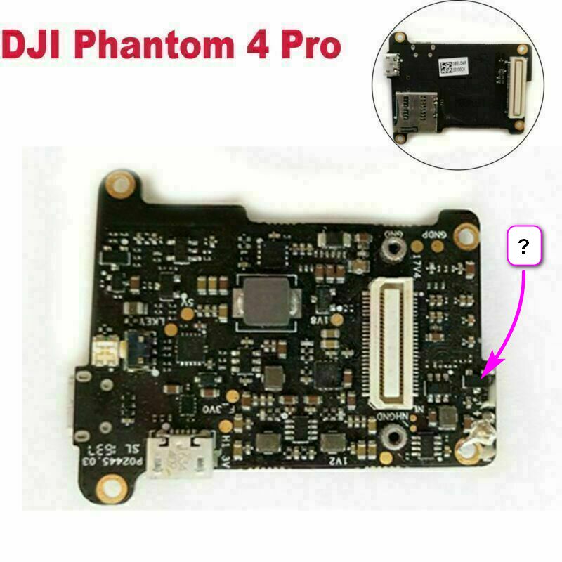

After the crash, the SMD element was torn off and lost. Help identify the element. What are the numbers/letters on the element.
That board replacement ain't cheap. Maybe a forum listed repair service can help identify and locate the element.
Oh thanks. The photo shows an older version. On mine, the diode is not placed diagonally, but has its own marked place - parallel to the fan, (marked "+" and "-"). I rang the tester all around, and this is logically a n-p-n transistor. But I was wrong. On the new board this is marked XOYX and 18, this is a mosfet A03400A. There are two more on the board. Element with six legs - controls the fan.
