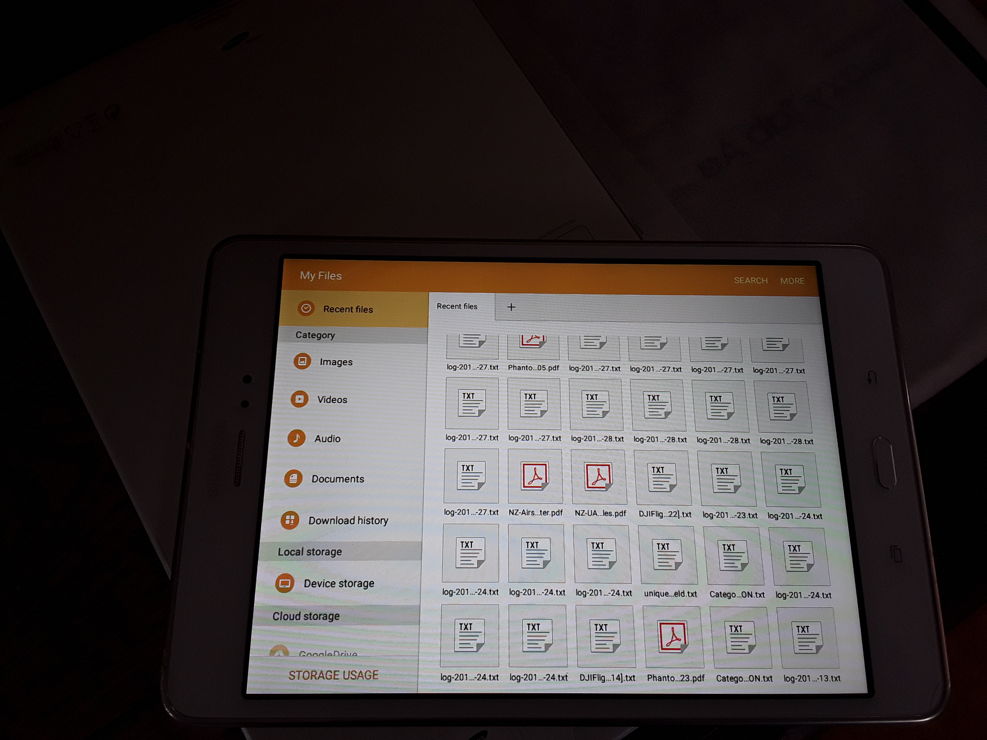

Here you go- I'm trying to figure it out maybe you can find my fault.
okay here is the link, maybe you or others can tell me what I did wrong.
