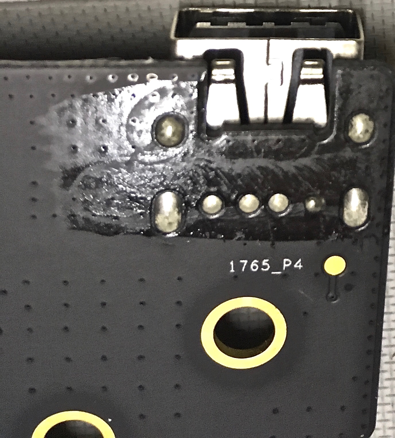

Having read elsewhere about loose connections/solder joints on the RC USB socket I just took the cover off and removed the circuit board (one large and two small ribbon connectors), and had a close look at the solder joints.
Couldn't see anything obvious - photo - so put t back together and tried it and hey presto, it works???
Now I'll be nervous flying in case it goes off when I'm in the air. Would it be worth re soldering the three pins, just in case???
