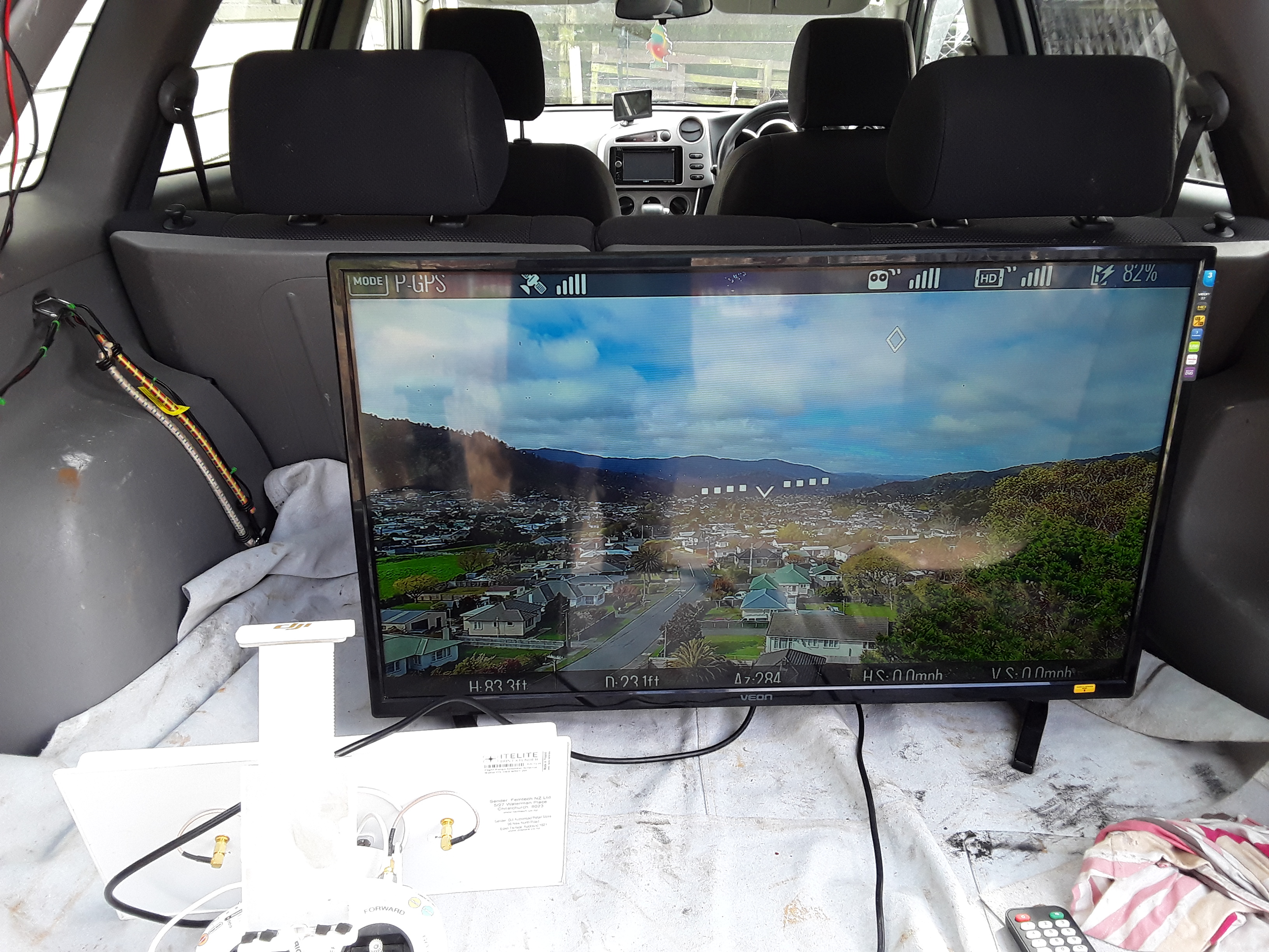

Your dji goggles won't display to tv,,you need hdmi module on back of remote so hdmi can then plug to tv or screen,,,unless conected with ocusync your goggles would normally plug into hdmi on back of remote,can't do this if hdmi plug is used when plugged in tv,,I had very same thought but ended up not using goggles and just view from me tablet or the TV,,goggles viewed directly to tv waste of time,,,better just setting up hdmi from remote to tv and in settings under HD it has setting to display to device and hdmi at same time,,,,I have goggles that just sit in the box,after viewing on tv those things are like led props,useless,,my tablet normally sits on my remote but was taking a picture

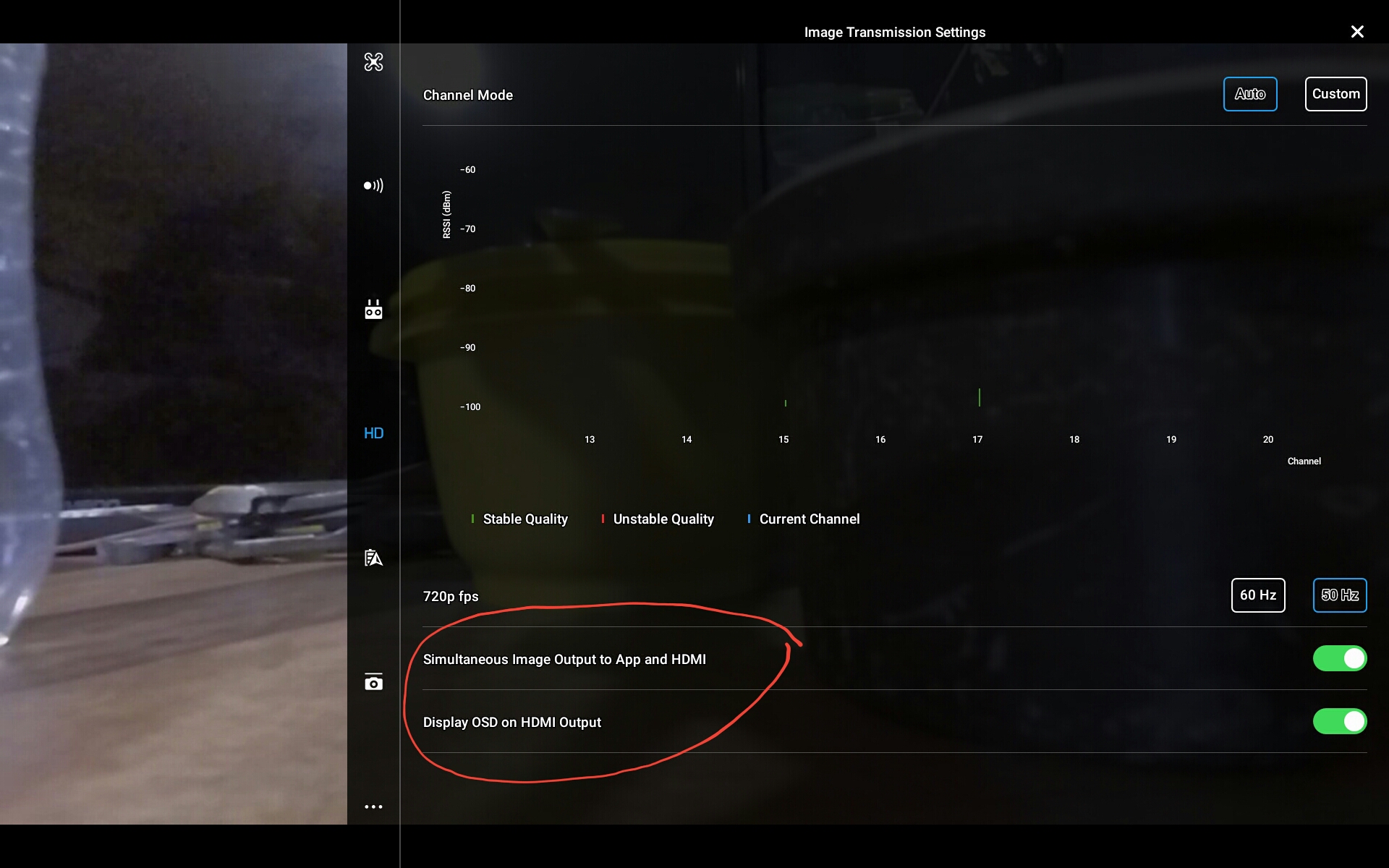

Also check here in HD settingsView attachment 104218
