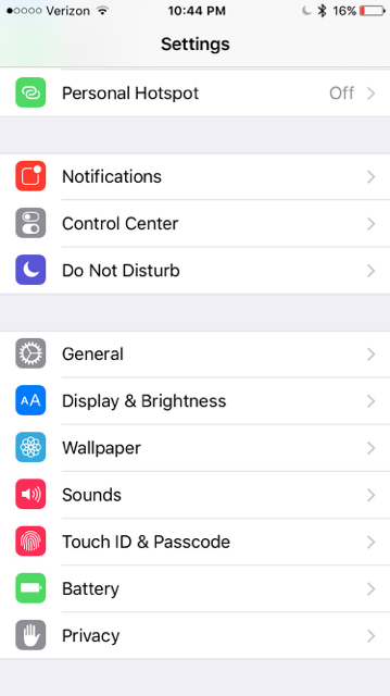

Yikes. Don't listen to him. Here is how to put it so autolock won't be on:
In the iPhone/iPad settings, go to settings, then to general
In the iPhone/iPad settings, go to settings, then to generalView attachment 48383
