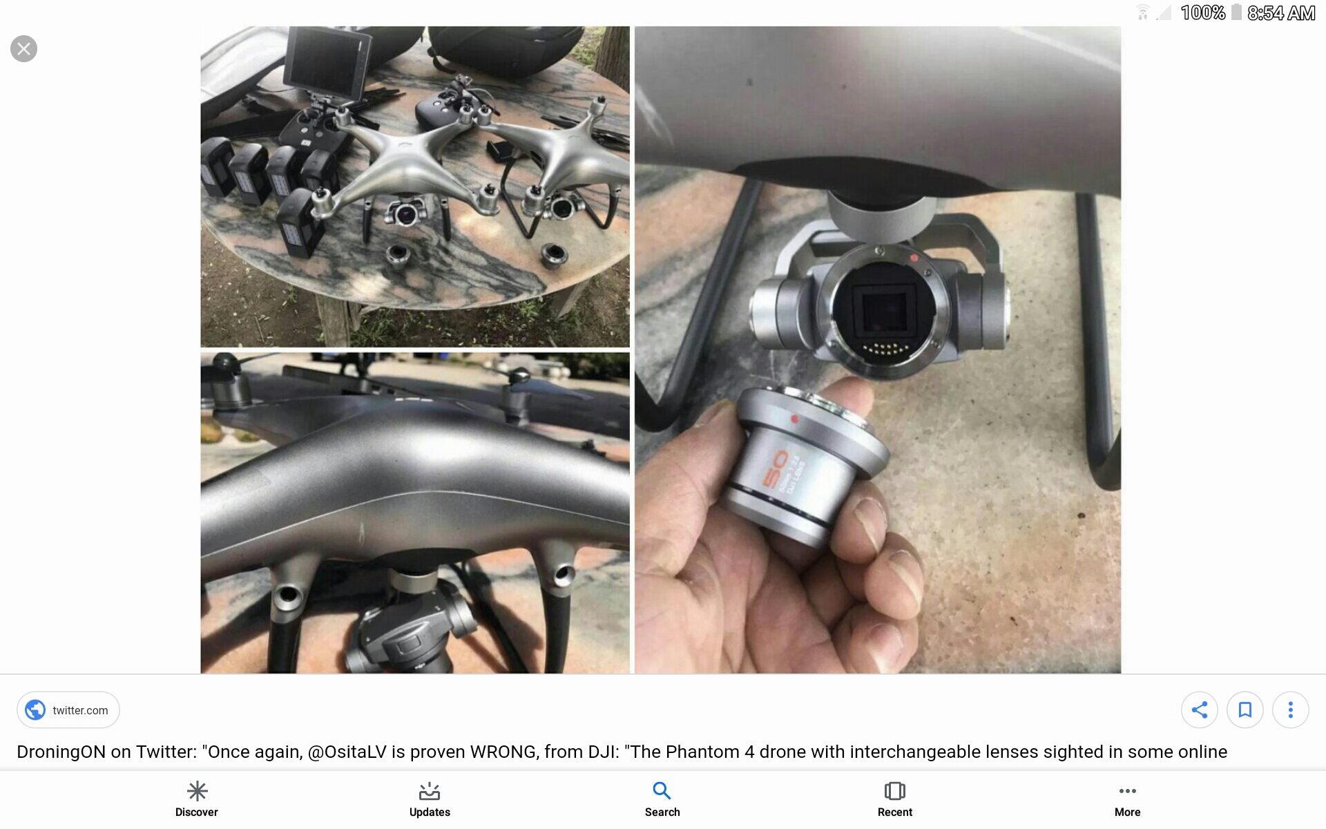

This is what I have been thinking about....are you saying this would not work?? Thank you for helping....
DJI Phantom 4 Lenses – Peau Productions

Might need something like this mayby...if I find something that will work I post it ,me curious on this aswell:)
I have never seen those before. I do see some potential issues though:
I've never seen those, but I can just see too many problems with a third-party lens of questionable quality.

The actual lens is a replacement that weighs 4.24g. Not sure how this compares to the original lens though.
The set up looks simple enough. The picture quality looks good from Youtube. But I am a bit concerned that more people have not discussed this option on this forum. It seems as if no one is using it. ???

I replaced a factory lens in a P4Std for a customer with a 8.25 lens. It was quite easy. The only issue was that the supplier failed to tell us that the lens needed to be focused 14 1/2 feet from an object. Once I corrected that problem, the customer was very happy with improved photography. Not sure if this will help your situation, but worth mentioning.

I don't want to injure my P4. I was hopeful that there would be more drone junkies on here that had experimented a bit more. The online video of the Peau 8.25 lens seems easy enough. I just have a lot of concerns around the fact that there are no real "testimonials" or show-offy YouTube videos like there is for everything else. Seems like no one is using this lens. I don't want to be the guinea pig. I'm just not that technically savvy. But if it was something that was done by others, to good effect, I would definately try it out.
Gotcha, makes sense. Watched the Peau video here:
It's pretty dang nice. There's a link to the install on there too, which doesn't look too difficult, but does look fairly permanent. Price seems great, and maybe you could get an extra camera or entire gimbal to swap as needed? But yeah that that point of trouble and cost, just upgrade to a Mavic zoom.
