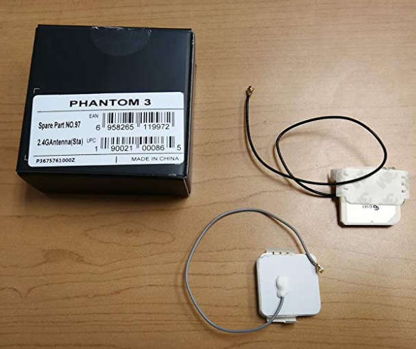

Hey guys,
Crashed my drone recently and the grey and black wire came off the camera and one of the gold thingy.
I soldered the wires back on will this work if not am I screwed.

I think those are coax connectors. You cant solder them... I think.

They cannot be soldered back on. I've never heard of anyone being able to reconnect them.
If needed, you can buy a replacement antenna here on Amazon or here on eBay.

They are WIFI coaxial antenna wires. They relay your telemetry. They normally cost around $20 US. Very easy fix. If you don't like opening up your P3 you can glue/tape the round disks on the outside your P3 . They are normally on each side of the battery box.
