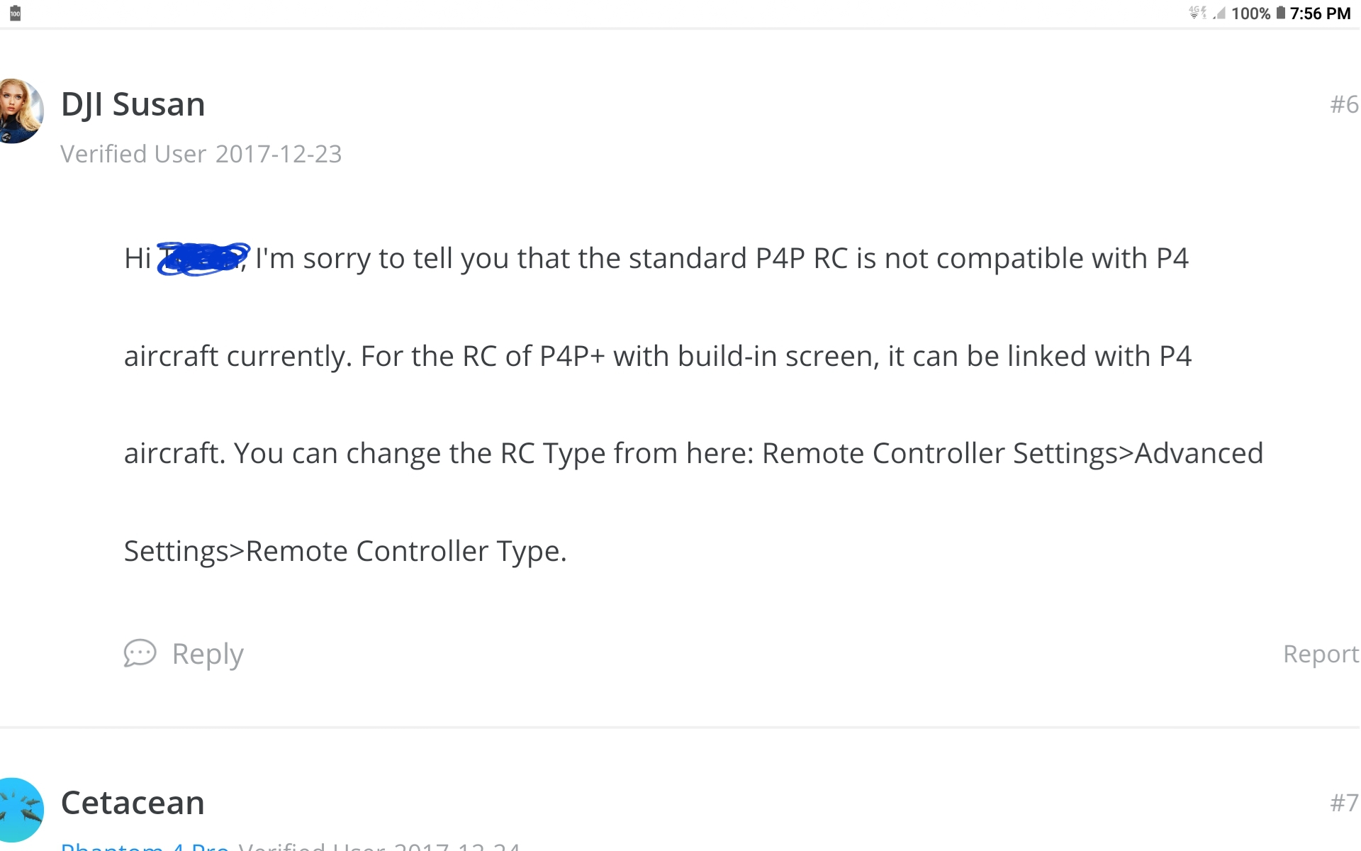

I saw this EXACT issue on the DJI forum (screen controller & a p4). I've chimed in for help on the thread (Oh where are you DJI Susan?), nothing (yes older but it goes to top of list). Day later, nothing, so bumped. Anybody here have insight? I'm willing to purchase Lichti (as Ive read they've got it working w/ GL300E, right?) if that will clear the way for "normal" connectivity?

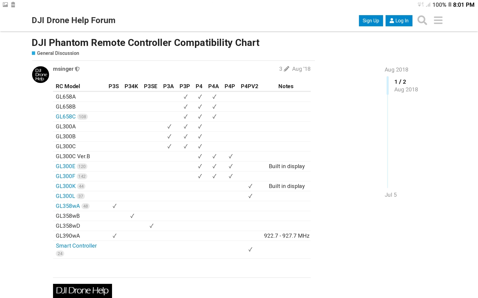

Is this what you read ? Tried this I presume
Reactions: tim3308
Says p4 on this list ,,as for the linking I would turn drone and rc on and press link button,,this will unlink it.....then go through rc linking again,if not work try manual linking with rc button combination

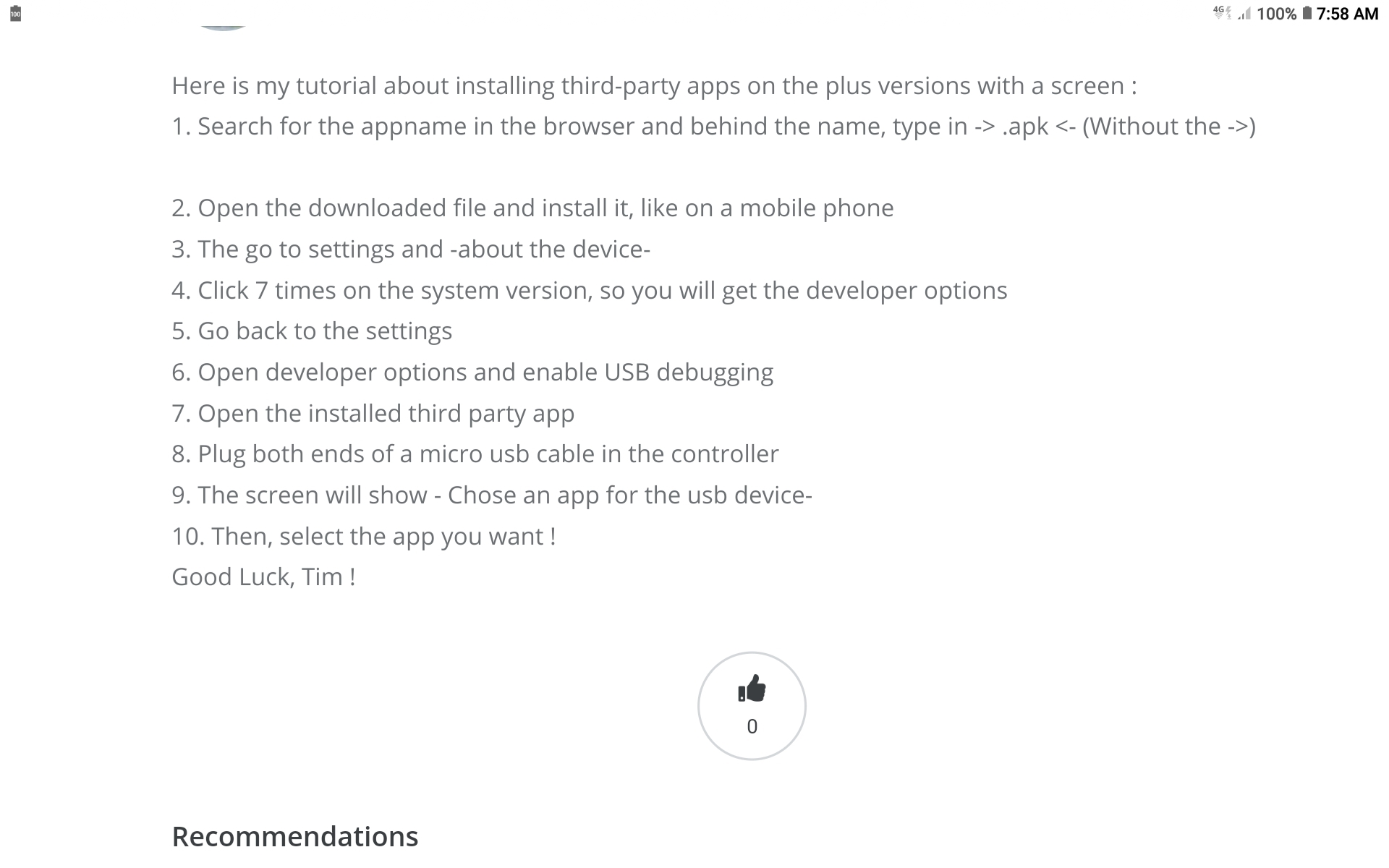

Maybe uninstalling DJI go app will delete caches etc?
I ran my previous controller w/ iPad mini. Not a windows/android guy.
How would I go about uninstalling and reinstalling DJI app on RC w/ bull it in screen (GL300E)?
