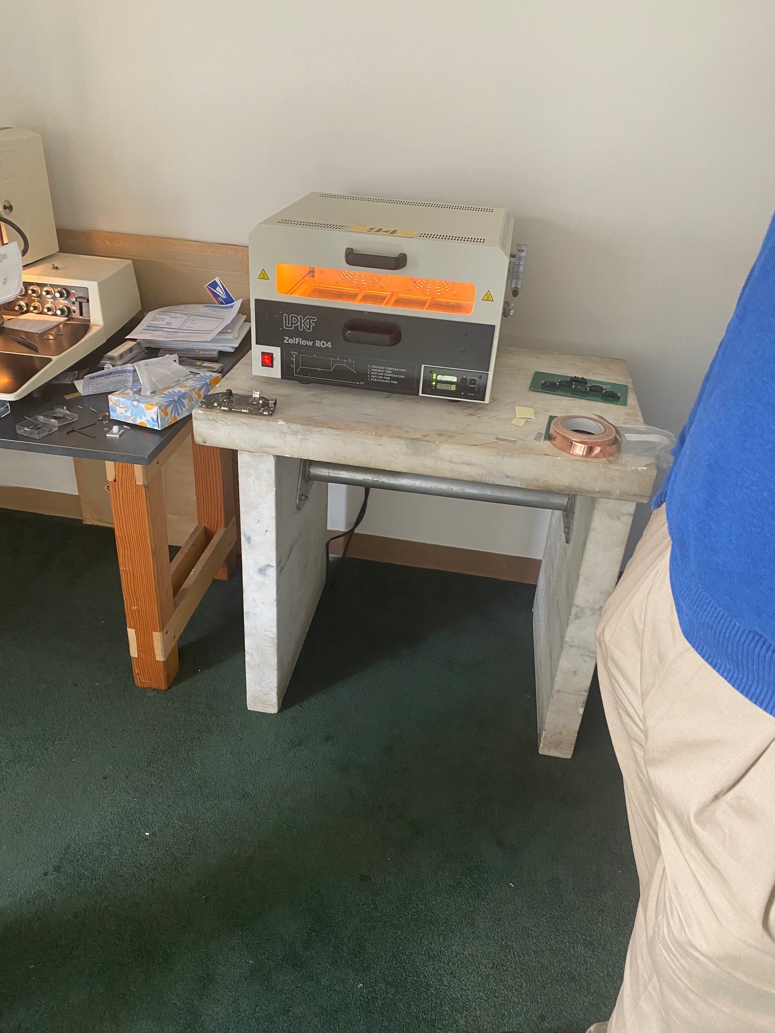

I contacted a friend of mine who suggested we re-flow the board. We re-flowed the board with his ZelFlow R04 at 200c for 10 min. Re-assembled the controller. It still has the same issue. Any other suggestions?
I hope you verified it is a single layer board before you re-flowed. If it is a multi-layer board you stand a very good chance of introducing more problems elsewhere on the board such as feed through connections opening up or shorting out. Good luck with that one. The suggestion I gave you is a logical one that will indicate where the problem probably is. It is also an easy safe procedure with minimal risk of causing more damage. I am a very experienced electronics technician having more than fifteen years in analog and digital electronics repairs in both the consumer and industrial electronics fields. I cannot offer any more advice than I already have.

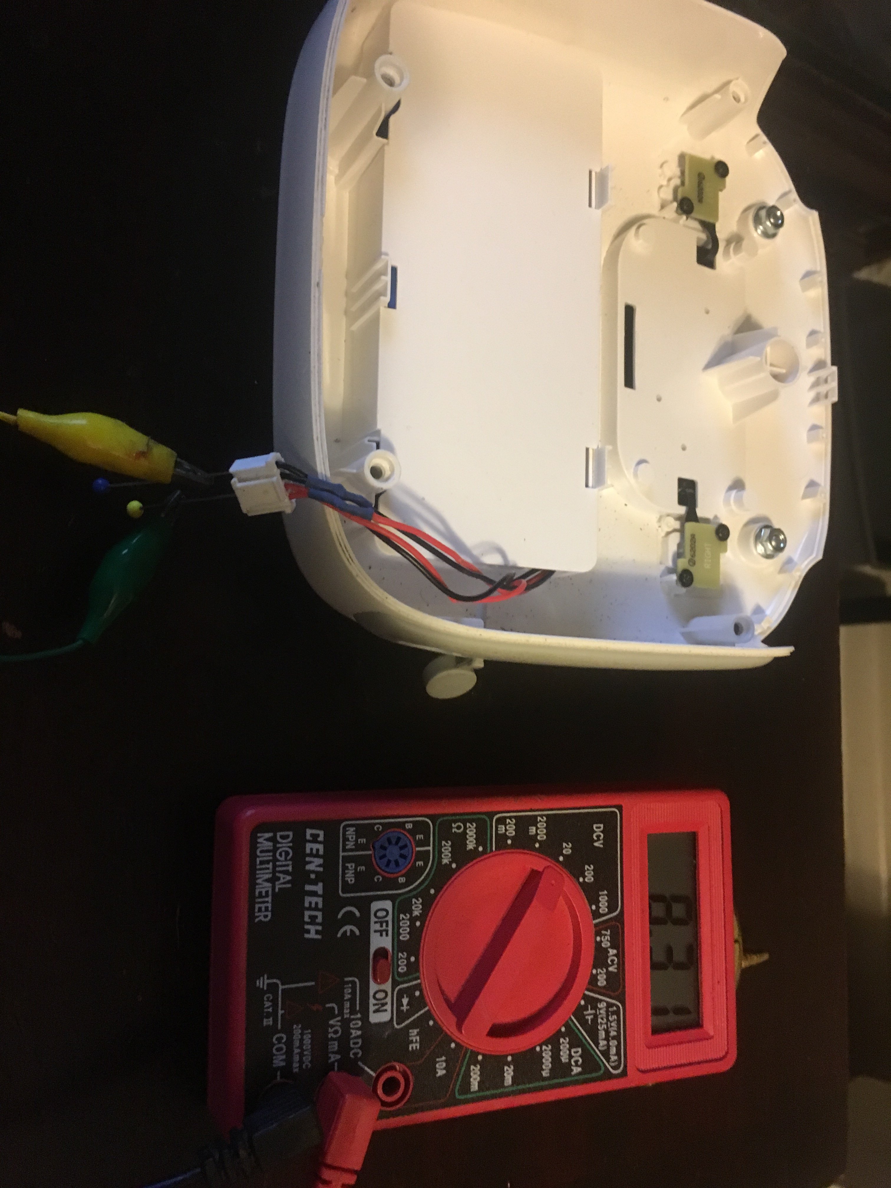

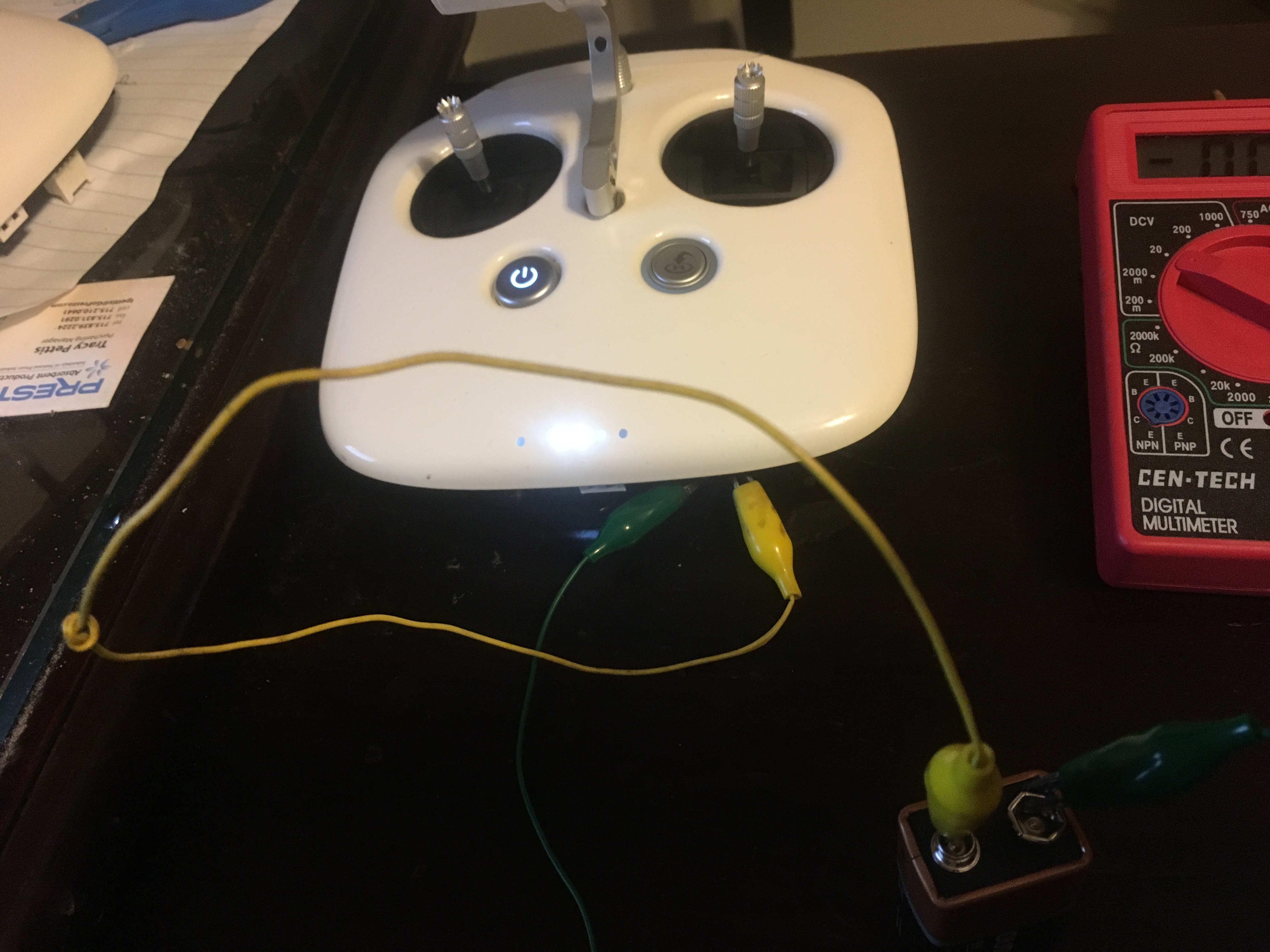

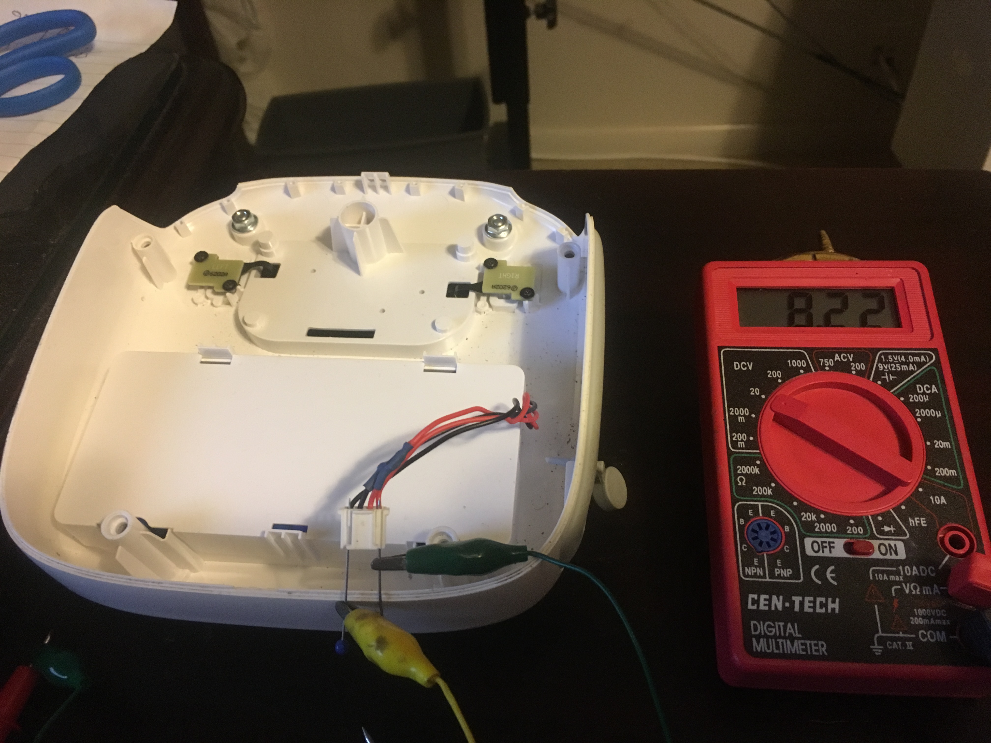

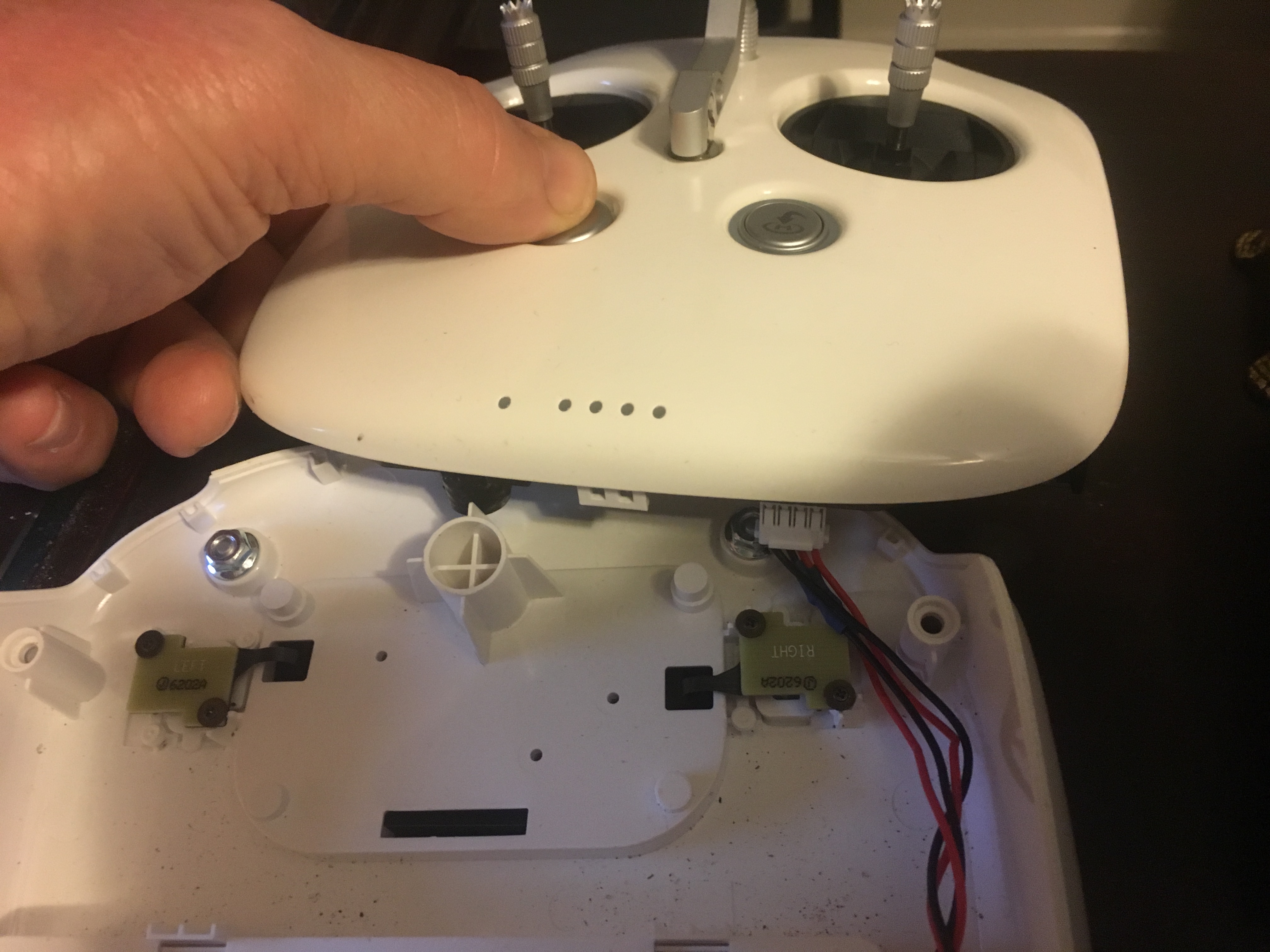

Here is the results from my testing. See attached pics.
The battery is measuring 8.22 v and 8.31 v.
When connected to the controller nothing works.
I attached a 9v battery attached to the controller and it lit the controller,
but I got a red low battery beep.
Any ideas on why the battery doesn't work in the controller? Is there
something like firmware in the battery that could cause the issue?
Thanks,

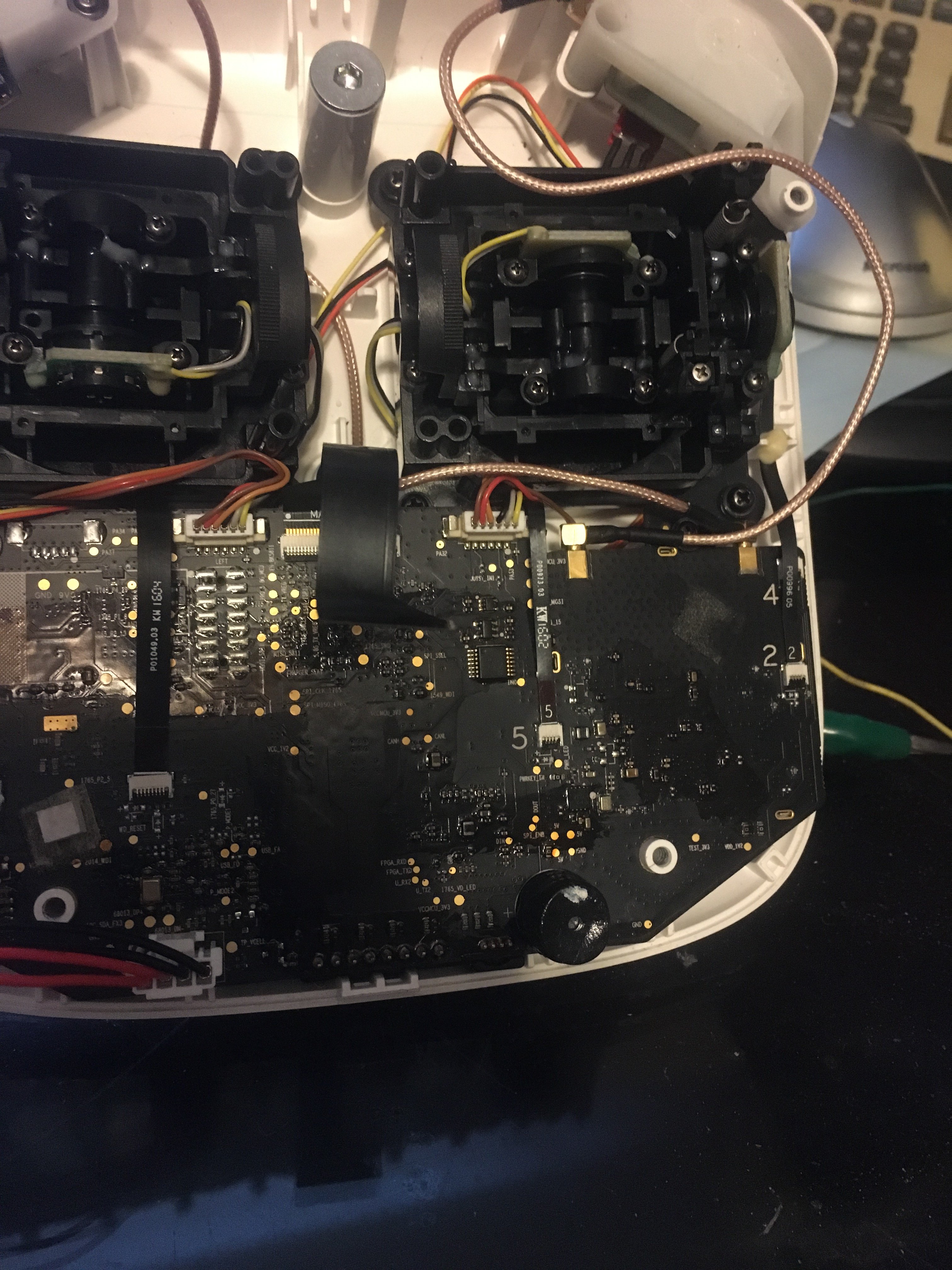

Here is a link to a YouTube video of a fix that you and your friend with the re flow equipment might want to try.
Not sure if I should try this. My board doesn't look anything like this board.
Is he touching the left antenna lead to the left dot on the number 5 ribbon cable? Any help would be greatly appreciated.
I wouldn't attempt to short anything. We have no idea what he is doing here. What I am suggesting is try reflowing the area around the chip in the video to see if that works. The trouble with some of these "instructional" videos is the instructor doesn't explain exactly what he/she is doing and that leaves a lot to guess at. Barring that, you may want to consider taking it to a qualified repair technician rather than spinning your wheels looking for a needle in a haystack, so to speak. One other question... did you check the battery voltage under load? Connect it to the controller and monitor the voltage while you attempt to turn the controller on. If the voltage drops then you have a battery that is not charged or is defective. Without parts to swap such as a known good and fully charged battery to try or another way to charge your own battery without your controller it is difficult to find the problem. It may be better to bite the bullet and send it out for repair.
