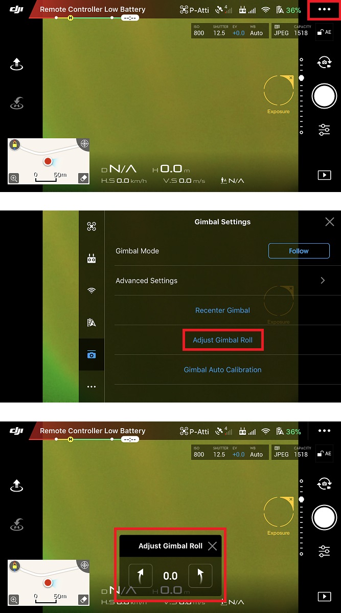

On my P3S the horizon on my photos is not level. The camera must not be level. Can this be corrected?
I didn't realize the drone should be level when taking off. That's probably my problem. But anyway, I can't find camera setting on my DJI app.

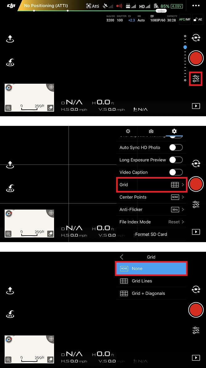

You can enable the grid in the following section of DJI GO:
You can adjust the gimbal roll in the following section of DJI GO:

My DGI GO ap is different than yours. I found the grid lines, but I can't find gimbal settings anywhere. Anyway, as I said I think my problem may be not getting the drone level at take off. I appreciate your attention.
What do you see in the "Gimbal Settings" section of DJI GO?
Feel free to post a screenshot if that's easier than describing the screen.
