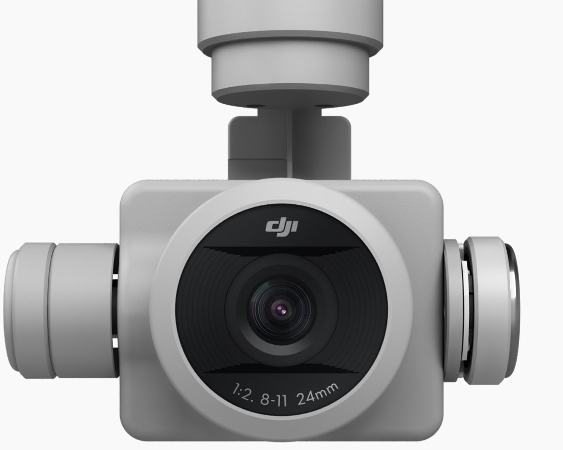

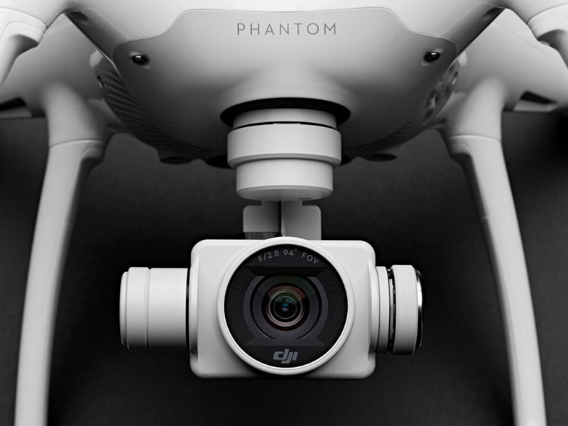

Don't know how I confused that. I have four that were crashed, two are the professional oh, one was supposed to be advanced but it doesn't show as advanced in the controller. So I'm thinking it's just a standard one. If that's the case I have two professionals and two standards
The P4 advance would have the same camera as the Pro, but not all the anti collision sensors that the Pro has. Look at the markings on the faces of the P4's that you have.
