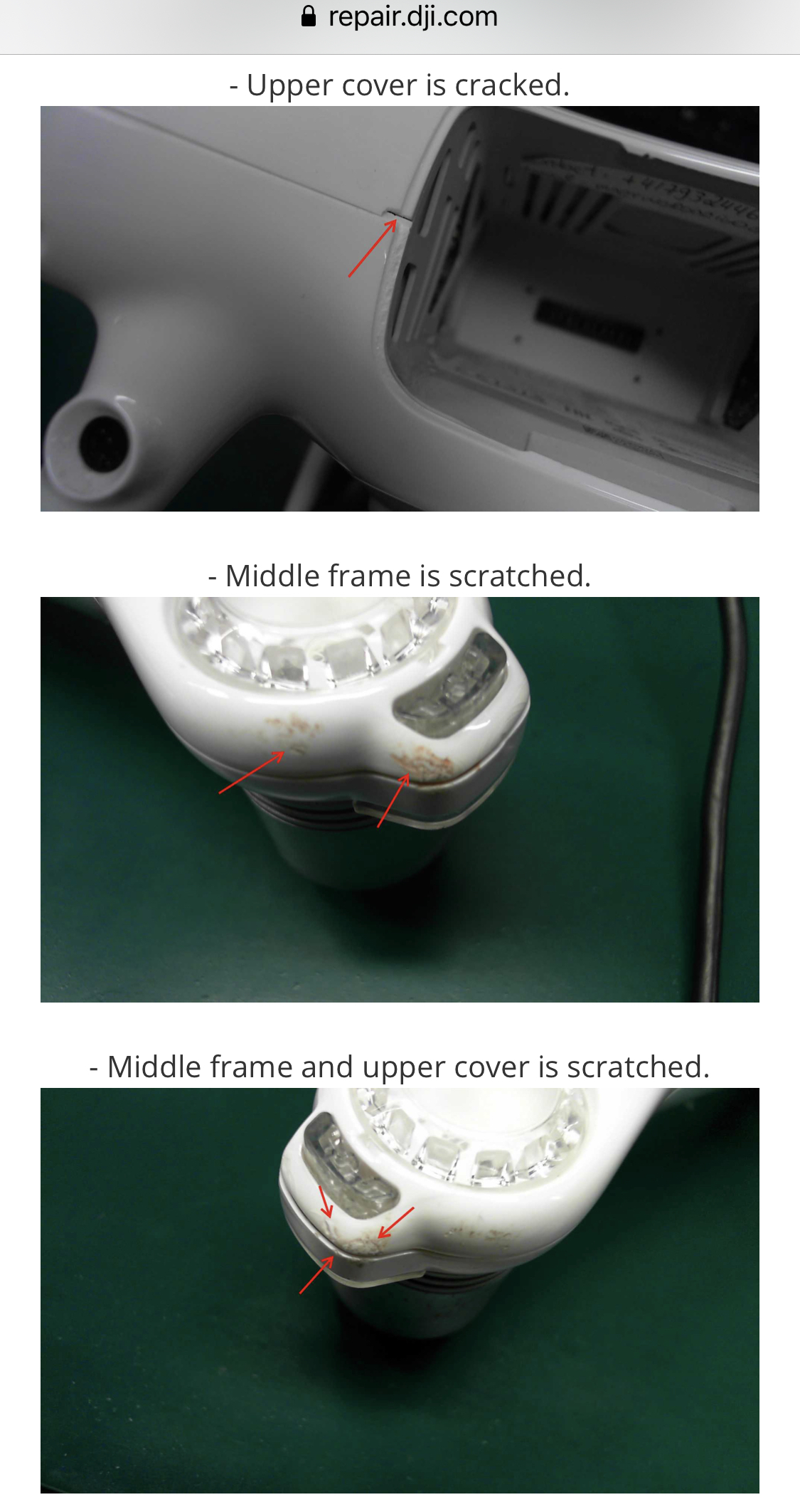

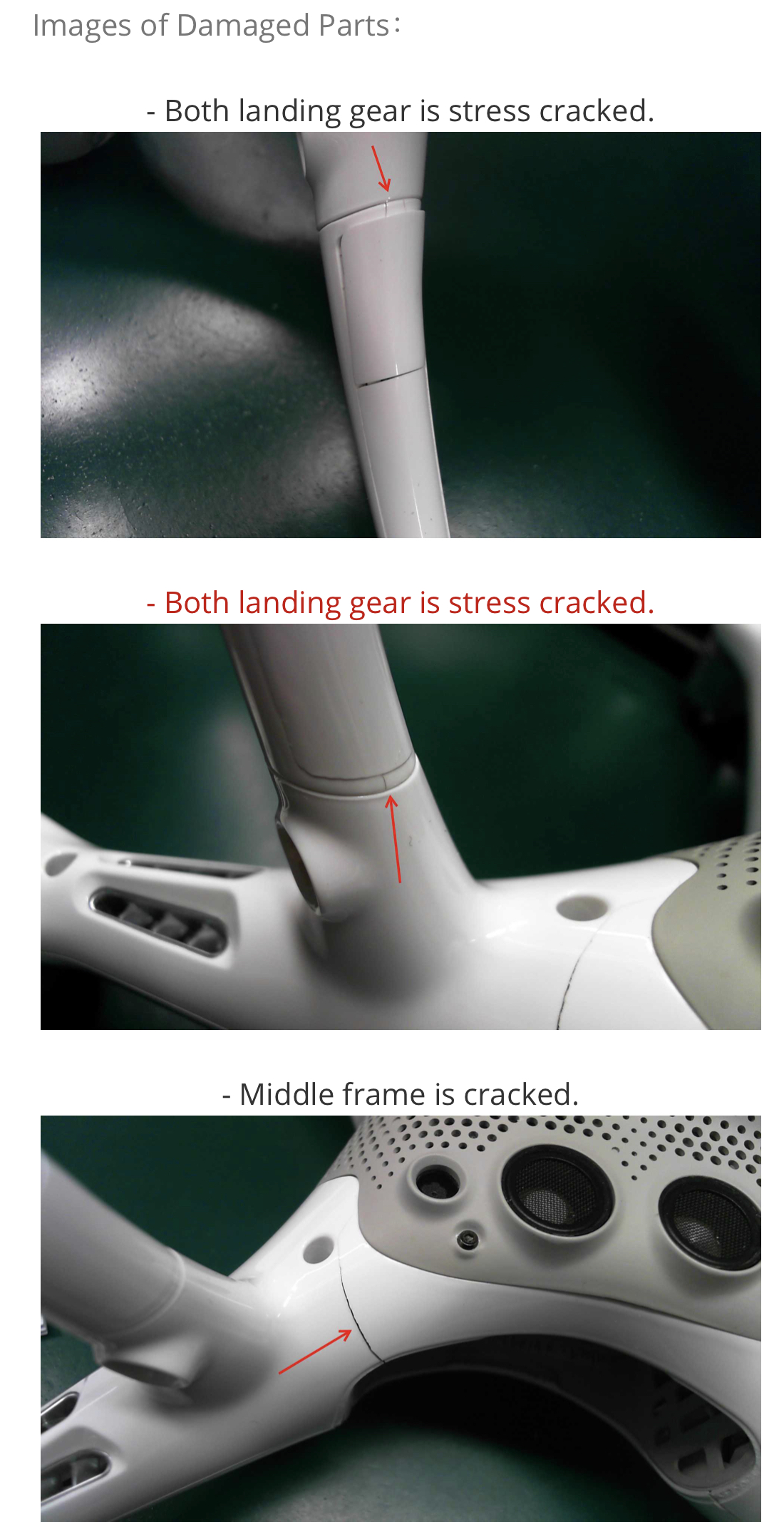

Hi everyone. I almost got a new drone after checking the price to repair in Switzerland.
I decided to send it to the Netherlands and the shipping cost me less than USD 40, and DJI will fix not only the gimbal, but all these structural issues on the pics. The whole thing will cost EUR 200, including shipping back to Switzerland!
I am very happy with the service and price for the repairs.

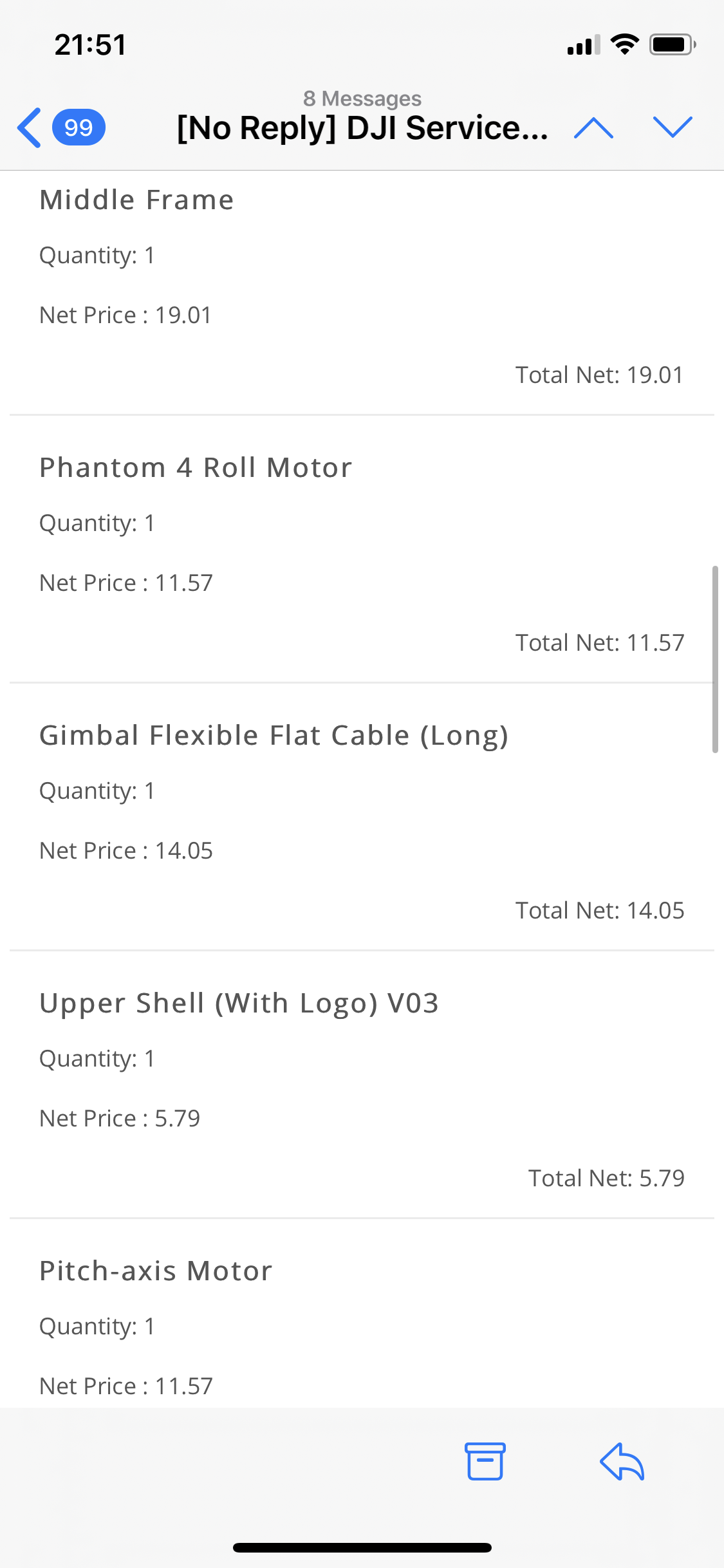

Did you find out what was wrong with it

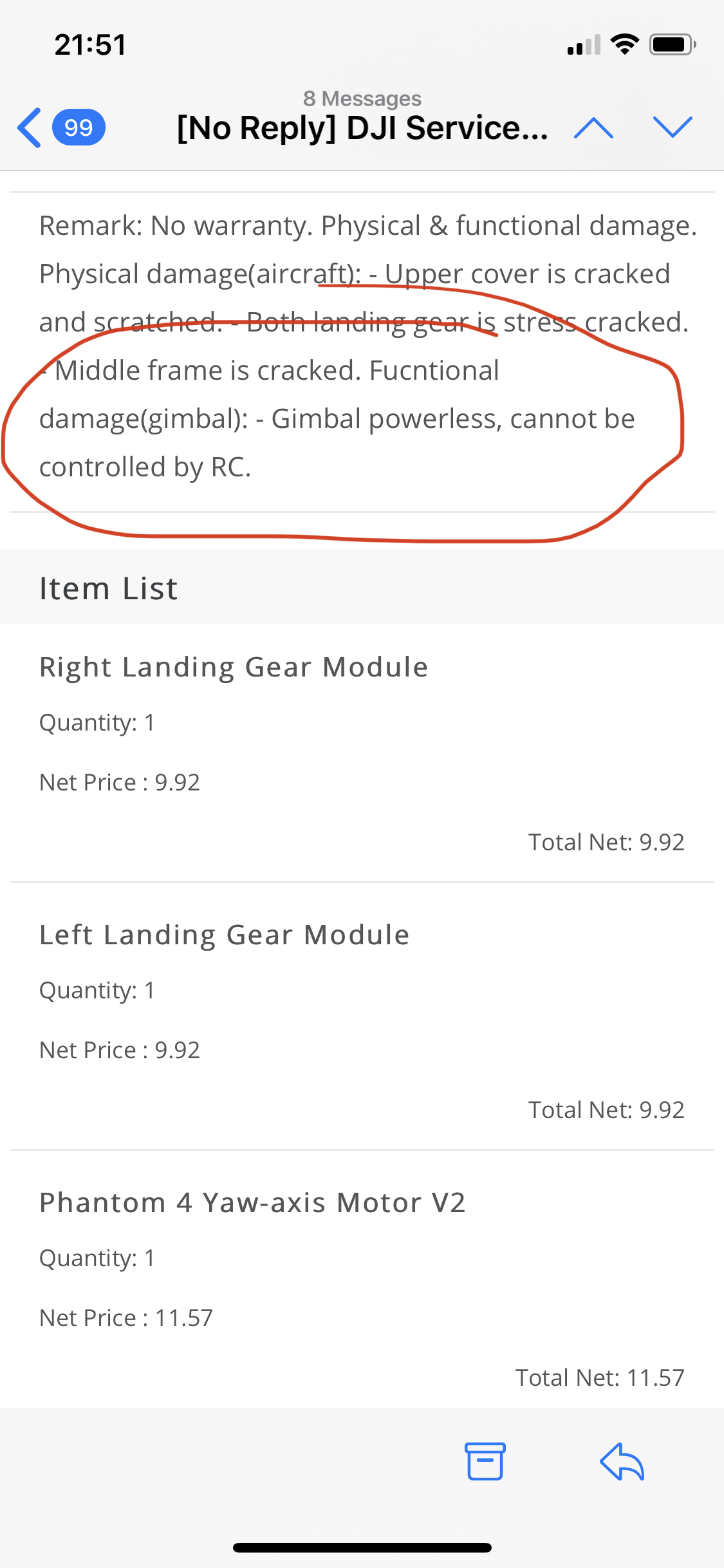

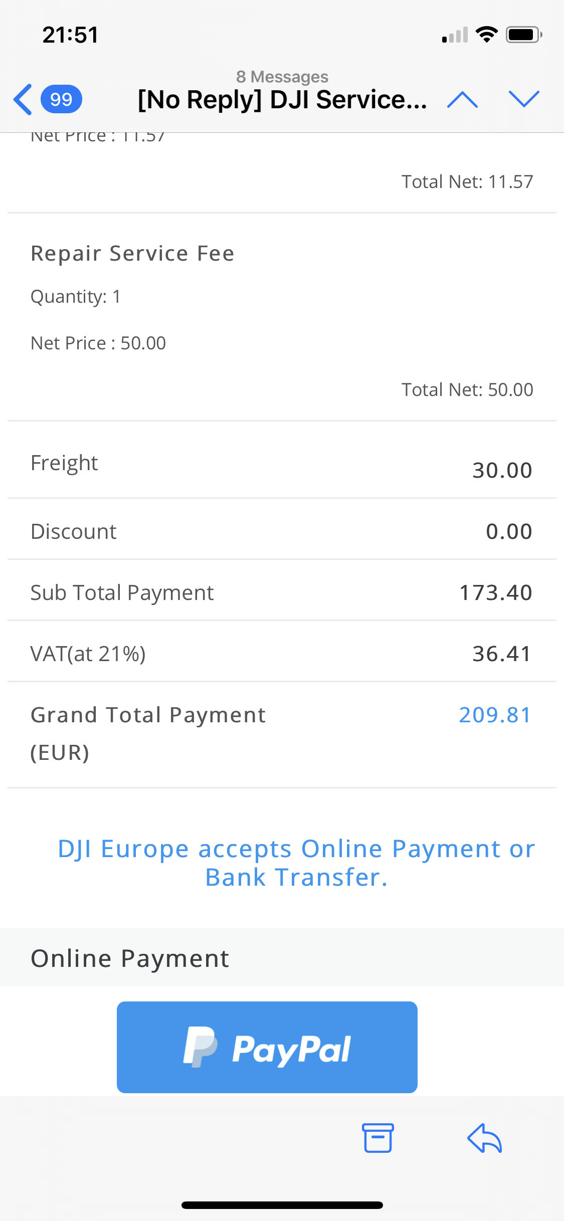

No exact details. Attached you find the whole quote and you see what is being replaced.
