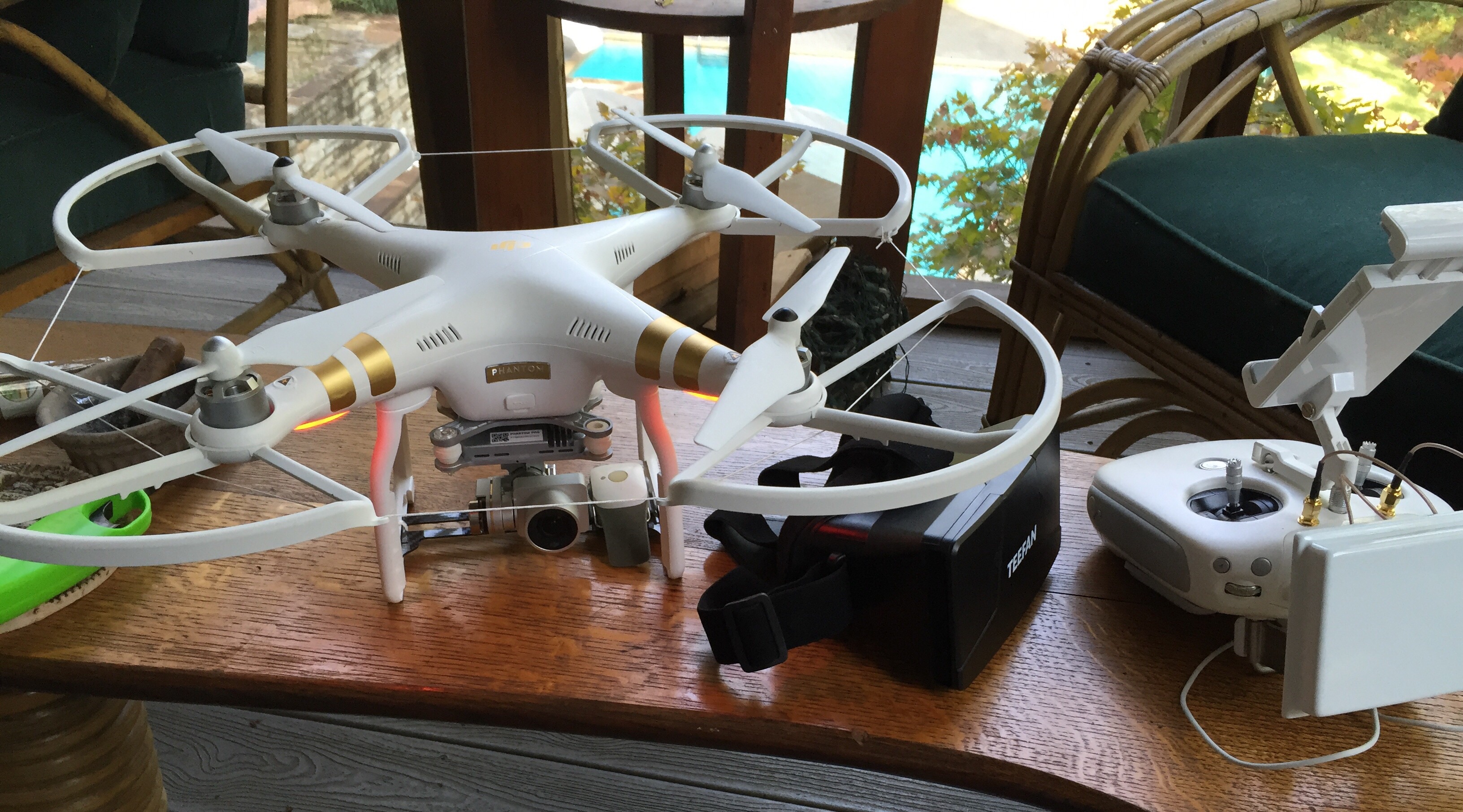

View attachment 27484 The FPV goggles thing is why I got it. And it works great on early testing. I've only made short flights so far, but as warned the iPhone 6 gets very hot in that case with all the CPU burden.
Is that a common problem? Does it often cause problems?
Being able to see it in full sunlight is great even if you didn't want FPV.
I haven't tried in flight switching from the split screen Goggles view to the regular view but I hope it can do that safely.
It's safe to switch between FPV Goggles mode to Camera mode (or vice versa) though it may loss a few seconds of video feed and flight log data during switch.
We tested a similar headset of what you are using, which is with close compartment and causing iPhone overheated especially in summer. You may refer to "Headset Considerations" section in the Help > FPV Goggles > Features or https://www.facebook.com/notes/fpv-booster/fpv-goggles-app-ios-for-p3-i1/591886014247542 for details.
Meanwhile, we have further improved video CPG/GPU usage in the next release v1.1. It will reduce heat generated from iPhone.
