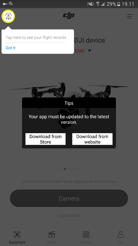

Forced Go App Update -Workaround

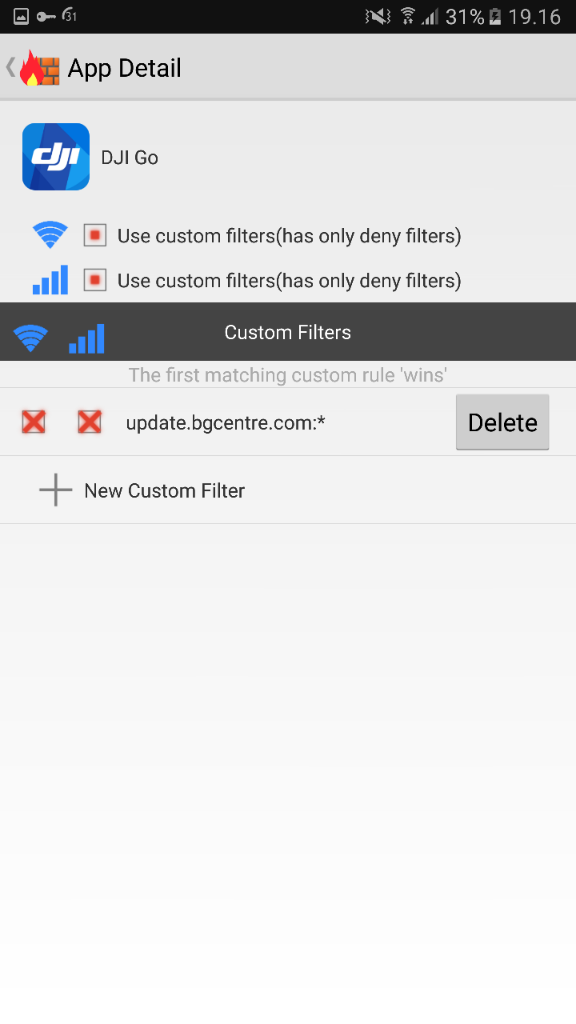

Actually most of the credit for the firewall should go to spectra9 and Oz_Sparrow. Spectra provided the offending server (upgrade.bgcentre.com) in post #4 and Oz_Sparrow mentioned the firewall in post #9.
thanks KennyJr! Updated with credits for those guys, im big on giving credit where credit due. I'm just trying to aggregate the steps into one doc :)
Hey kenny, tryed the firewall and go 3.0.1, i get failed signin, but not real sure how to set it up i put the site in the filter for the dji go app, what do i need to inter and how
When setting the rules for the go app, the first thing I did was create a rule blocking all access to "upgrade.bgcentre.com". After that I allowed all other access. If you block anything else you run into other problems such as you have, or not getting the map to load, etc.
If you bring up the rules for Go make sure everything has green check marks except the rule blocking upgrade.bgcentre.com which should have red "x" 's.
No root firewall trick doesn't work anymore??
Lähetetty minun SM-G930F laitteesta Tapatalkilla
Well how did it work for a week with it?? :D
I installed modified apk and it is all good now.
