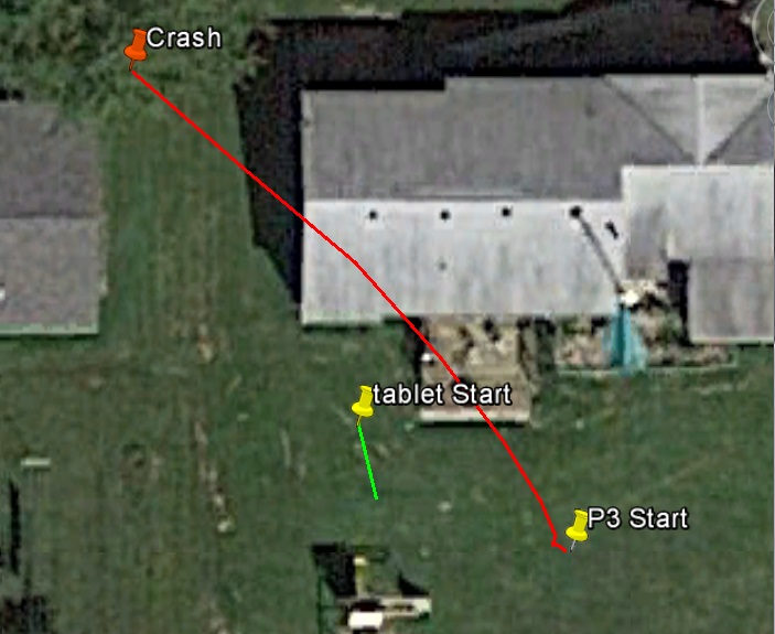

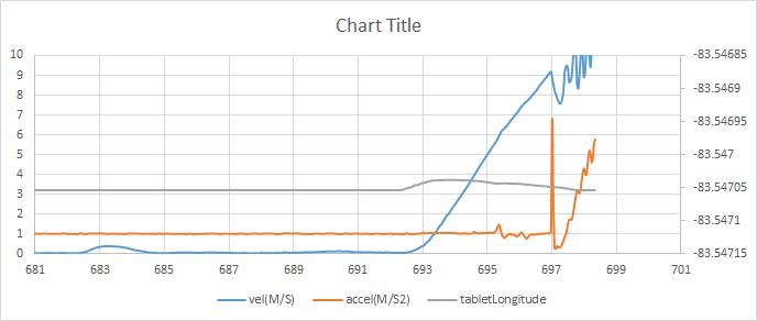

    From your description and the .DAT the incident occurred at time 692.2
    The P3 had been placed in FollowMe mode and the tablet started moving towards the P3 as indicated by the change in tablet longitude. The P3 start moving and reached a velocity of 9 M/sec. There was a acceleration event at time 697 indicating it had crashed into the tree.
    This annotated Google Earth image shows the locations of the P3 and the tablet.
    The red line is the P3 and the green line is the tablet. When the tablet started to move south the P3 attempted to move to a location that would allow it to follow the tablet. Is this how FollowMe mode is supposed to work? I analyzed another FollowMe mode incident where the P3 maneuvered to follow the tablet.
    #2 BudWalker, Mar 31, 2016

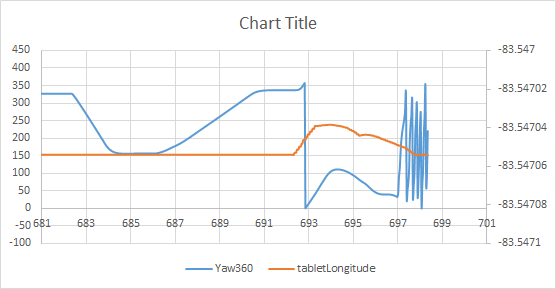

    Some of these incidents occurred when the tablet moved towards the P3. I'm taking a look to see if the P3 orientation has any effect on the P3's decision to follow by staying in front or maneuvering to follow from behind.
    @Balabonov stated that the P3 turned away from the tablet after initiating FollowMe. But, then the P3 turned back towards the tablet before the fly-away. Here is the plot that shows that
    The P3 to tablet bearing was about 300 degrees until the fly-away occurred. Initially the P3 was facing the tablet. Then at 682.5 it started turning away from the tablet. At 686.5 it started turning back towards the tablet and was facing the tablet when the change in position (and fly-away) started at 688.7.
    This is what you'd want from FollowMe. I.e., the P3 determines the bearing to the tablet and then faces that direction. Then, you'd expect the P3 to follow by staying in that relative position while facing the tablet. This isn't what happened in @Balabonov 's flight.
