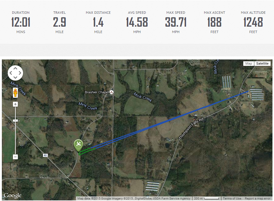

This is the issue I have. Wrong altitude. Not sure why my altitude shows 1248, Im actually only at 140 to 190 feet max.
Flytrex shows altitude from sea level. The "max ascent" is your highest point from your take off point.
