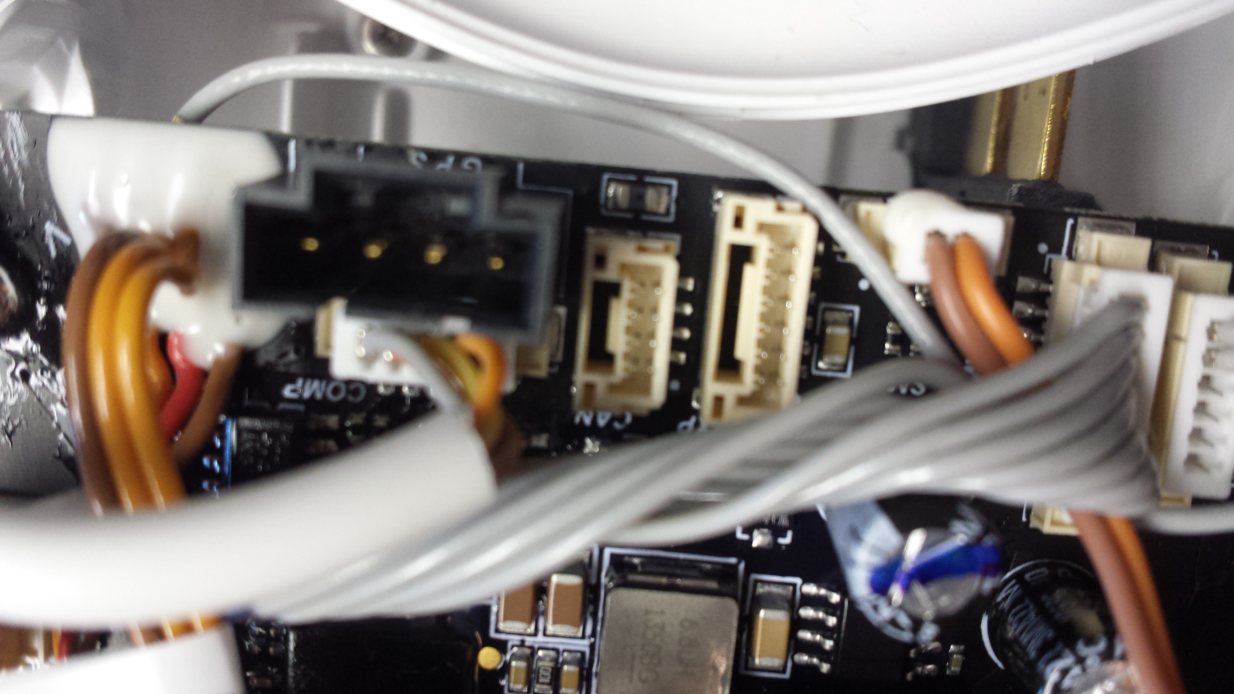

To help me determine the cause in your specific case please post a few pictures showing your setup. Specifically, I'd like to see the Flytrex installation cable connection to the Live 3G itself. Most chances that this is the cause for this issue. If needed, we will of course be glad to help with a replacement cable quickly.

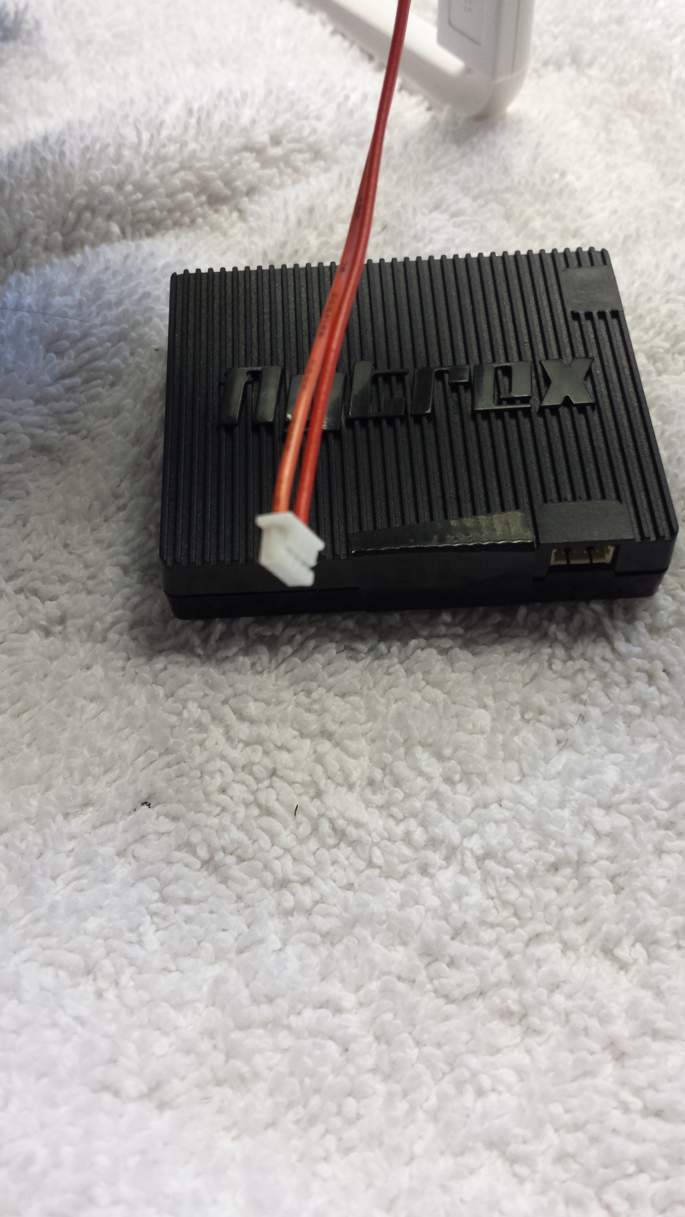

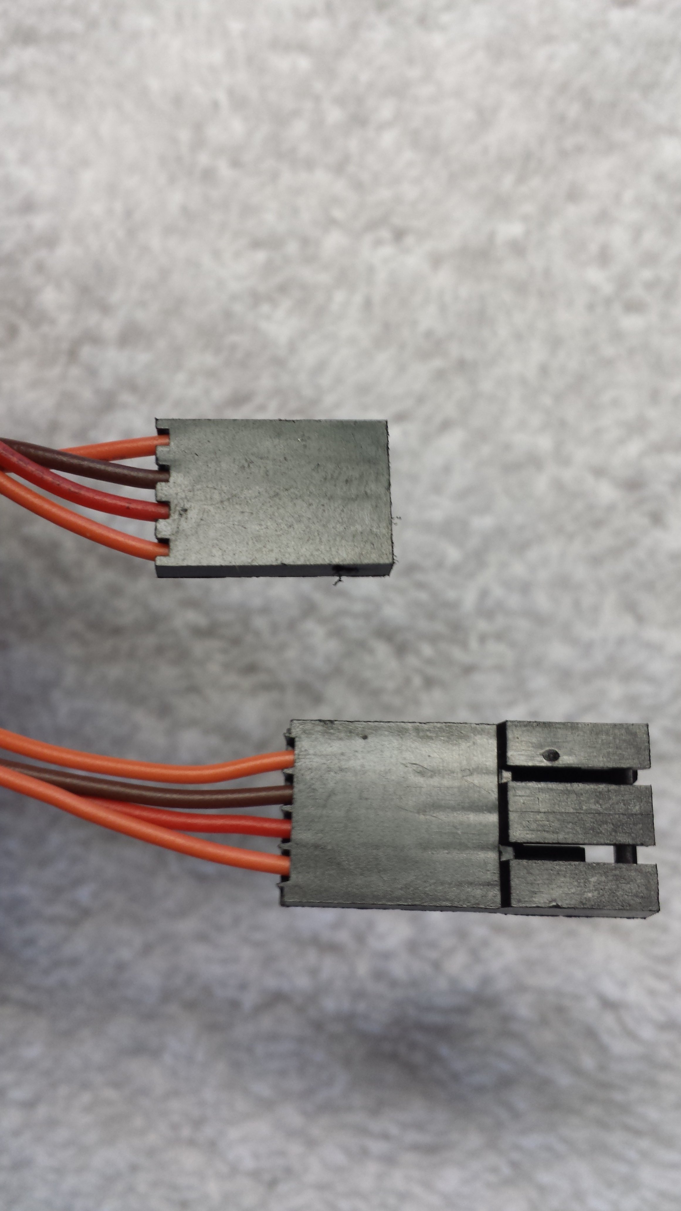

These are the only two ends other than the smaller white one that fits the Flytrex unit. Neither seem close to fitting in the canbus port in the Phantom.......scratching head.....thanks again!
Hi Mike :)
According to the picture you are using the basic installation cable (not the CAN-BUS Adapter) and therefore the wiring is connected via the GPS connection instead of the CAN-BUS. This explains why the connectors you were looking for on the main Phantom board do not seem to fit. :)
You can find the installation guide for the Phantom 2 Vision Plus using the basic installation cable (the same setup you have) here:
http://www.flytrex.com/support/flytrex-live-3g/phantom-2-vision-plus-installation/

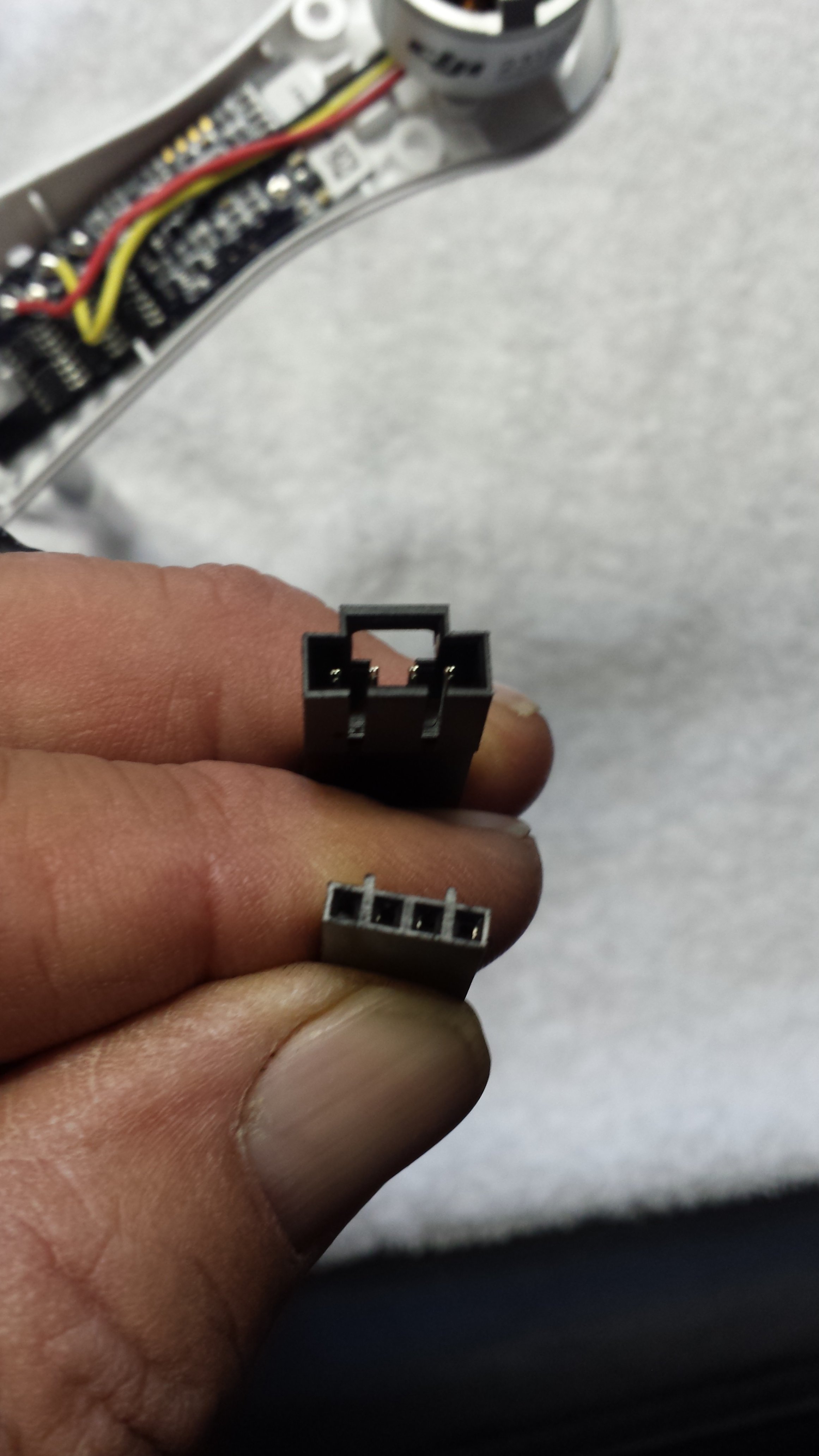

Thanks for the reply, Dirt!! I have a smaller white plug with a red and orange wire coming out of it on one end. This fits into the Flytrex unit. On the other end of the cable, the wiring splits and there are two connectors...the ones I thumbnailed above. Neither of those ends appear to fit over the port labeled CAN. I will attach 3 other thumbnails showing the ends and the canbus port....Thanks again for your help!

Hi Mike :)
Please see my previous reply on this with full details and with correct setup instructions for your setup.
Let me know how it goes. :)

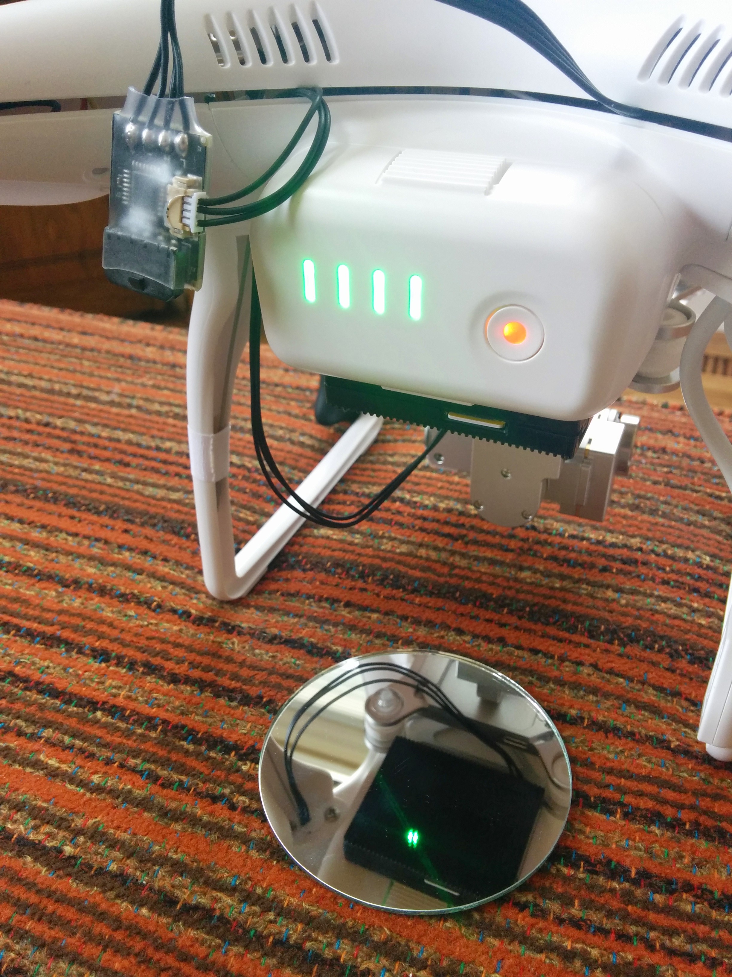

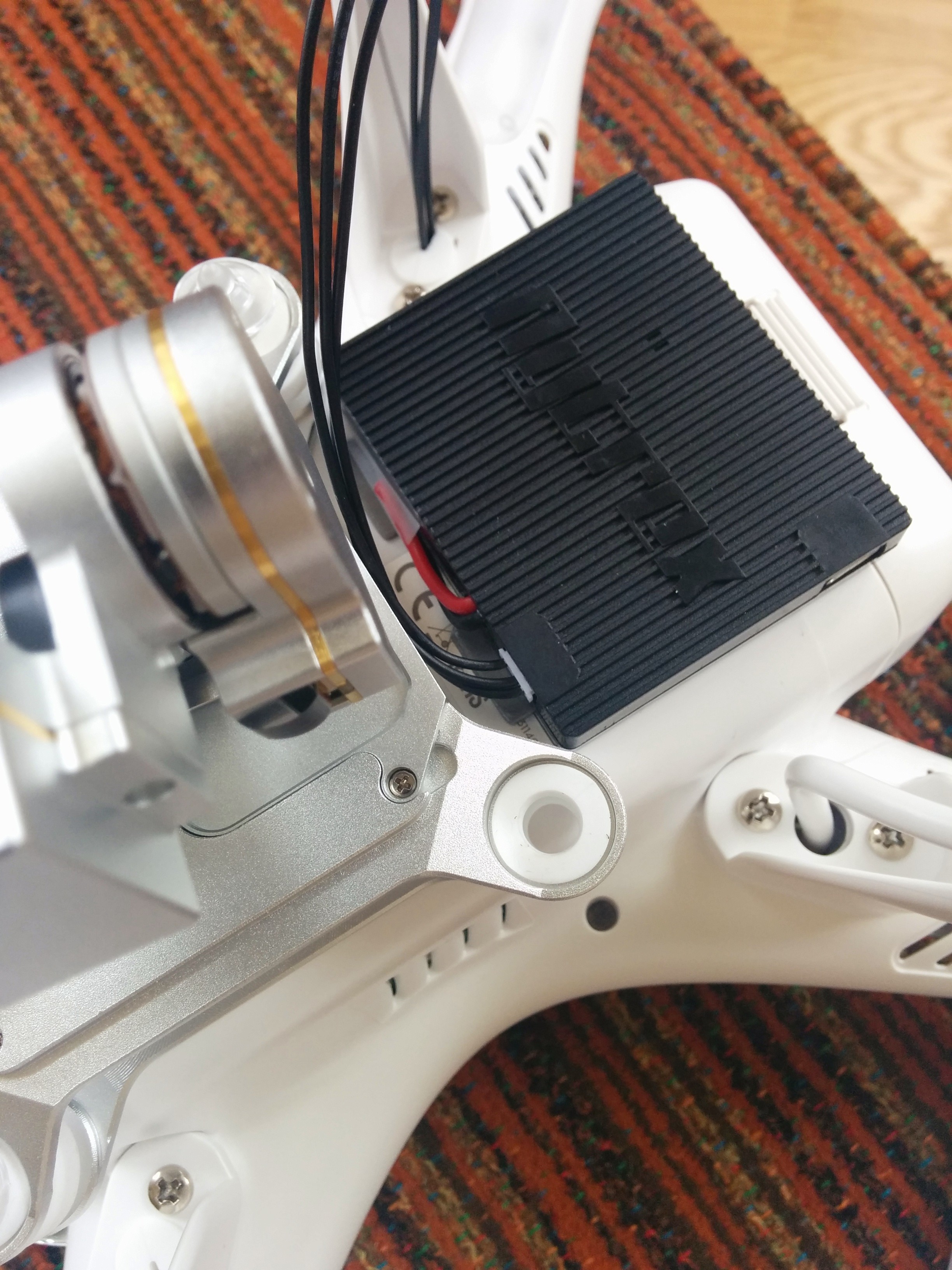

Amit, attached are three photos showing the connections. When I took the photo showing the CAN Bus Adapter the Phantom 2 Vision+ V3.0 was powered on.
The Phantom had a flashing green light indicating a good GPS signal. However, the Flytrex had a solid green light.

Thanks Scott for the pictures -- this definitely helps! :)
Technically, the Live 3G should start flashing green about 1-2 seconds after the solid green is showing, regardless to how many GPS satellites you have. It will flash green even if you do not have GPS lock yet. The flashing green indicates that data (any type of data) is being transmitted to the Flytrex server. Since the Live 3G transmits additional data fields apart from the GPS data, such as voltage information, compass etc., the flashing green should show right from the start, not related to your aircraft GPS status.
Looking at your pictures I believe your setup is correct. My assumption is that the CAN-BUS adapter is defective and that we will need to replace it for you. We will of course be glad to help with this and we will arrange this replacement quickly for free.
Before doing that, just one last thing we can try -- please try to push the connector of the black cable that connects between the Live 3G and the CAN-BUS Adapter a bit more on the side that connects to the CAN-BUS Adapter. Looking at the picture *it might* need to be pushed a bit further and this might also cause this issue, if this is the case.
To be honest, chances are pretty low that this is the case -- but it makes sense to check this before coordinating a replacement CAN-BUS shipment.
Let me know if this helped. If not, we'll get a new CAN-BUS Adapter on its way quickly.
