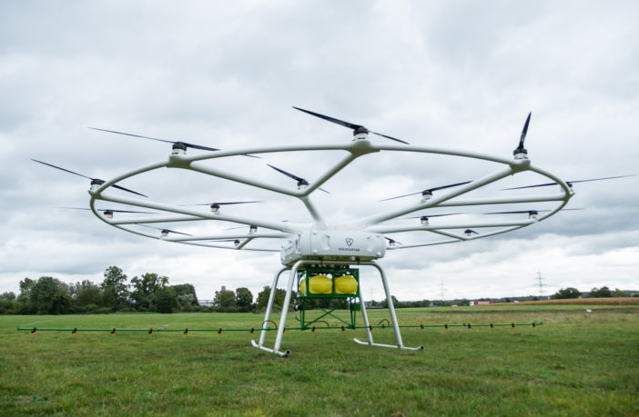

There is a guy on UTube that builds such things, but 50lbs is heavy, and I dont think that anything can be gained from such a design, that wont be gained from having a heavy lift drone carrying such a pipe, or other container fitted with a pump to spray out t liquid.
What you want to do, is done all the time with forest and agriculture spraying.
PS, you should also have sonar, to keep it at a uniform height, with varying heights of trees
Heavy-lift agricultural drone prepares for tests | Industrial Vehicle Technology International (ivtinternational.com)
You better be ready for such huge whopping drones, You will need licensing and a whole heaping lot of flight time for these units....oh, and deep pockets for the costs involved
