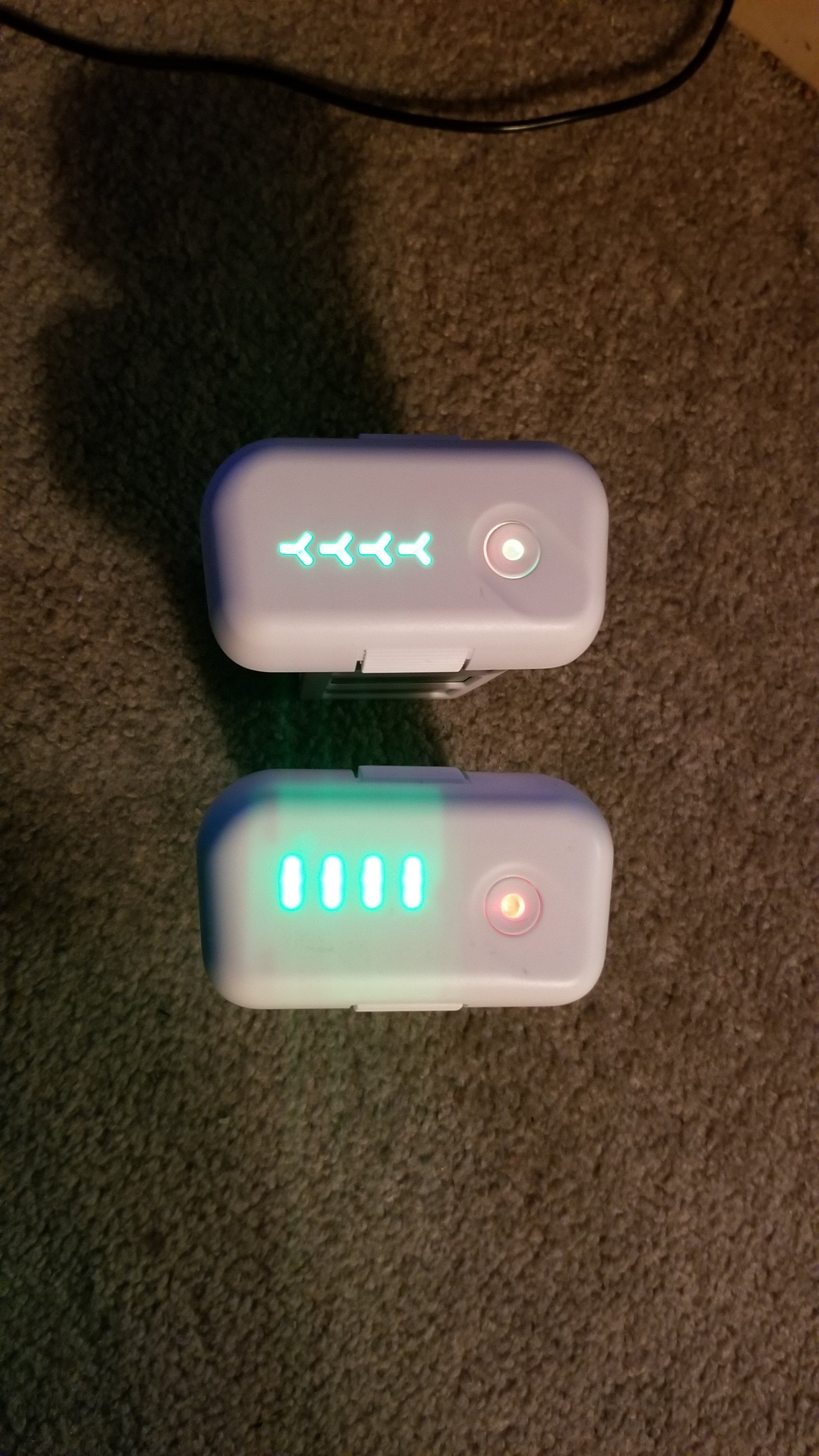

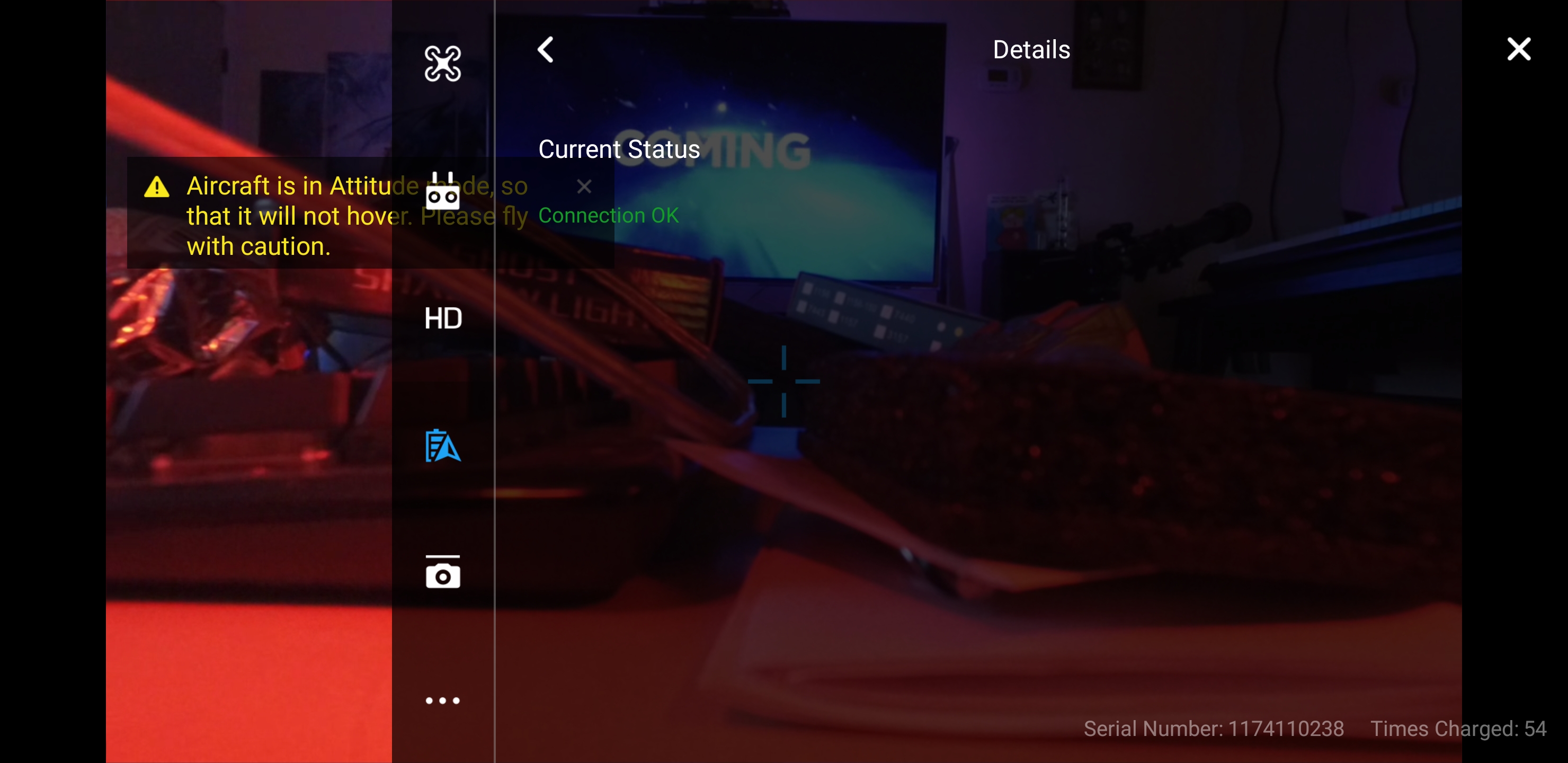

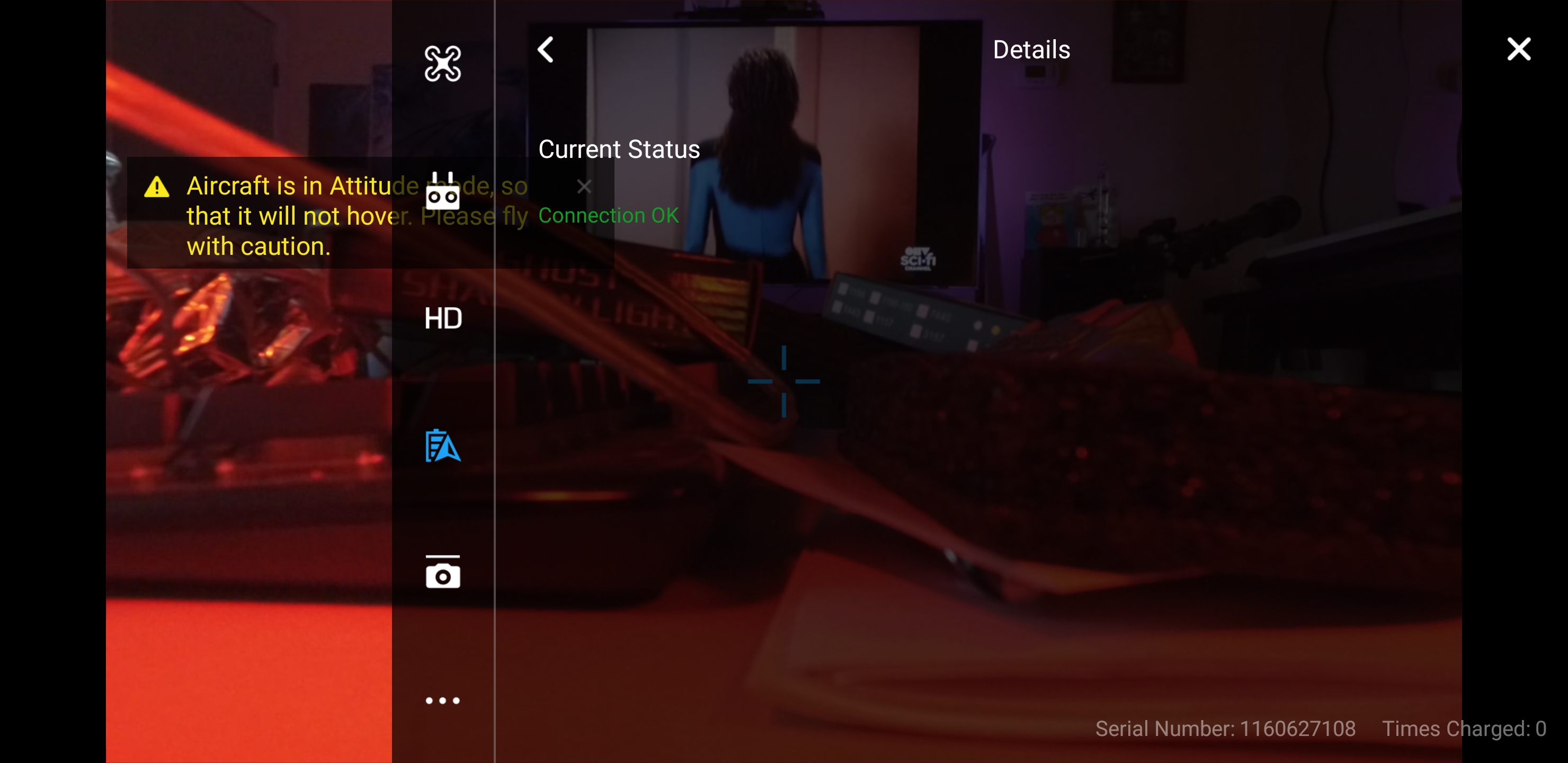

The new battery arrived today from Amazon. Had one solid led when I checked the charge level and it would power on but power off immediately. So I had no choice but to connect the charger with it powered off. Charged normally (I monitored charger temp and wattage draw while charging and it was typical as with the OEM battery). Once charged I installed it in my P3P checked the go app. Details in the advanced battery screen showed a broken cell error. All cell voltages were 4.29. Also a message on main status screen showing updates required. Put the latest FW version .BIN file on my SD card and rebooted. Yes I had a cooling fan running in anticipation of the update. Update finished flawlessly. Rebooted and no error messages as you will see in the screenshots that follow. I couldn't do a full test flight as the rain wouldn't cooperate but I got it down to 54% at 39C in flight with an outside temp of 6C. Cell 1 did drop 0.04 volts below the other 3 but nothing that worried me on it's first flight. After flight once the battery cooled abit all cells were exactly equal. It's definitely a different battery as you will see in the pics but so far error free and trustworthy. Money well spent I think. Check out the pics:
