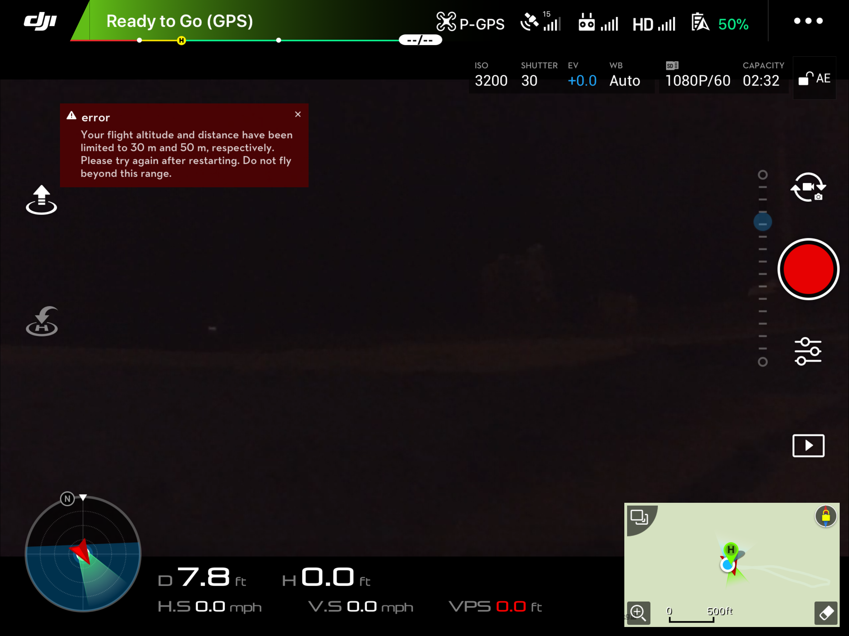

I’ve read all the threads on this issue and followed them for awhile now. I’ve seen what everyone has helped out with to fix this issue. Everyone is a great wealth of information here. I’m hoping you’all can help me finally resolve this issue. I’m ready to fly again.
I’ve done everything everyone said to do to get rid of this restriction to no avail. Log in/ log out, uninstall app, reinstall app, change batteries, fly, don’t fly, turn on, turn off, do it all again, excetra, excetra, and all the other stuff everyone and the videos said to do.
Current Software:
App:3.1.15
A/C 1.4.10
R/C: 1.5.80
I mistakenly updated the software which started the restriction problem. I was able to go back as far as possible for the app & software but I couldn’t get back to where I was. I didn’t see where I could go back any further from what I’ve found listed on here or the help document on here.
Original software was:
App:2.5.1
A/C:1.4.10
R/C:1.3.20
I have been trying not to update any software on anything since it has worked flawlessly since I bought it.
I’d like to ask again what are my options to fix this?
Is there a way to get my app and R/C back to my original software? This is 1st choice.
If not is the only other option to update everything to newest software? Worst option in my opinion.
Any help would be greatly appreciated.
Thanks
View attachment 92668 View attachment 92669

Thanks for replying with the well known regulations of flying these wonderful machines but you completely misunderstood my issue. If you reread my initial statements my issue is with a flight altitude and distance restriction of 30 and 50 meters respectively many of us here have had due to some sort of software mismatch or other issue. This has absolutely nothing to do with No Fly Rules or restricted airspace. I am not flying near an airport, over 400 feet, or near any other restricted airspace.
Not sure where in the world you thought I wanted to fly in the traffic pattern of my local airport or helo pad.
I get an error message of the altitude and distance restriction which is 30 and 50 meters respectively. That equates in feet to only 98 feet altitude and 164 feet distance. My drone stops when it reaches those distances so I cannot fly let’s say to 100 feet altitude. I’m sure you would agree here in the states we are allowed to fly farther than that. I am not wanting to violate anything. I would just like to fly to at least what everyone else can fly to.

I’m using an IPAD Pro 12.9” with IOS 11.2.1
