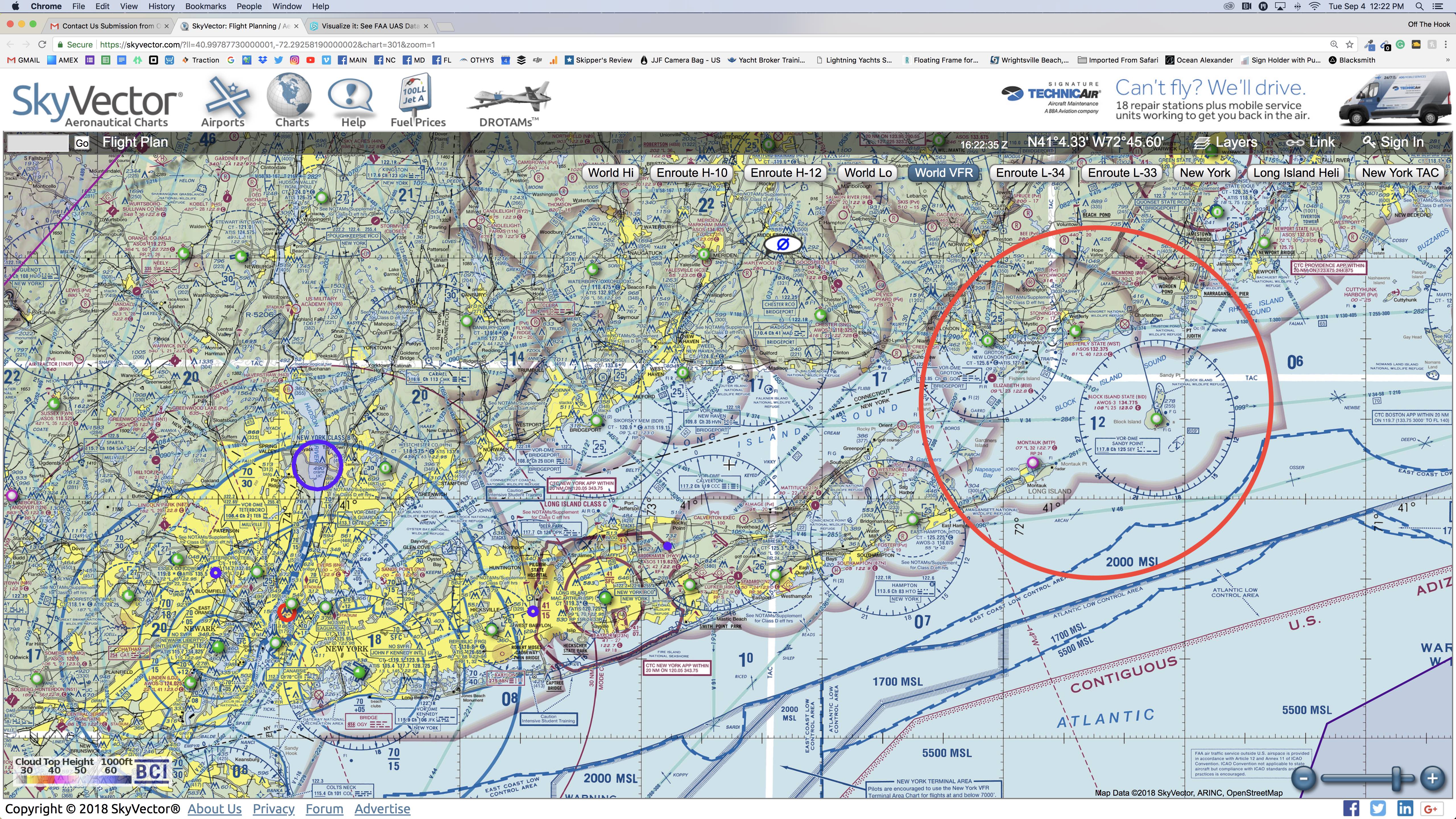

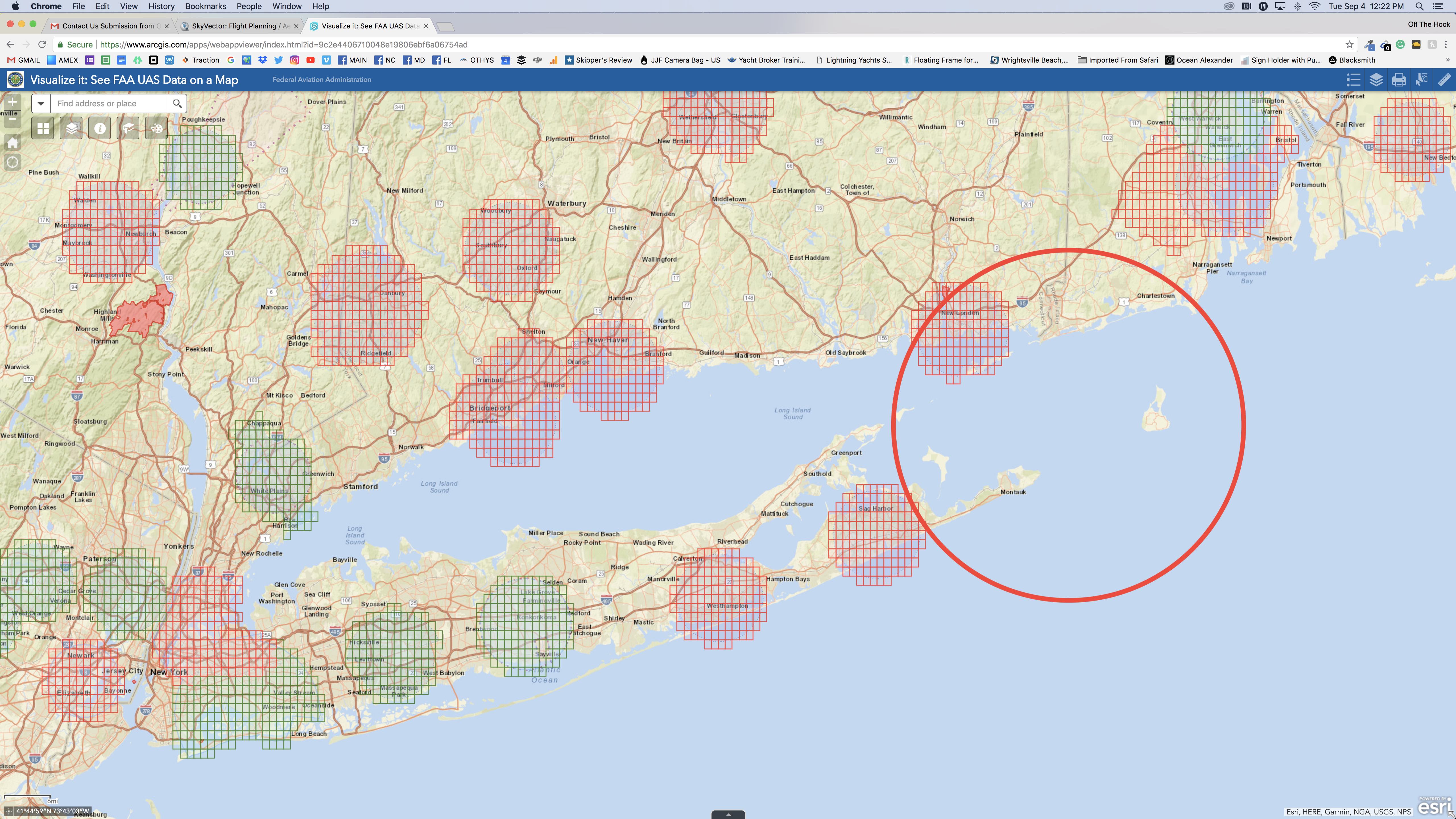

Why are maps so conflicting? This map I am viewing on the Visualize it: See FAA UAS Data on a Map is missing a couple of Class "C" Air Spaces. Compared to the SkyVector Map - that shows them.. how is this possible? Maybe I'm missing something - or don't have a button turned on?
Please view the screenshots below. Highlighted in red circles is the general area I am referring to.

Class C airspace is shown with a solid magenta circle / lines. The one you circle is a VOR (Sandu Point) / Class E (BID) airport as JRedman says. The other looks to be a Class D (GON) airport. You'll see a Class C toward the South West on your map for Long Island - ISP.
