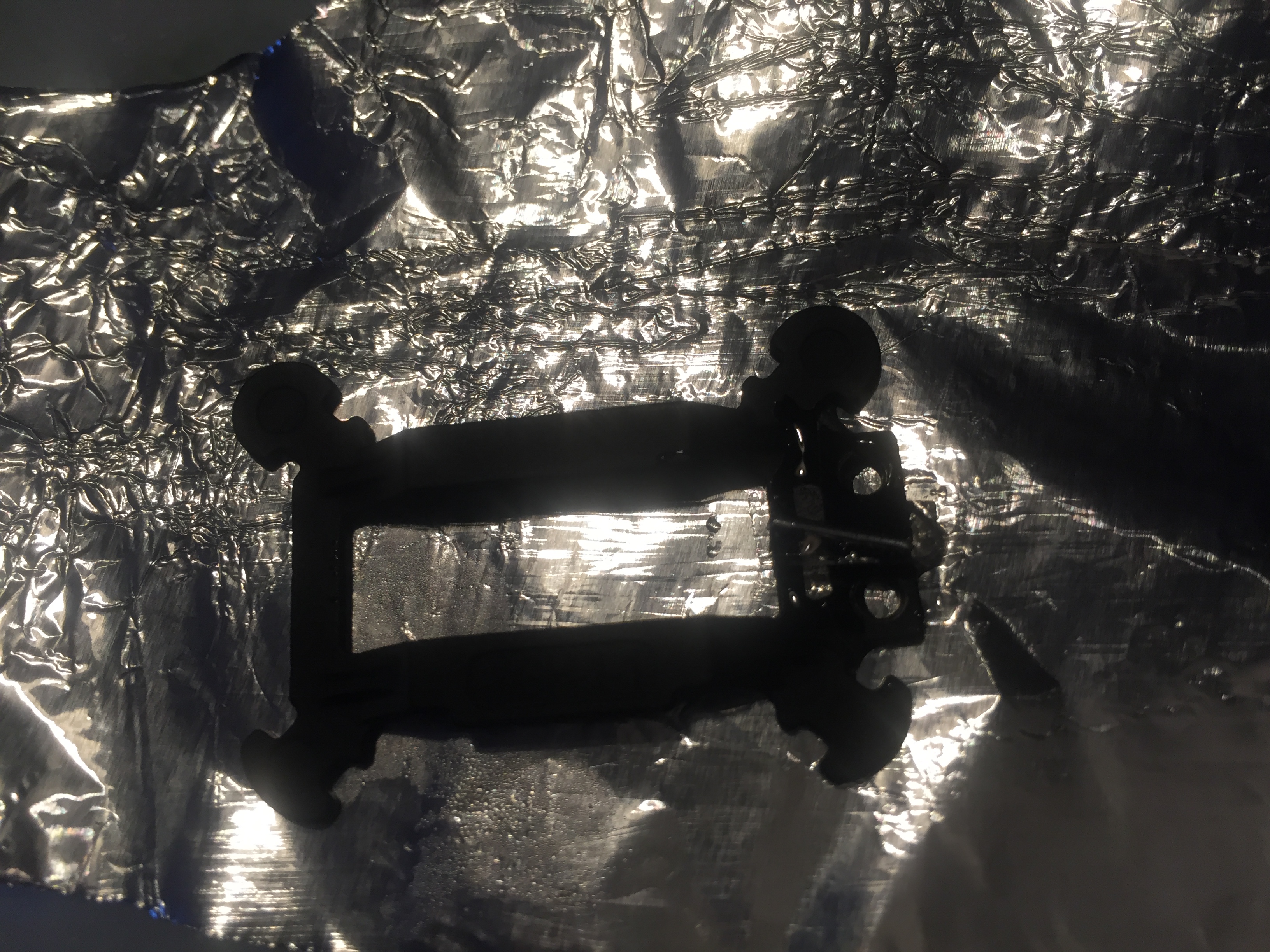

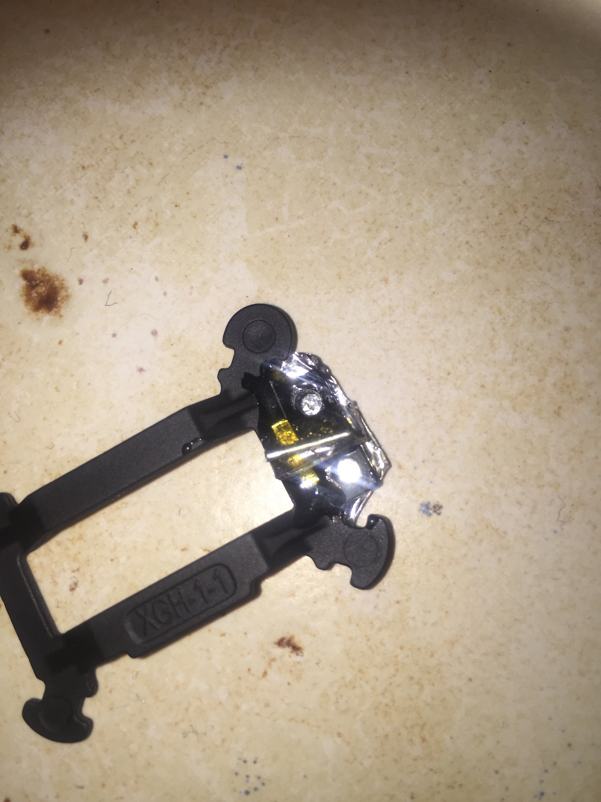

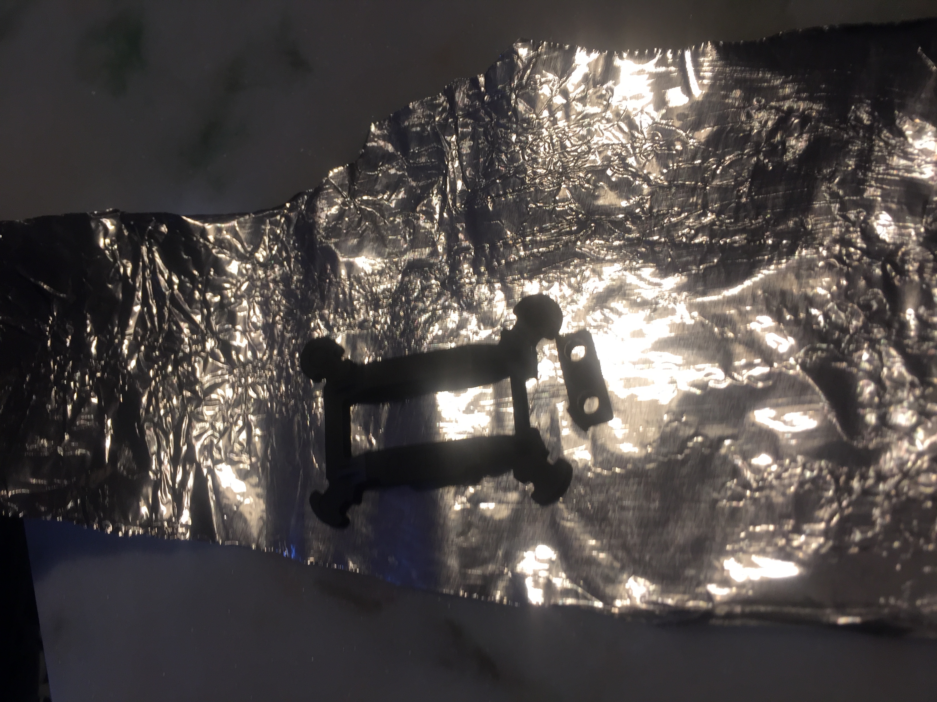

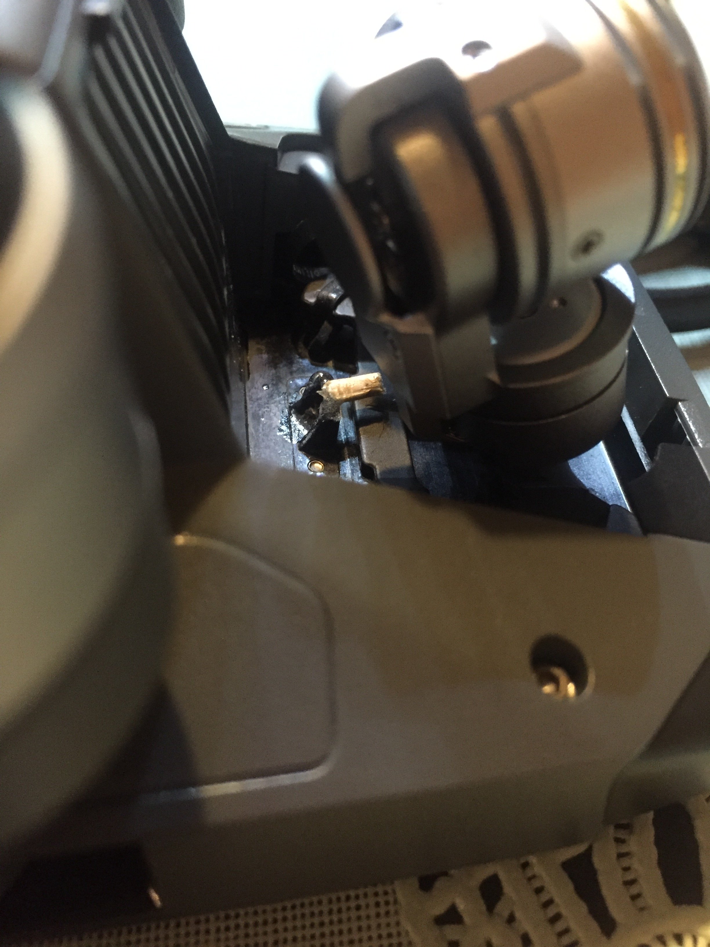

Had my drone 3 days, it wnent bananas and I had to kill switch it.
No worry as it broke camera gimbal -the aluminum plate that it hangs in rubber bands-. Used aluminum foil to make sure the plate was flat. Glue is epoxy and a small metal reinforced aria.
DID NOT REMOVE SCREWS FOR COWLING AND PLOMD.

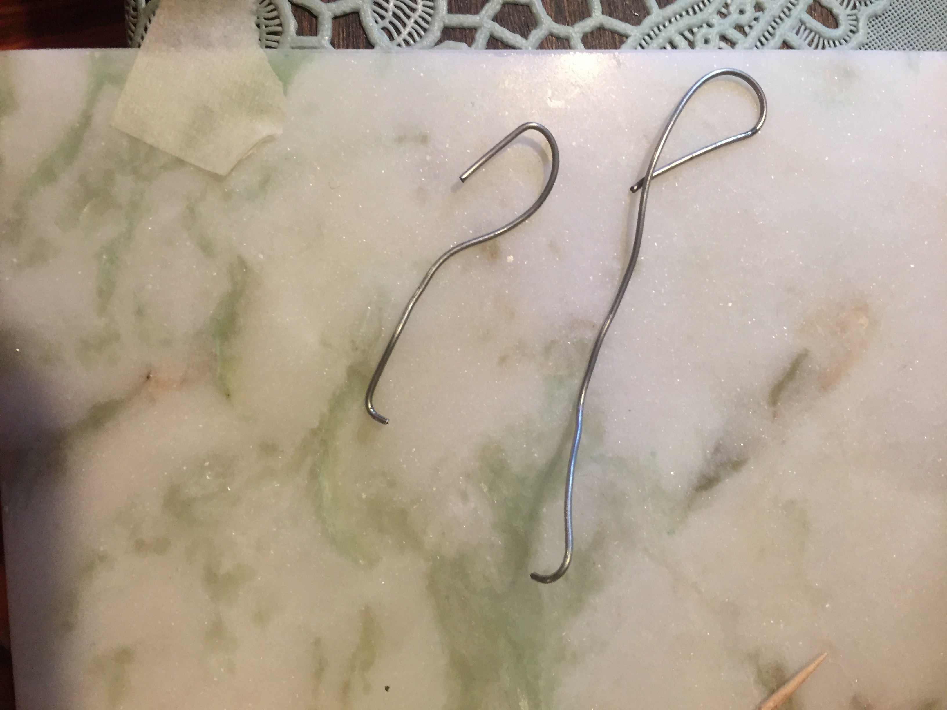

Made tools to remove and re apply rubber bands out of 1 mm gage neiwhire
Re calibrate was not pure, had to help motors before boot.
