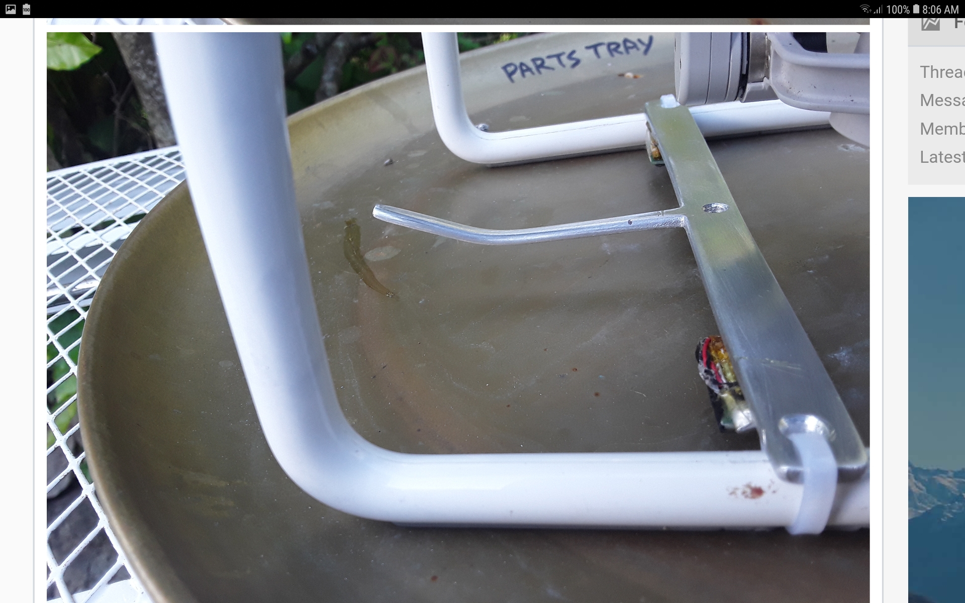

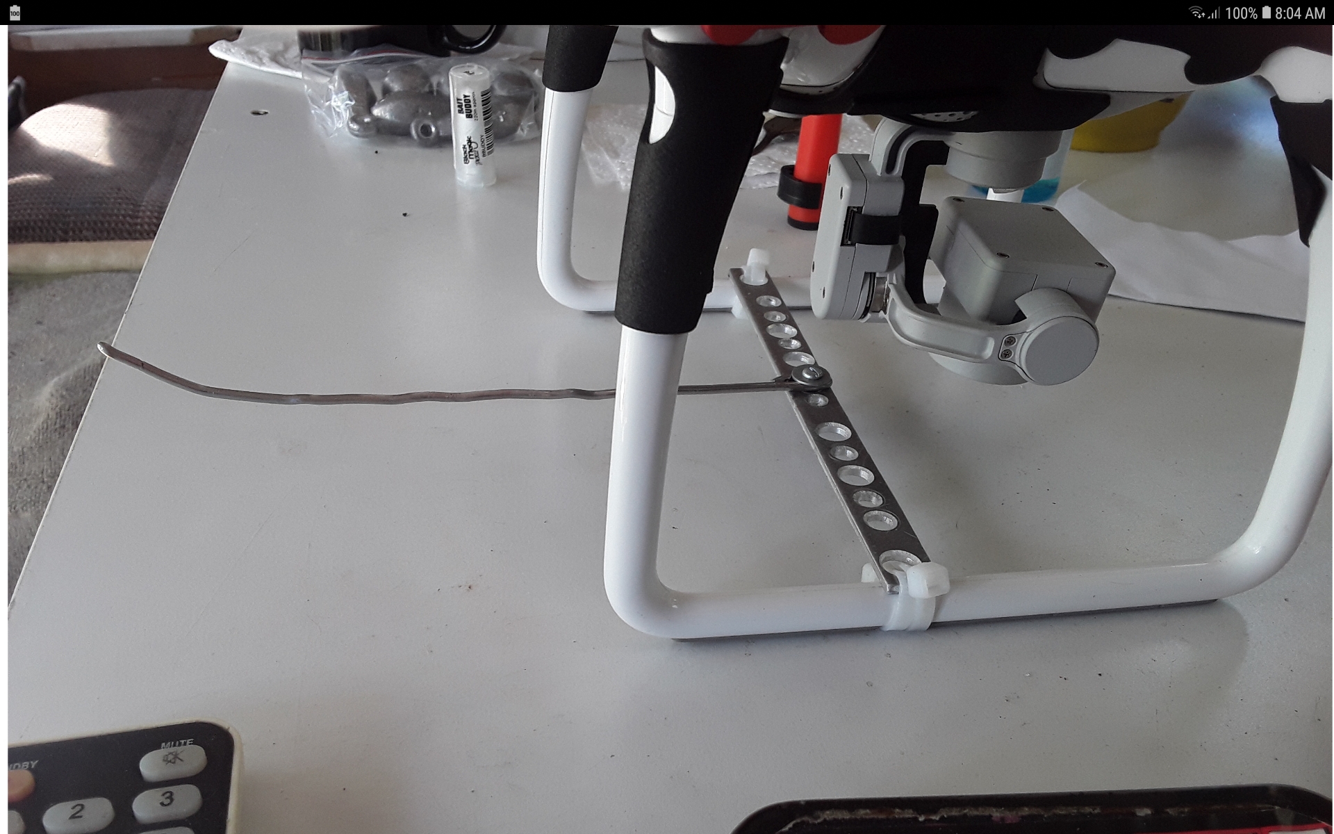

Me used this homemade dropper or swivel slider,,hover above ground clip on trace with swivel on rod,fly out,either stop tighten drag on surfcaster or fly slow when your our and tighten drag on fishing reel and line slides off the back,,I use braid aswell,6 once sinker 2 or 3 hooks depending on bait size,,great for getting past the breakers,,only 900ft is me furthest drop due to so much line behind the drone,,when taking line out must be confident and not stop and go or you might get tangled, even if no wind you might need to fly bit sideways depending on what the line behind is doing,,only downfall with this method is takes long time to wind line back in so electric reel would be perfect for retrieval,,,used this homemade thing so much it's great for me and it was free,no tangles to date,,ps,,i do use sport mode on the p4,,the p3s not as powerful as p4 so test some sinkers to see how your drone reacts in flight,,practice on the beach before you try real drop,,you become a master pretty quick
