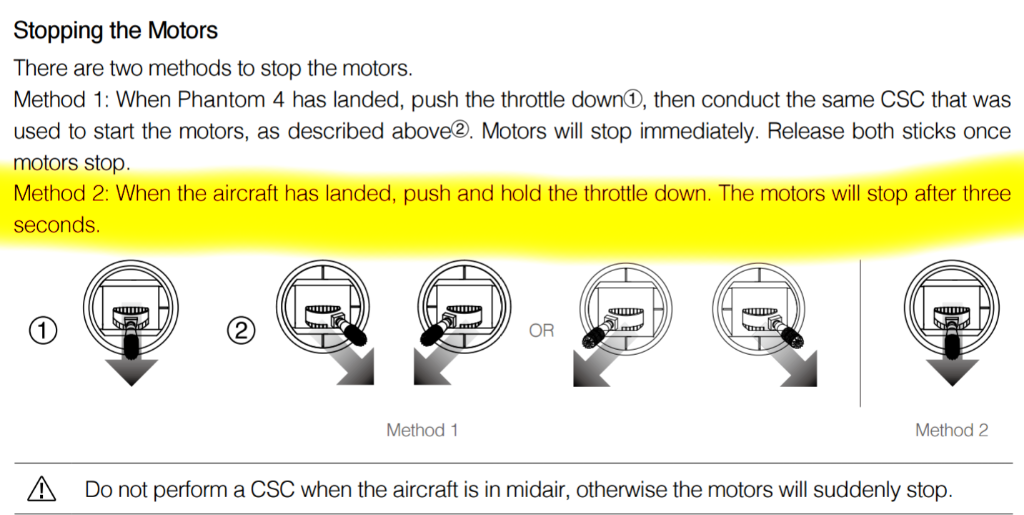

For me on my P3S when I hand catch, I hold the left stick straight down to shut the motors off, not down and to the right. Don't know if it is any different on a P4 but it works perfectly on my Standard.
not sure how it works on a P3S . but the motor shut down on the P4 is down and to the right .

I hand catch my P4 all the time in both GO and Litchi fpv, not sure if it makes a difference, but I hold the left stick straight down (and not to the right) and no problems. Once the drone thinks it has stopped descending, i.e. you're holding it nice and stable, it will shut down. Don't think the app has anything to do with it as you are communicating directly to the drone from your RC.
well it turns out I've been down and right since day one , so just went and looked it up in the manual and it's straight down . guess i've been lucky all this time . that may have been why the motors did not shut down this time . darn 67 Times with out issue and now i see i'm doing it wrong
Yes I was a bit curious about your method. Page 53 of the manual describes the two methods in which to do a manual shut down. You can only use the left stick straight down when hand catching unless you have fingers like ET and can do a standard CSC.

well it would not shut down for me . i held the drone and went through the motor shut down left stick down and right , held it there the motors slowed down but would not shut off . i had to go back to hover and land on the ground . maybe it's different for a P4. I to prefer to hand catch and hate having to land on the ground . it's so mush easier to hand catch and much less stress on the bird . I wish i had your experience with Litchi mine has not been so smooth . 2 flights with Litchi and both times something did not do what it should have . will keep trying till it's right or will drop it . only time will tell
It's not left stick down and to the right. It is just left stick down. Either way this is not something any app controls,it's in the firmware. You can launch, fly and land without any tablet or phone at all.
Nope. Maybe this is why you are having problems with Litchi? You are not familiar enough with the Phantom itself?
Nope. Maybe this is why you are having problems with Litchi? You are not familiar enough with the Phantom itself?View attachment 83110
Correct . i found out i was doing it wrong for 67 flights . though never an issue in shutting motors down i will be sure in the future to go stick down ! this must have been what happened last night . can't believe it worked the way i was doing it for so long .Guess i'm lucky
