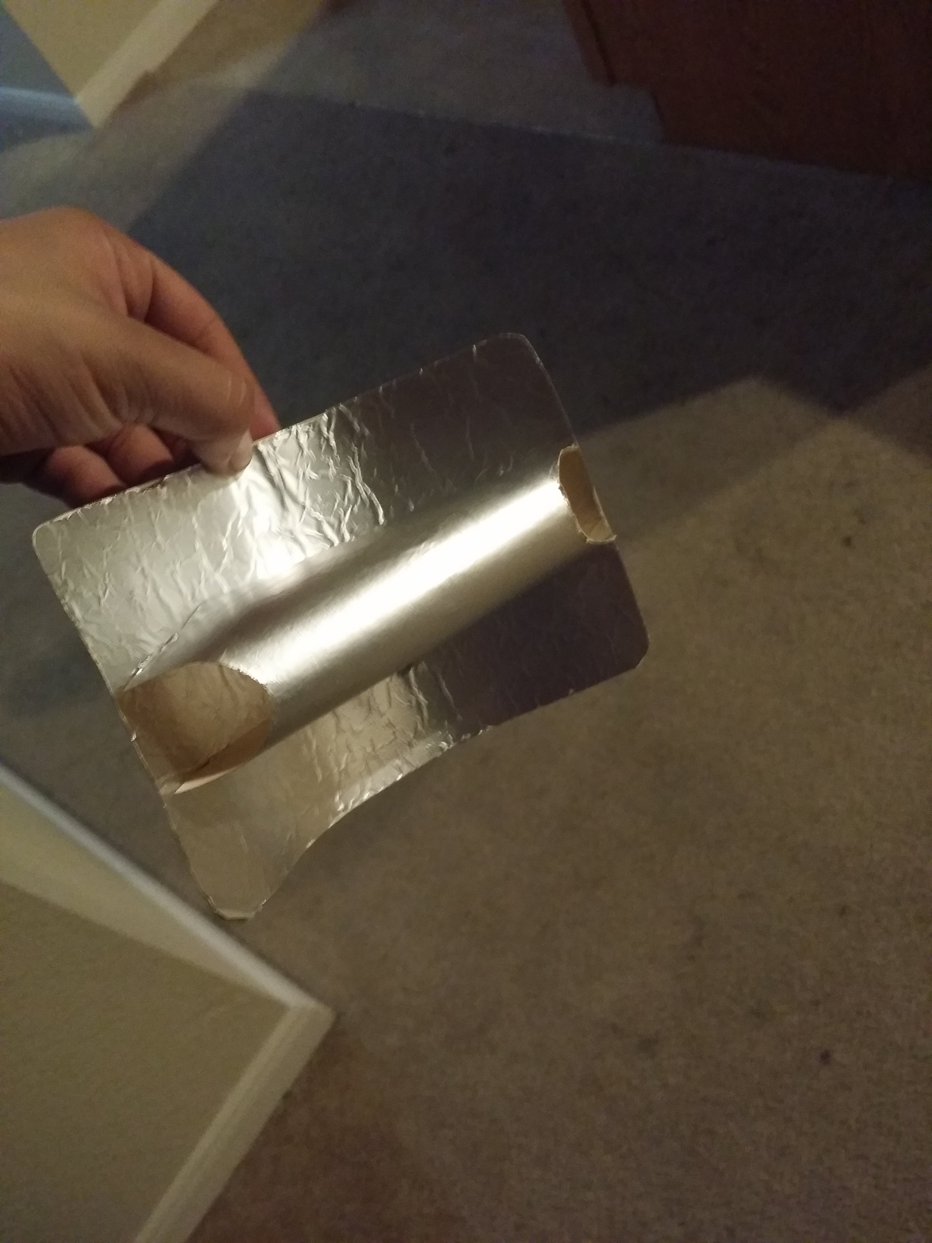

I have had my P3S for two weeks and have 10 flights so far. I don't know how you guys are getting that kind of range on a standard set up. Flying from my house ( lots of power lines and wi-fi around I could get out to 650'. Then I went to an open field and could not get past 1,000'. I am going to try a windsurfer to see if I can get any more range.
I get 2500-3000 with windsurfer and it is the standard
I did it from antenna - Tom's Tech Time and used i little harder paper and owen folie from the local food store :)
Ill look into it but looks prety much the same

Today I was able to get 4250' from my driveway with nothing but what came out of the box. I lost video about 10 seconds before I lost RC. 3 seconds later it performed an RTH. I think I'll be getting some cardstock and aluminum foil to see if I can increase that a little more. On the plus side, I did discover a graveyard that I did not know was there. If it wasn't for the trees interference, with that range I could fly it to my parents house from mine. As the crow flies, or as the quad flies.
