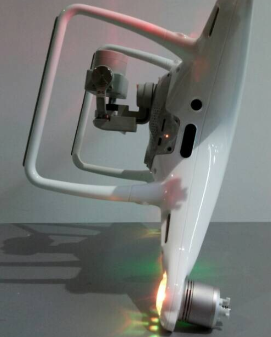

I have gimbal twitch and "gimbal overload" warning/error.
Also, how long should it take to complete a Gimbal Auto Calibration? It took almost 30 minutes.
My gimbal calibration takes a 2-3 minutes, have you tried doing the calibration with the AC positioned like this.
This was recommended by DJI support
