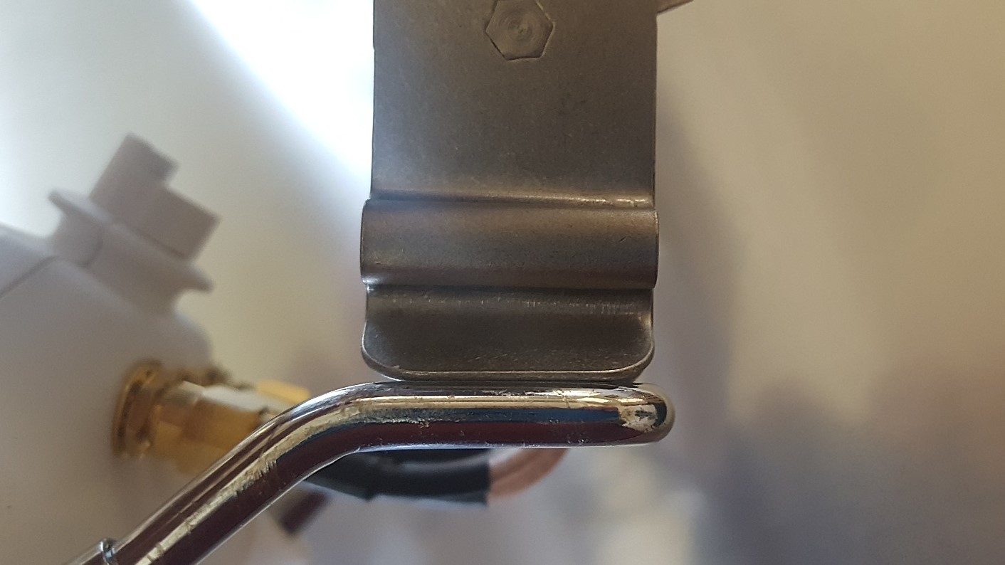

Also, now that I see yours, Yours seems to fit on the chrome bar much better than mine. Mine is a little too wide and doesn't snap all the way into place. Is this a defect? Should I look to get a replacement. I bought it from Amazon.com
Take a look:
Something definitely isn't right there. I would email itelite and show them your pics. Ask for a new bracket.
That's what I thought. I sent a message today to the amazon.com seller. If I don't get an answer in a day or so I will email itelite.
looks to me like it just has to be pushed further down the handle/bar. its like its pushed on where the handle bends?? that would change the angle of it also. thats what i can see anyway
It's hard to see from that original picture, but there is no place on that chrome bar that it fits without getting into the bend of it preventing it from snapping all the way on. I took another picture. Maybe this is more clear.
Feel free to show them my picture, If you want.
By any chance, can I ask you to measure the width of your bracket in the same way that I did? Mine is between 7/8" to 1" wide. Your looks significantly thinner.
Thanks in advance..
Agreed. my bracket is much smaller
So i suppose youll have to look for a replacement bracket or if you can cut it yourself.
I would cut myself, i wouldnt have the patients to wait for a replacement
So i suppose you'll have to look for a replacement bracket or if you can cut it yourself.
I would cut myself, i wouldn't have the patients to wait for a replacement
Well, since the seller hasn't answered me yet, I think I will probably fix it myself.
30 seconds on a bench grinder should do the trick.
Thanks for your help.
No problem glad i could help someone atlast [emoji5]. you'd wonder why its so large though. Anyway if you cut it it should point at the propper angle coz as is,its just way too high
