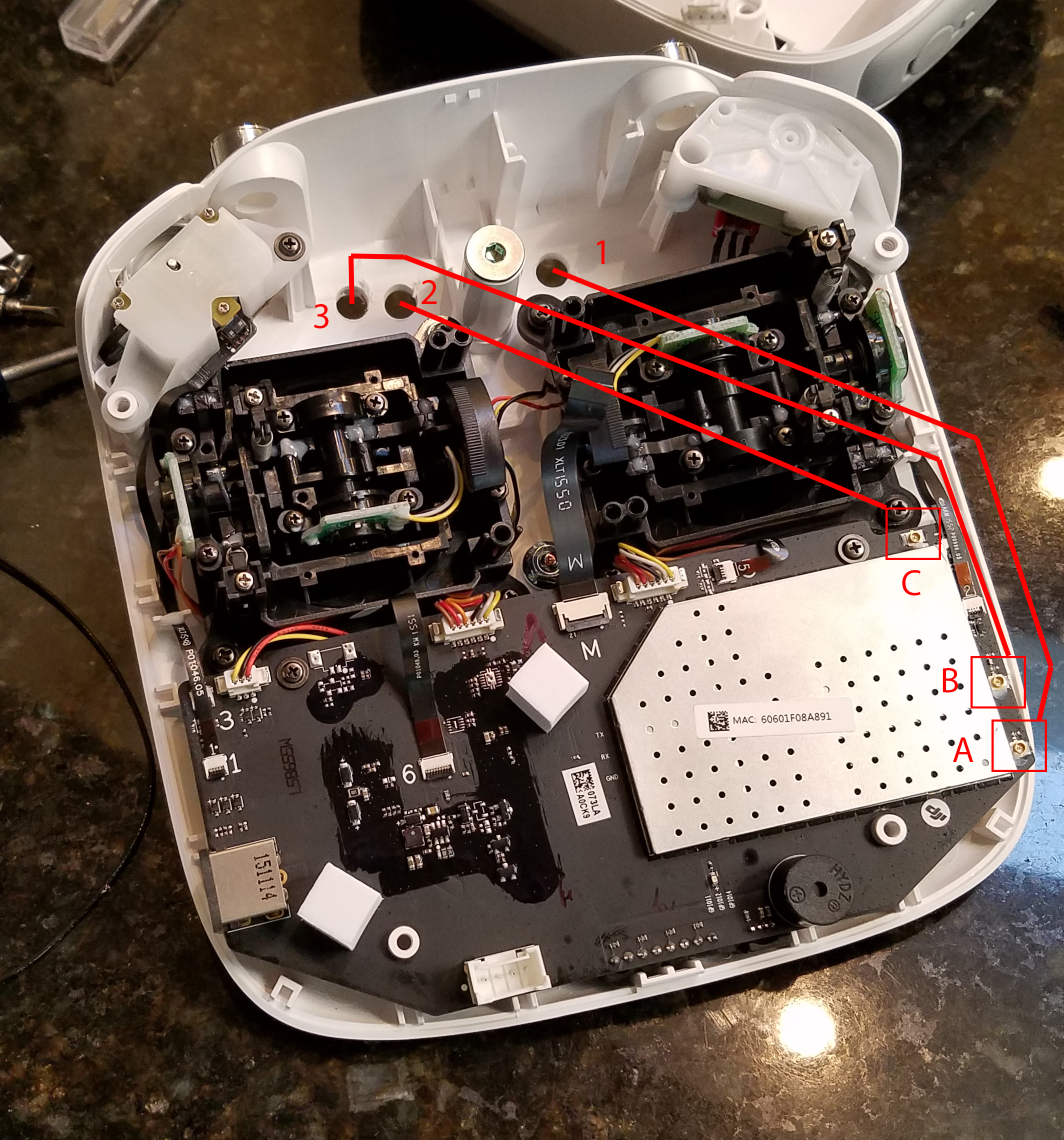

So I got my ITELITE ITE-DBS01_v.3 - DBS PHANTOM ANTENNA in the mail for my Phantom 3 4k and as expected, it came with zero instructions. I haven't done anything like this before, so it is above my head and I'm in deep waters here.
So when I took out the old antennas I didn't keep good enough track which cables went to which ports on the RC, and had to do a bit of guess work on where the new cables go.
Also, does anyone happen to know what will happen if you plug the wrong antenna cable into the wrong port, either on the RC's motherboard or into the wrong jack on the ETELITE itself?
Here are some pictures of how I currently have it laid out, with reference letters / numbers for easy referencing.
I just am trying to determine if I have the right cables going to the right places. My drone powers on and fly's without errors as configured, however I'm seeing zero increased range. Perhaps slightly LESS range than my stock antennas.
Any help for someone way over their head would be appreciated lol

https://dl.dropboxusercontent.com/u/53659147/drone/RC1.jpg
External
https://dl.dropboxusercontent.com/u/53659147/drone/RC2.jpg

#2 is 5.8 and goes to port 1 on the panel

I think c should be number 1 doesn't look right to me just wait he will jump in soon he is allways on here
Reactions: dirkclod
yep c to number 1
Reactions: dirkclod
I think we have a bingo
Reactions: dirkclod
You are saying the hole I have labeled 2, which I have plugged into motherboard port "C" currently, goes to the "Port 1" on the external ITELITE box?
Yes
Reactions: J Dot and flpholt
**** I don't have it like that now, I'm certain!
So if this is the case, you are saying I should do;
C -> 1
What about A & B? Which panel ports do they plug into.
don't matter
Reactions: J Dot
So as long as "C" goes to Port 1 on the ITLITE, the other two are interchangeable. Ok, going to go test this out. Will let you guys know, thanks a million.
