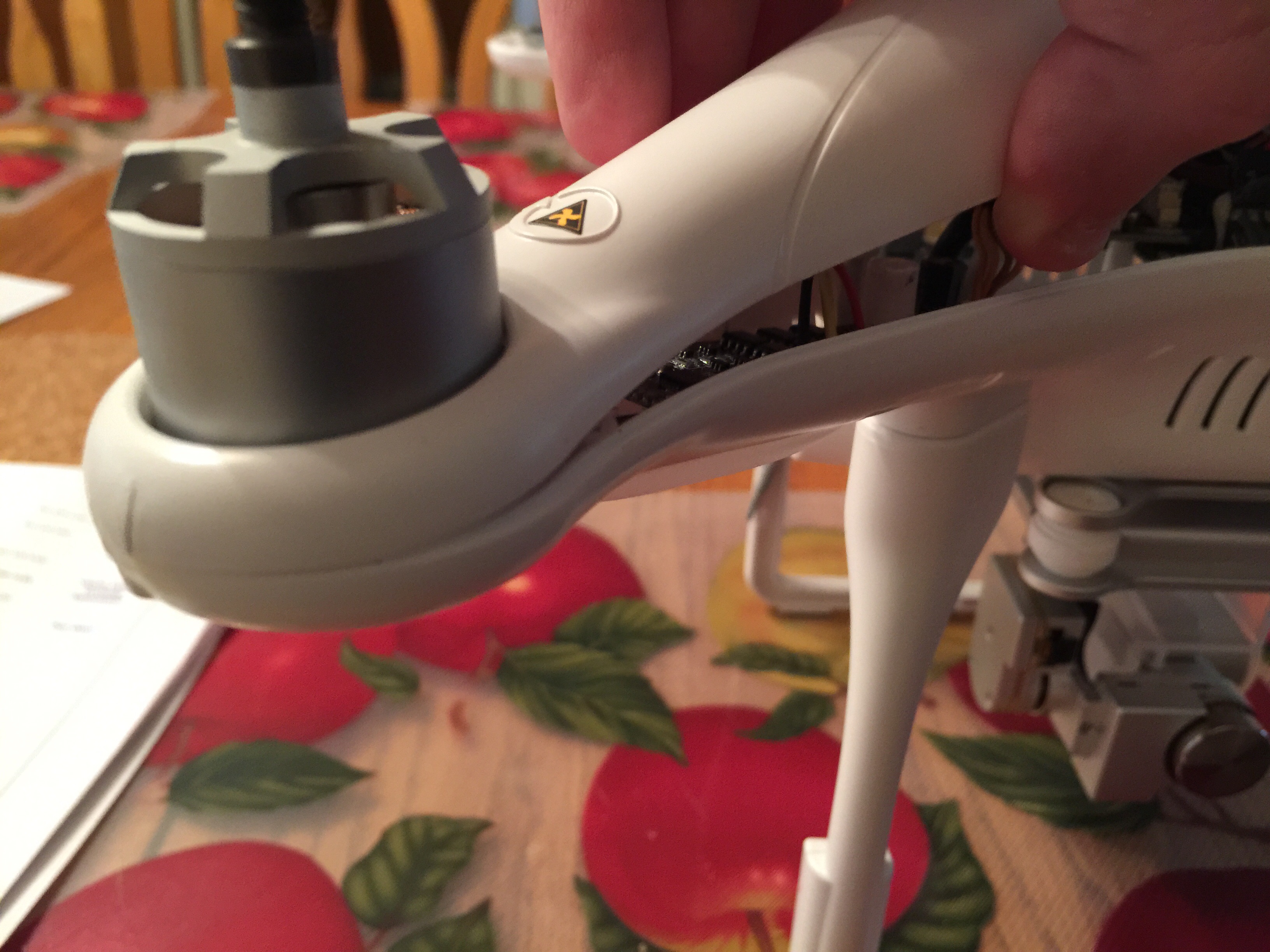

image.jpg image.jpg I've bought 2 from Hunch but had very different results. The first one was like new and I was completely happy with it. The second is a different story. It turned up after 8 days without charger or tx. Hunch said that the tx and charger will arrive separately but will not give me a tracking number! The phantom it self is not flight worthy in my opinion. I used to work for a DJI dealer in the UK and I built and repaired all DJI products so know a little about the phantom. The shell has many cracks in it and has been glued back together, the camera housing actually still has mud on it from its previous crash. The camera lens surround has chips around it. I understand these are used but I was under the impression they were refurbished and by that this unit should have a new she'll fitted at the least. I can't test it because I don't have the tx yet but it's not looking good so far!

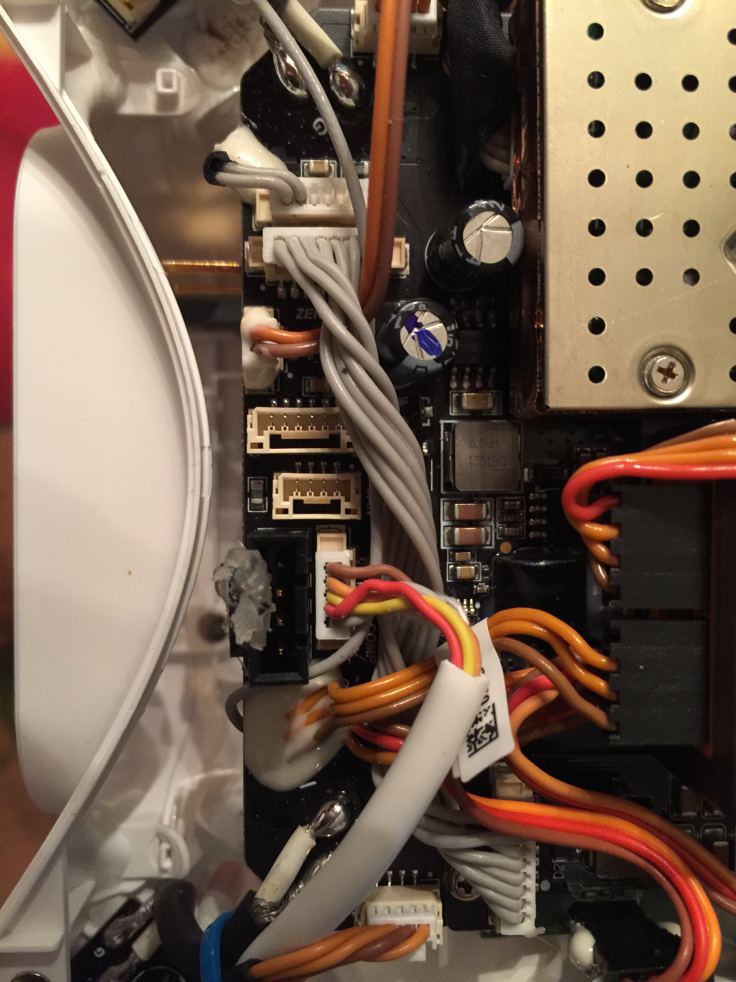

Received the tx and charger so I was able to test the phantom. First issue was no telemetry from the bird. Traced that to a bad connector so that needs replacing. Removed top cover to find it was glued together on the damaged arm! Once in I found hot glue actually inside the gps connector which is not good. A couple of dry solder joints on motor to esc wires. Found a dent in the RF module and cable ties missing from esc cables. Flight controller was not stuck down straight either. It also has and old main board which is not from a V3 but they are all the same so not bothered about that. Gimbal savers are also missing. Battery does not fit very well but that could be either the battery or the lower shell.
Very disappointed with this. It can all be fixed but I didn't realise I would need to spend more on it. Hunch seems to be ignoring me but he's never been the best at getting back to people!
