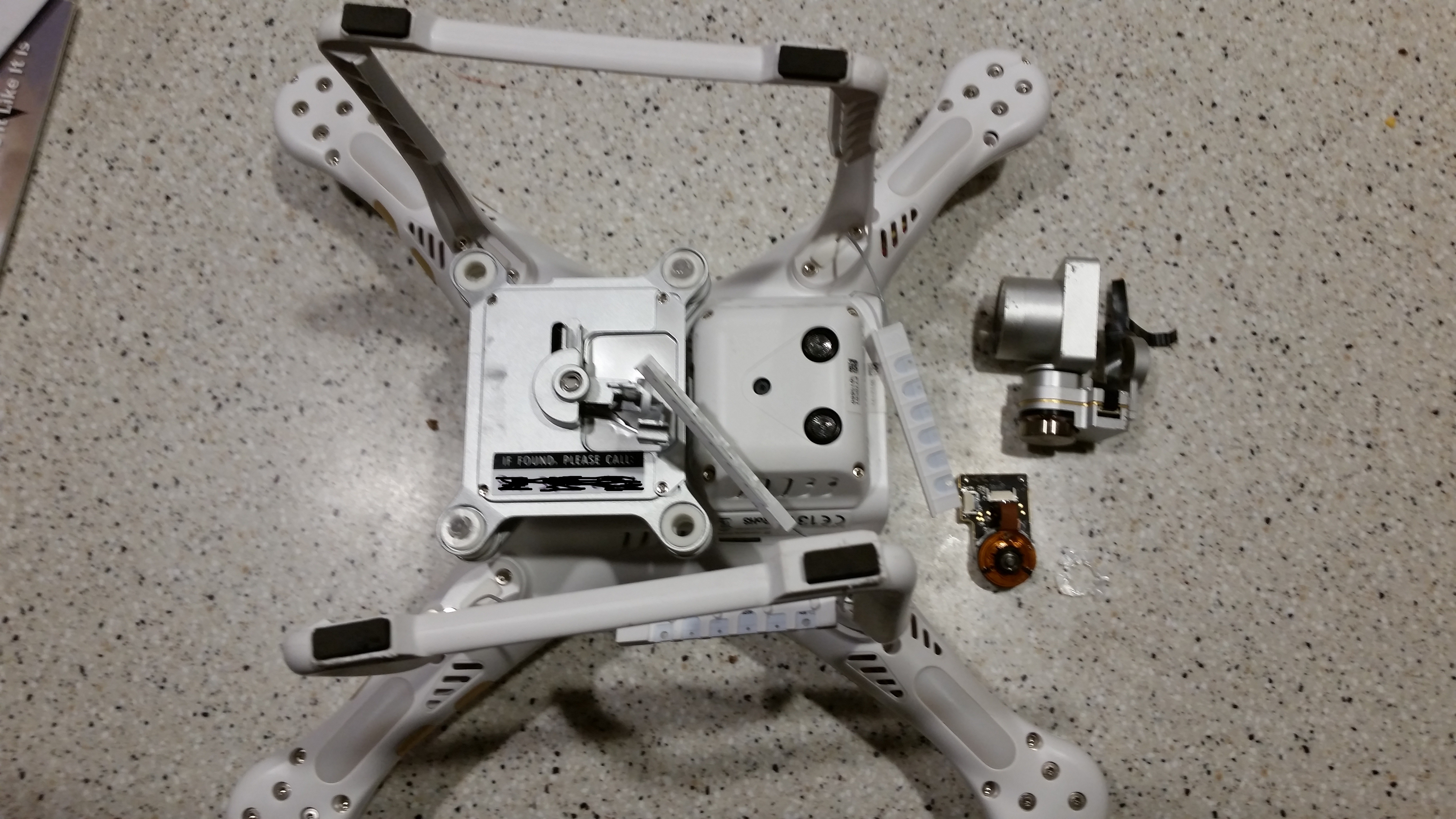

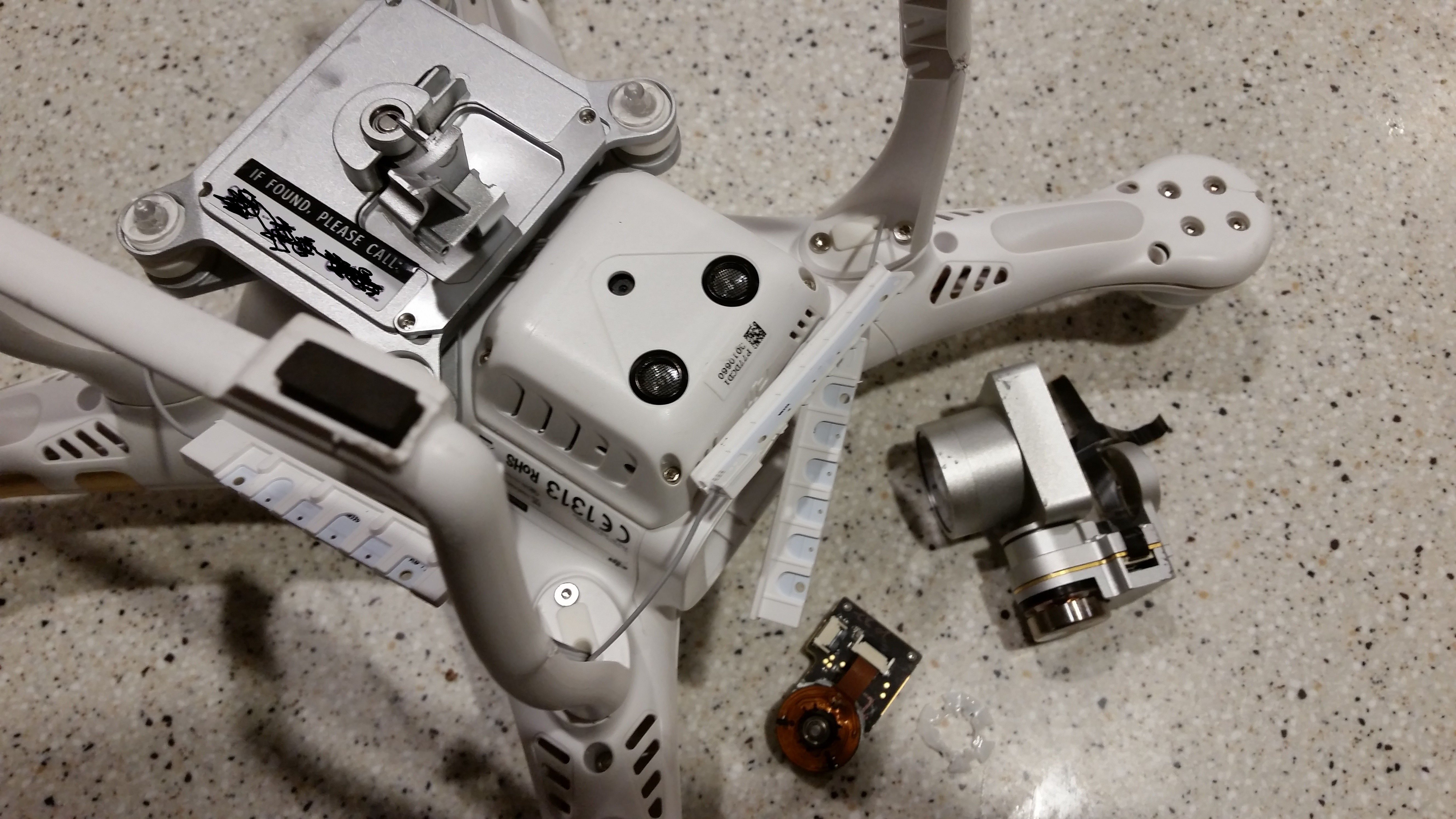

Flew my Vision Plus for about 7 months and bought this P2A on release date. Never had any problems... until tonight. Wanted to get some night shots so I drove out and got permission. Set drone up and waited about 45 seconds for it to warm up. Started the motors and got a home lock. Manually launched about 30' in the air and hovered for about 3 seconds. All of a sudden everything shut down. No motors, no lights. Fell right down onto the parking lot. Battery bounced out, camera was ripped off and landing gear was bent.
View attachment 37695 View attachment 37696
