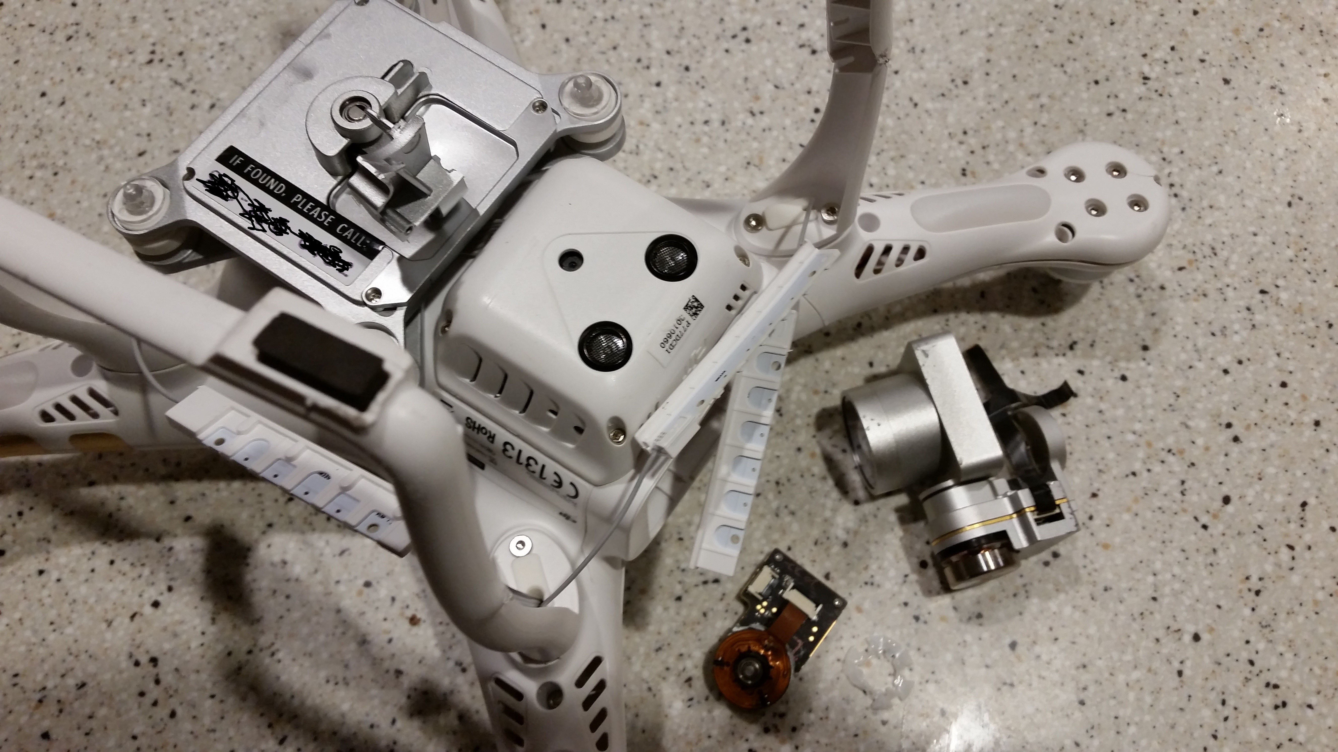

Flew my Vision Plus for about 7 months and bought this P2A on release date. Never had any problems... until tonight. Wanted to get some night shots so I drove out and got permission. Set drone up and waited about 45 seconds for it to warm up. Started the motors and got a home lock. Manually launched about 30' in the air and hovered for about 3 seconds. All of a sudden everything shut down. No motors, no lights. Fell right down onto the parking lot. Battery bounced out, camera was ripped off and landing gear was bent.
I've posted the photos of the damage and here is the link to the flight logs.
Nothing to see as I read it as it was only in the air for about 5 seconds. No errors.

This happened to me also , battery was around 68% took off hovered for a few seconds then flew for a total of around 23 sec , then plummeted to the ground from around 20 odd feet.
the camera broke off and the leg snapped . I had 5 people watching who can verify that it just came down in an open field.
no logs but I have a part video ( up until it went down) . I then flew it twice for over 5 mins (without the camera) to check if the battery was at fault . I had no problems and logs were created.(so it wasn't the battery !) Its been sent back to the shop and has been away for over a month now
what should I do ---- any help
60% battery shouldn't cause a drop off, If that is the case, the low battery warning should be set at 99%.
See finally we have found a flaw in the battery FW. That was the point I was making it earlier.

After a minute or 2 I got alarm and battery failure on the APP. Landet after couple of minutes and discovered that the battery was not properly installed. It was 3-4 mm out of its cradle not snapped in and locked. It would be hard to find the failure if it crashed! Better preeflight is an option!
Reactions: John N Kronyak
I think when this problem first surfaced (not just in this thread but other threads too), most of us thought the problem had to do with a not-fully-charged battery being used for flight. After all, DJI says to always use a fully charged battery before each flight. But if one reads through this entire thread and other threads like it - it seems likely the drop from the sky problem has something to do with the auto-discharge of the battery used.
In other words, it seems the battery, for some reason, sometimes shuts down during flight if it had previously entered auto-discharge and then was not fully charged prior to a flight. On the other hand, if one uses a battery, brings the craft down, turns it off. And then uses the battery again that day, it is fine - even if the battery is significantly less than a full charge. Many pilots have said they do this all the time and have never had a problem.
The problem seems to be related to the auto-discharge. And as already stated by somebody somewhere, the auto-discharged battery comes out of auto-discharge the moment it is turned on. So the problem is not that the battery is in auto-discharge. The problem is the battery had been in auto-discharge.
Fully charging the battery solves the problem. Would partially charging the battery solve the problem? I don't think we know yet.
