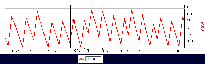

The only thing I can add to this is that the sample rate of the .txt is just too low to really tell the difference between CW and CCW. Here is an incident where a propulsion issue occurred and the P3S was rotating CCW.

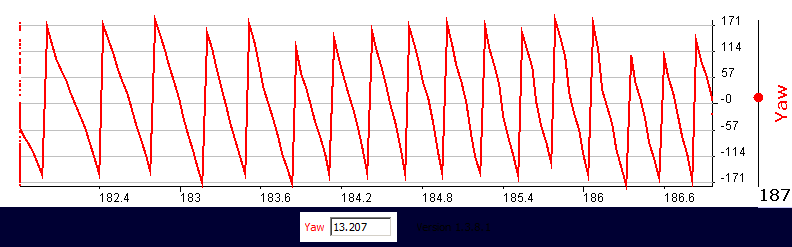

This plot was generated from 30 Hz data. The same data sampled at 10 Hz (the .txt file sample rate) produces this plot
I can't really tell if this is CW or CCW.
Agreed, but in this case the direction of initial rotation is clearly captured at the 10 Hz sample rate. It then transitions into full 360° rolls, with more minor excursions on the pitch and yaw. It's not quite like the usual spin following motor loss. It's almost as if it lost two motors.

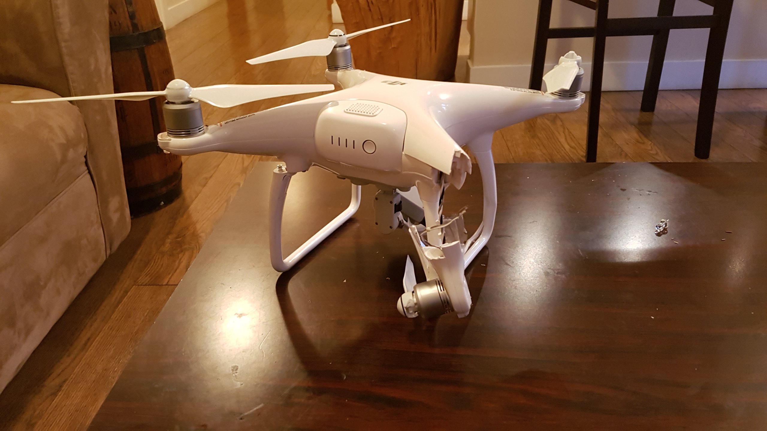

I just rebuilt a P4 with more damage because the camera yaw arm was also broken off. The owner said the same thing, that it dropped from the sky from about a 100 feet. When I disassembled it, I discovered a ribbon cable that connects the flight controller to the left ESC board was pulled out of it's socket. This would have shut off the 2 left motors instantly. I couldn't be sure whether this occurred during the crash though and I didn't look at the flight data. It's been flying well after several flights now.

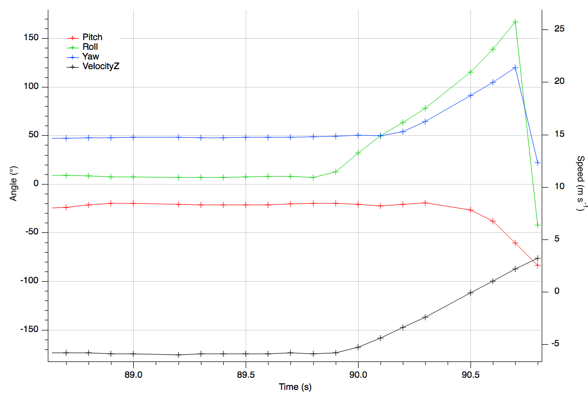

The flight data shows none of the usual indicators of something you might have done wrong .
The battery in particular was fully charged at launch time and still healthy at the end.
At 1:31.2 the trouble started. You just eased off on the sticks after going fast and up in Sport mode and it was all downhill from there.
The error messages suggest a genuine hardware malfunction and the case looks like one to take up with DJI.

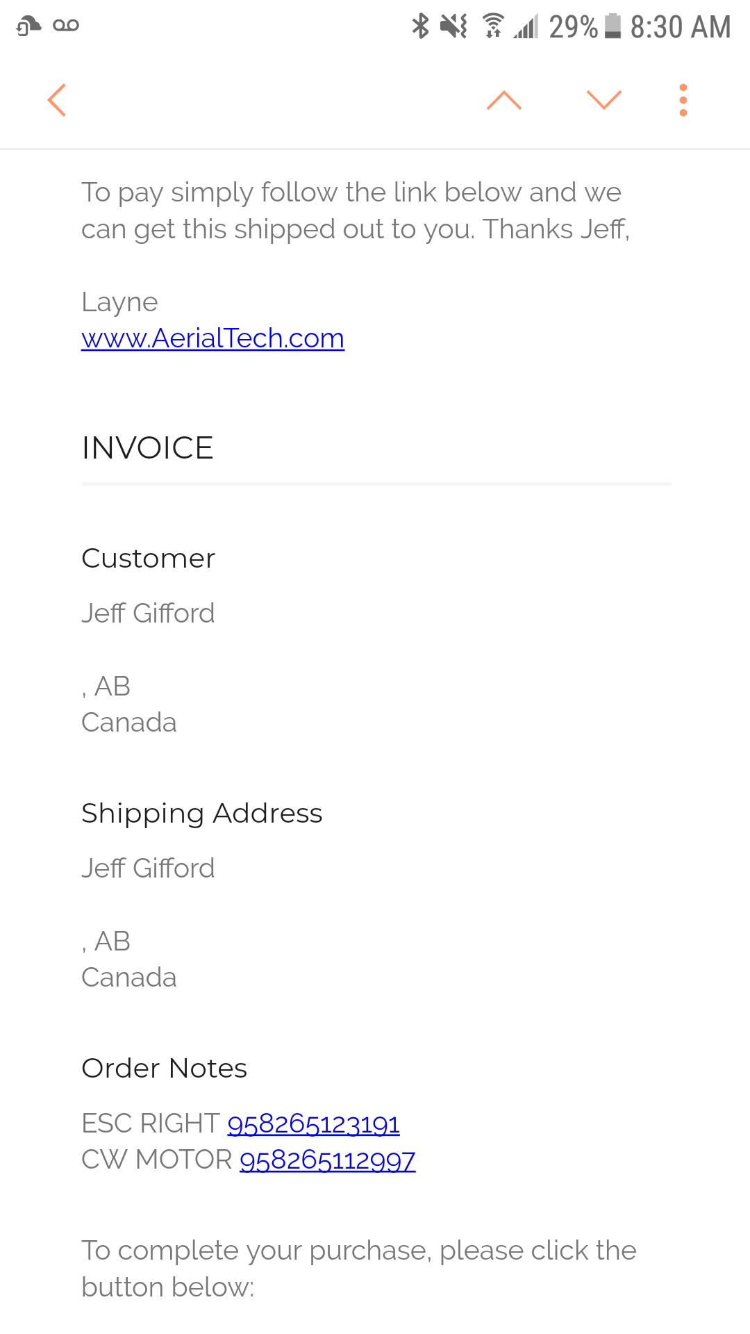

and the invoice indicates the right ESC was replaced
Maybe the ESC wasn't plugged in properly?

However, there was at least 0.6 seconds of right roll, past 90°, before any indication of a pitch change, which is hard to account for without simultaneous loss of lift from both right motors. And the CW yaw would be explained by continued left side propulsion.

If you can't power up the P4 then it won't be possible to retrieve the DAT file. However, as you probably saw from the discussion above, it's most likely the right ESC that disconnected or failed.
ok thank you very much for your help. I guess Ill ask my repair shop for a discount on a new drone if the replaced esc failed or wasn't connected properly. not sure if I should be opening it up or let them do it?
All props attached. Is there a way of uploading the dat files for you folks to look at? This drone has an interesting history and a rather lengthy story regarding dji warranty/support. Including the swap of a good battery for one that has the dreaded one bar blink. I sent the bird back to dji after two months of purchasing new, when it began to have esc errors. After djis keen support staff assessed it they determined that these errors were the result of a non flght impact. They said this was obvious due to the cracked upper and lower case and landing gear. This of course baffled me as I had sent the a perfect drone. Not a scratch on it with only 9hrs of flight. So i thought it must have been damaged in shipping and would deal with it when i got it back. So I had dji send it back without repairing it. Paid the postage. On return, would you believe it was exactly as I had sent it! Perfect, not a scratch on it with the exception of one of my brandnew batteries being swapped out for an old one that didn't work! I have all of this correspondence in emails. I have never been so pissed at a company.
I then took the drone to my local dji dealer who replaced an esc. This flight was the second since that repair.
