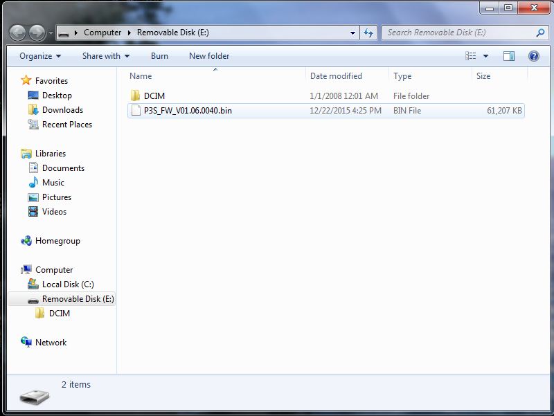

Please post the TXT file from your memory card.
Do the upgrade again and just let it set. It will eventually take. Some times up to 45 minutes I have heard. The beeps indicate a failure but just let it beep. If it's too bad stick it in a closet and close the door and just wait. Takes a while!
That is the one thing I forgot also to mention. No TXT log file showing the result of the upgrade gets written back to SD Card.
I let it run yesterday afternoon for almost two hours. Still nothing.
Try using a different memory card.
Maybe try downgrading to 1.4 and then going right to 1.6 if that works.
That's correct.
Then it is a balls up on DJI side. Look at the page and the link. You will see that I am on the right page and when I click on the ZIP icon, that is the version that downloads. You will see it at the bottom left corner of picture. Thanks for pointing it out. Do you maybe have a URL for P3A where I can download it?

Hello, Thank you for your advise. I try to downgrade to 1.4 but the filename starts also P3S. (P3S_FW_V01.04.0005). But this time it did not write a TXT file but two additional BIN were created. See attachment
You can ignore the "P3S" file name. It's the correct file. DJI does not excel at naming files.
